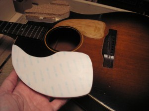

Hey guys,
I am making a caul for gluing down pickguards that have shrunk and curled up on older guitars.
I want to glue on some teflon material like the stuff Stew Mac uses to make small "dams" to keep
glue out of your fret slot. I need to know what kind of glue to use to glue this teflon to the
wooden pickguard shaped caul.I know CA and epoxy won't stick to it. Has anyone used this stuff for
a non-stick caul?? I hope there's some type of glue that will stick.

Hey thanks guys. I tried some of the 3m spray adhesive recommended by Dennis Leahy and it seems to have worked very well.
015 (300 x 224).jpg (14.54 KiB) Viewed 15373 times
