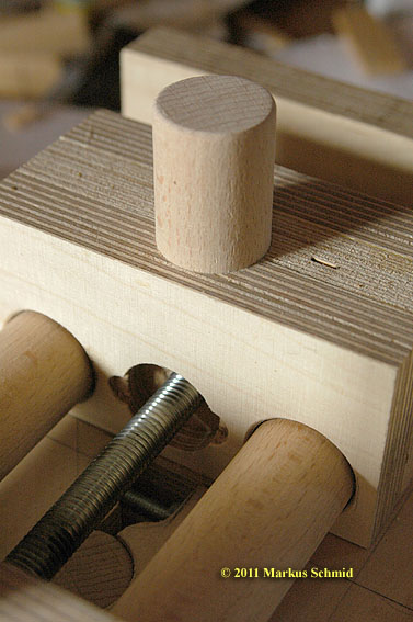

As requested here by Lillian I am posting some pictures of my shop made wooden swivel vice in ANZLF's Jigs&Fixtures section.
This is the ready to use vice:

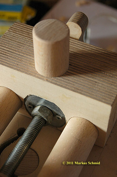

It's main components are 30 mm beech dowels and 30 mm holes, drilled with a forstner bit into 20 mm birch plywood.
Image Image
The clamping is done via a M12 threaded rod. The moving block has a M12 nut inlaid in it's middle 20mm plywood.

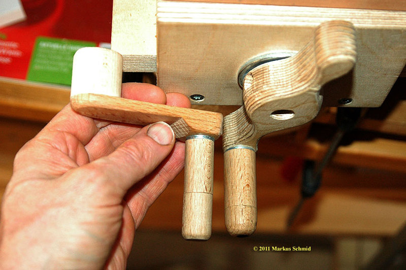

The most sophisticated part is the handle respectively it's guts. I have no photos of this but it's just about the same as in my stringwinder:
The guts of the handle:
Image Image
Image Image

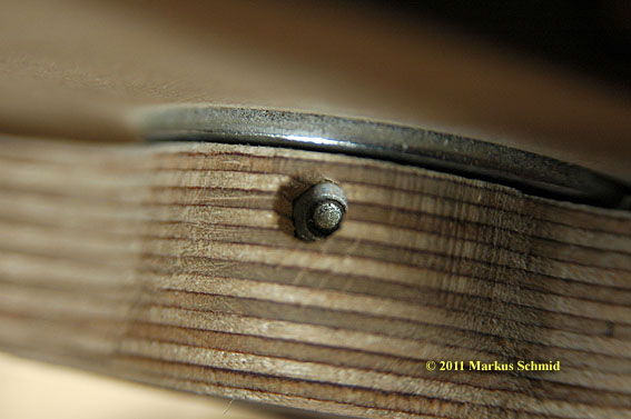

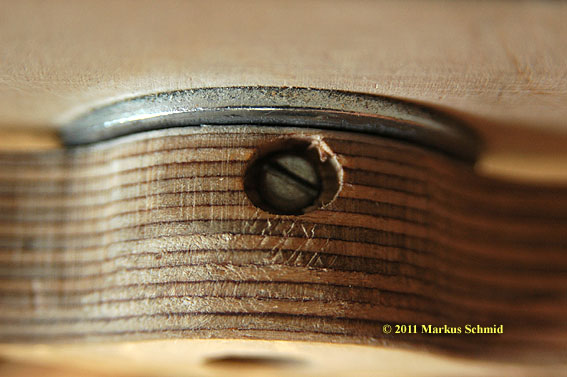

This is the rotating mechanism and how it gets blocked:
The vice works well and the clamping blocks do not tilt too much when clamping. But of course it is not as strong as it's commercially available cousins made of metal. The weakest point is the rotation blocking mechanism which allows a little bit of movement even when clamped firmly. But it's not really disturbing although it might break if I was going to hold branches and cut those to firewood.

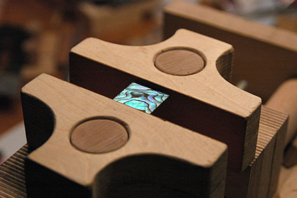

The "inlay" always goes between the vice jaws ;).
I still have planned to make some grooved jaws (one rather deep groove on each jaw) which would hold a finished neck without the need to apply clamping pressure like an ox.

charangohabsburg wrote:The "inlay" always goes between the vice jaws ;).
A-balone-y inlay:
A-balone-y inlay

I recognised there were still missing some details to describe.
I fixed the crank on the threaded rod by pressing a M12 nut into the crank.
Some years ago I found out that pressing nuts into (moderately hard) wood works best when boring a hole with the diameter of the width of the nut and the depth of it's thickness...
...then boring another concentric hole where the rod goes through, and finally simply pulling the nut in by tightening another nut or wing nut on the other side. This is a technique I use on nearly every shop made tool that features threaded rods and nuts.
Then I secured the crank with the inlaid nut with a M3 screw. Of course a simple splint pin would do the job as well. The M3 nut was pulled into the crank in the same before described manner. This is much more fun than only driving a nail through. :mrgreen:
The fat washer in the picture above is screwed with countersunk wood screws to the plywood, similar like the washer on the other side of the fixed ply wood block. The M12 nut on this side is soldered to the threaded rod:
The moving block accepts the soldered nut in order the vice can be closed completely:
I forgot to mention that the vertical 30mm diameter dowels are hammered into 30mm holes in the blocks. No glue needed, it's a tight fit.
I had to widen the two 30 mm holes in the moving block. I did this on each individual 20mm Plywood pieces before assembling them. It's the sloppiest part of the whole thing.
