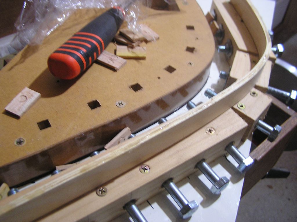

Post by woodrat » Sat Mar 17, 2012 3:36 pm
I thought that I would post this here to show how I laminate my primary falcates....I modified the jig from one that I did originally from Paul Lamberts description. He used bungee...I found that it crushed the edges of the wood....I know I should have used a sacrificial outer non glued laminate...but in the end I had some t nuts and some bolts and knocked up this. I planed the laminated this time instead of putting a sanded surface together so it will be interesting to see if they are stiffer. I spread techniglue on the laminates and weapped the gladwrap around them and did the clamps up...done!...I did not even have to hot bend them...but I dont expect that will be the case with the secondaries......

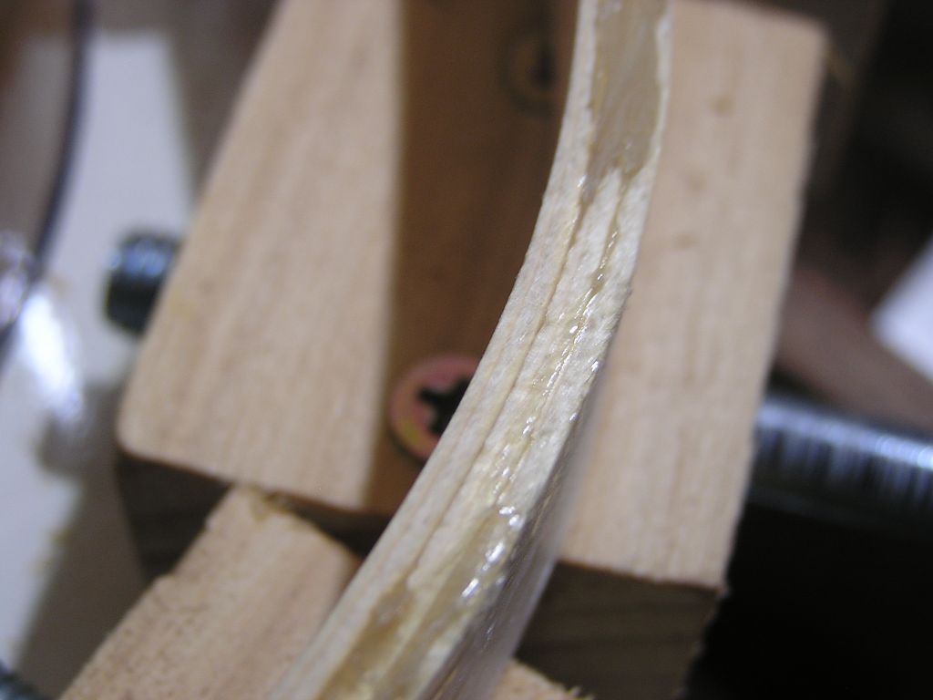

Re: Falcate Laminating Jig
Post by woodrat » Sat Mar 17, 2012 10:53 pm
Just pulled it out and the laminations are nice and tight....techniglue is great for this operation...now will clean up a side and rip it down the middle to produce two matching falcate braces....:)
So you could say "it worked!"...simple and effective methof to make falcate braces. It is the third method that I have tried by the way.... :wink:

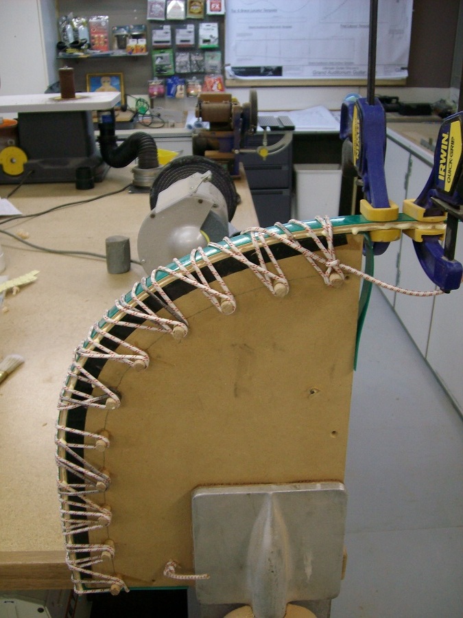

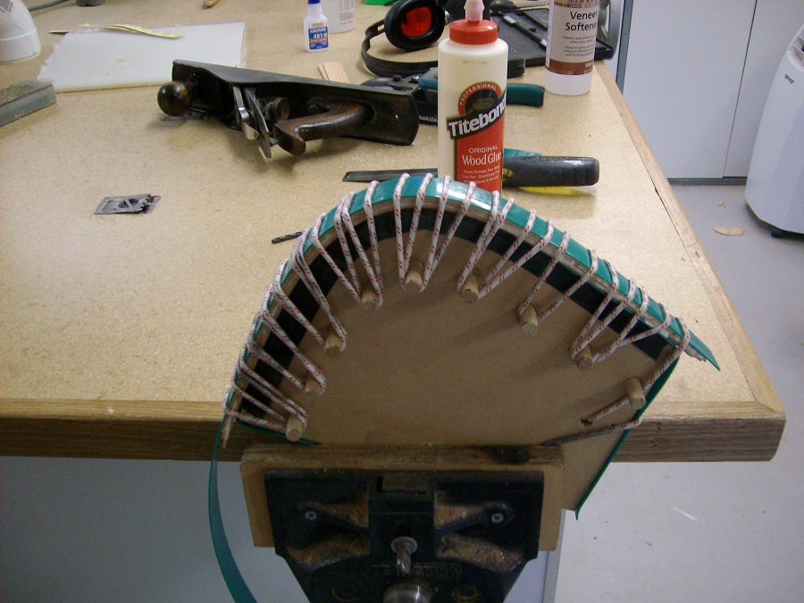

Here are some Pics of my quick and dirty Jig for those who are quick and dirty .
Makes mine look decidedly agricultural.

Post by woodrat » Sun Mar 18, 2012 11:00 pm
Paul, That looks like that wide tough blue plastic strapping on your jig (?) ...that looks like it would protect it well from the bungee. I should have done that the first time....but I went on to make the screw pressure one which works a treat....

I did mine like Paul's.
I did however just use cheap garden twine rather than bungee cord because I was using epoxy and I figured the squeezout would ruin the expensive bungee first go.
Worked fine.

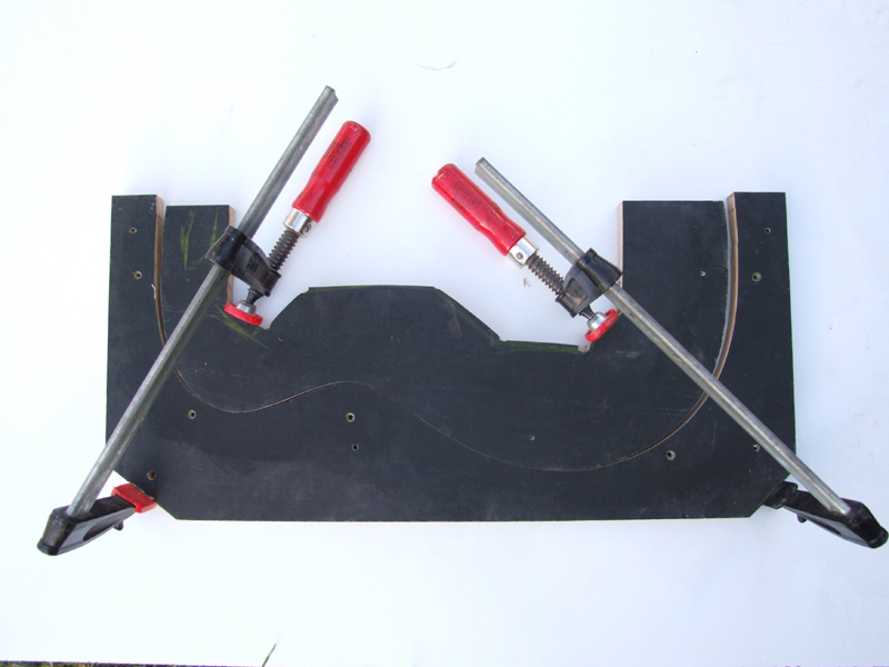

Hi All,
I just thought I would add a photo of the jig I made to glue up my solid linings. I use a two part mould with a positive and negative and clamp the linings between them, its very easy and quick (after you make the jig). I added flat sections so it is easy to get clamps all around it. I used my construction mould to copy (by routing) the outside shape. I used my bracing template for the inner follow by a rebate router bit to get my 6mm offset inwards. This two part jig can be applied to laminating Falcate Bracing.
Post by Kamusur » Tue Mar 20, 2012 9:05 pm
Hey Luke that cant be right you are only using 2 clamps what gives?
Post by Allen » Wed Mar 21, 2012 6:22 am
That type of mould will work for waisted glue ups. In fact it's the type I use for my laminated solid linings. But try as I and Micheal might, you have a hell of a time getting something without a waist to pull up tight. No matter what we've done when using the plug for clamping, we get 100 % failure in what you would call the waist area (for lack of a better term). The waist shape in a congenital instrument helps get that clamping pressure to the middle of the layup.

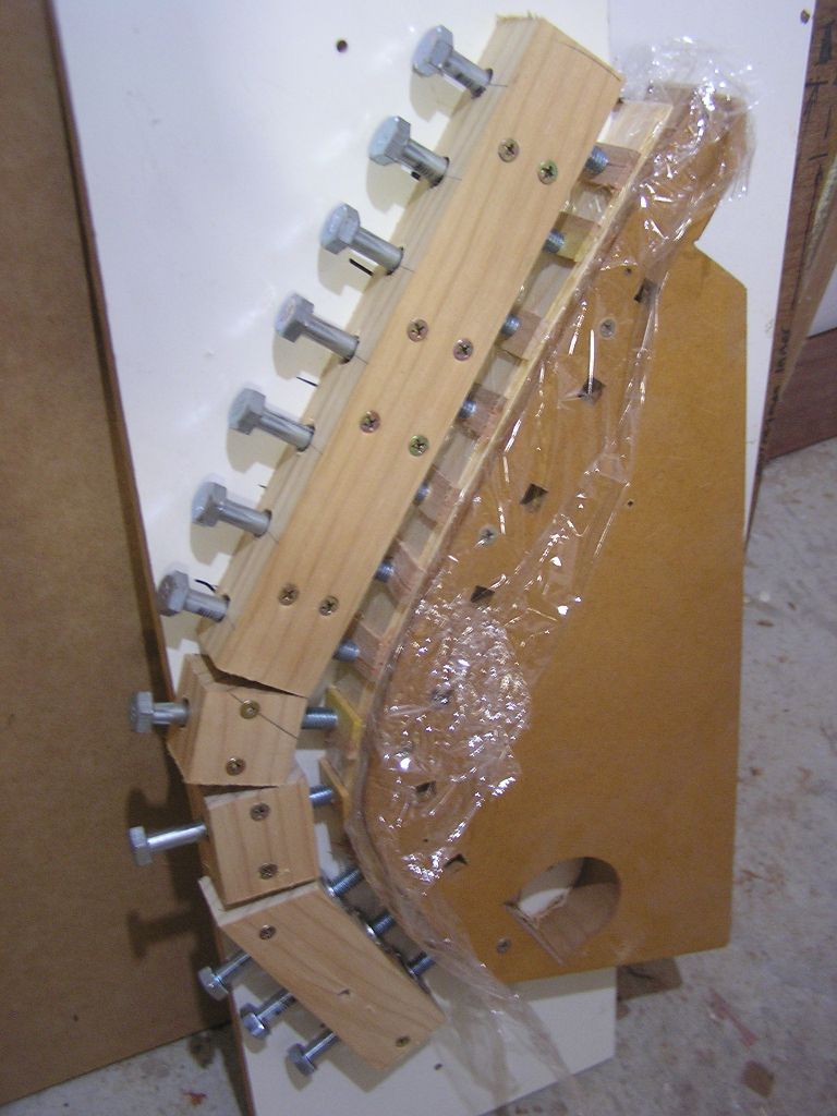

Post by woodrat » Wed Mar 21, 2012 6:46 am
Thanks Allen, I have made a jig for the secondaries too (will post pic soon) and the glue lams that come out of them are excellent so I am glad that I have made them this way. T nuts are great devices for jig making.
