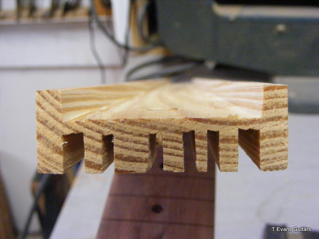

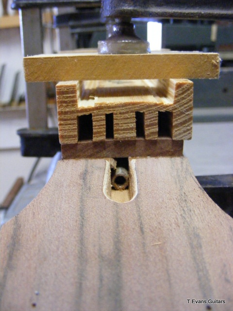

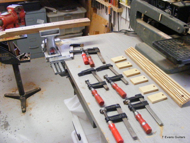

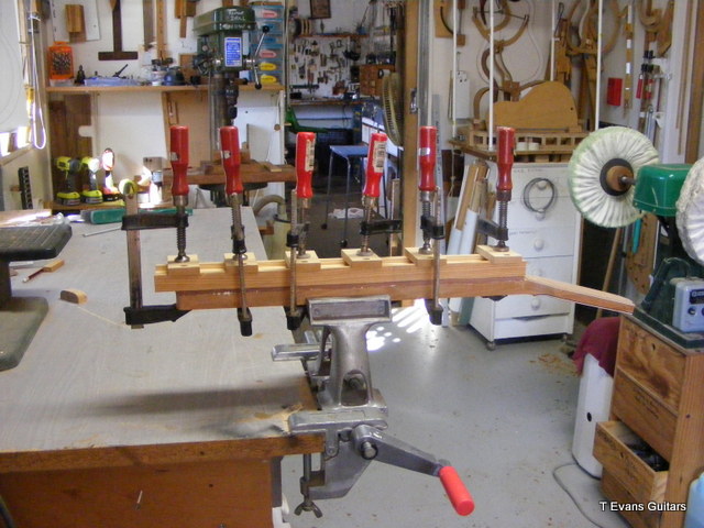

Hi all, this is the fingerboard to neck gluing aid I have been using for many years, thought I’d show it.
The pics will tell the story. I find it puts even pressure/contact across the width of the fingerboard when gluing up. Works fine for me.

Cunning bugger Taffy, as with all your jigs e.t.c it's amazingly simple but damn effective, nice tip :cl Could have been a nice bit of figured Sapele or something though :P
