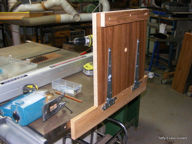

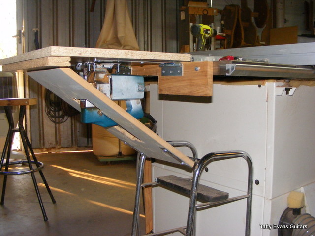

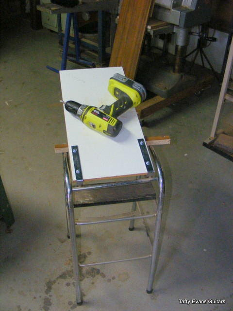

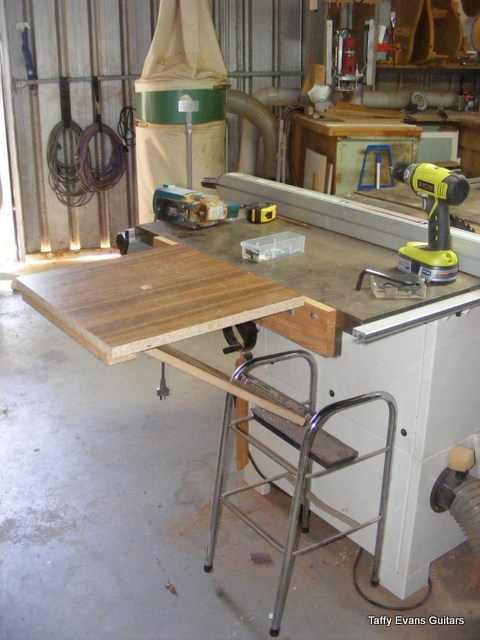

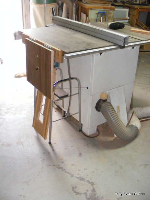

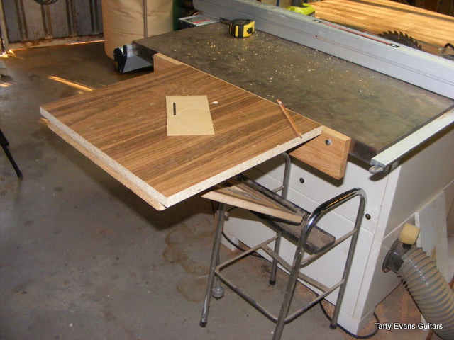

I did not think there would be any more room for more machines in my workshop but a sit down with a beer got the problem solved.
I have just ordered a new 12" disc sander from Carbatec and when it arrives I've got a spot for it, but a I wanted a table jig saw as well. I have had the Makita jigsaw shown for about 30+ years [it just will not die] and when it's switched on the power tries to break your wrist and I need ear muffs on too. So it's best bolted up under a table.
I had just got back from pricing a dedicated jigsaw table set up, and at $300 I thought it cheaper to have a beer and think this through.
The pics show the story, recycled materials of course, it aint pretty, it aint original but it is space saving and rock steady when set up.
I can still use the stepping stool too if needed.
When the table is lifted up completely vertical its easy to change blades. It's used mainly for odd jobs, cutting templates, jigs and moulds.

Works for me anyway.

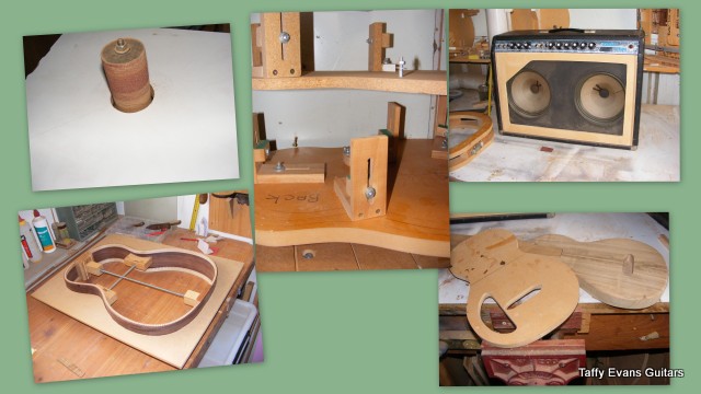

Hi Martin T, I have a 16" bandsaw but some jobs cant be got at by sawing in from the outside of the piece, hence the jigsaw. Instrument repairs often need special jigs and aids to get the job done and often changing the bandsaw blade just for a small cut, due to, too a tight radius adds too much time to the job. And I'm happier moving the work than moving the machine so a table is my answer.
I have some pics below of some of the type of jobs I might use this jigsaw table for.

And having now seen all those examples I now need a jigsaw table! hmmm, where can I put one...
