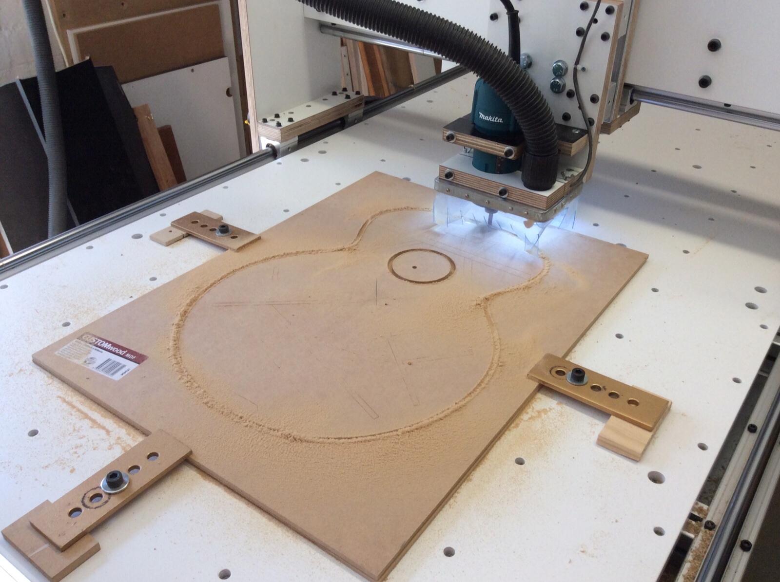

My dad made a cnc machine at the start of the year, the first project was the template. I used a vee cutter to make out the bracing pattern. It was also used to route the main assembly mould and bender sides.

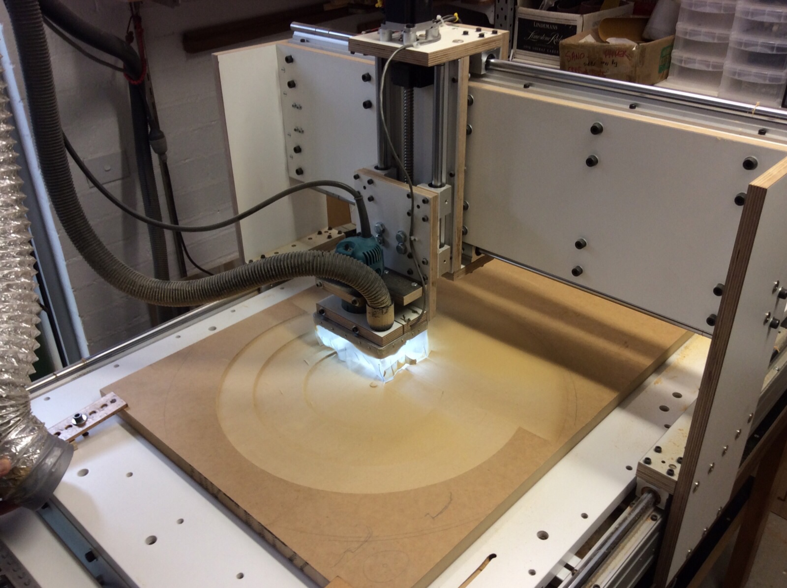

On dad's cnc machine I made a new back and top radius dish. The rough cut is done and half the finishing cut.

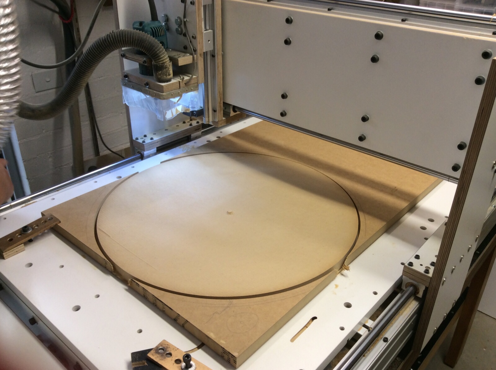

Back radius mould finished.

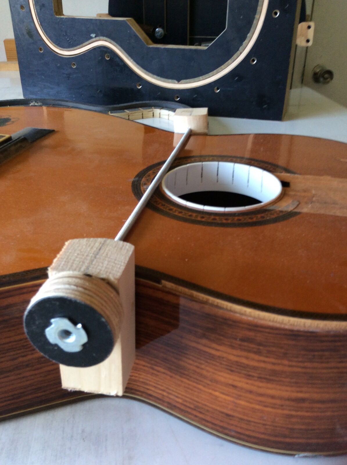

Side spreader lined in foam. It applies pressure to most of the guitar outline.

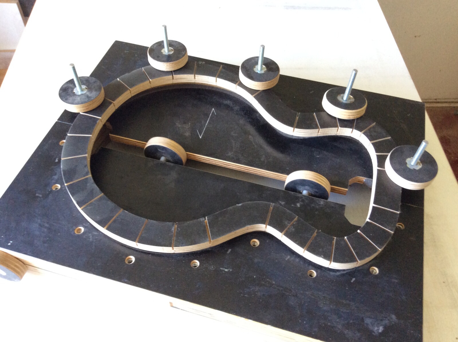

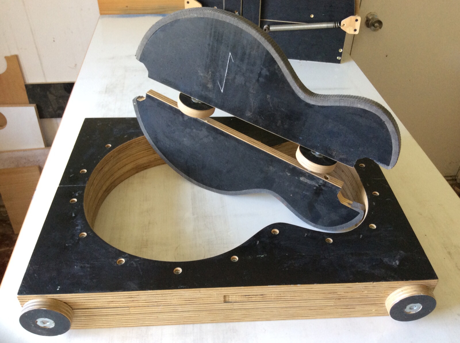

Main body assembly mould. I added t-nuts the the face layer of the mould. I then use threaded rod the and a t-nut disc to clamp up the plates with the addition of a glue-up rim
Main body assembly mould with top and back plate glue-up rim. The rim has a strip of foam which aligns with the linings. I put radial saw cuts through the ply to allow the rim to bend to the back contour.

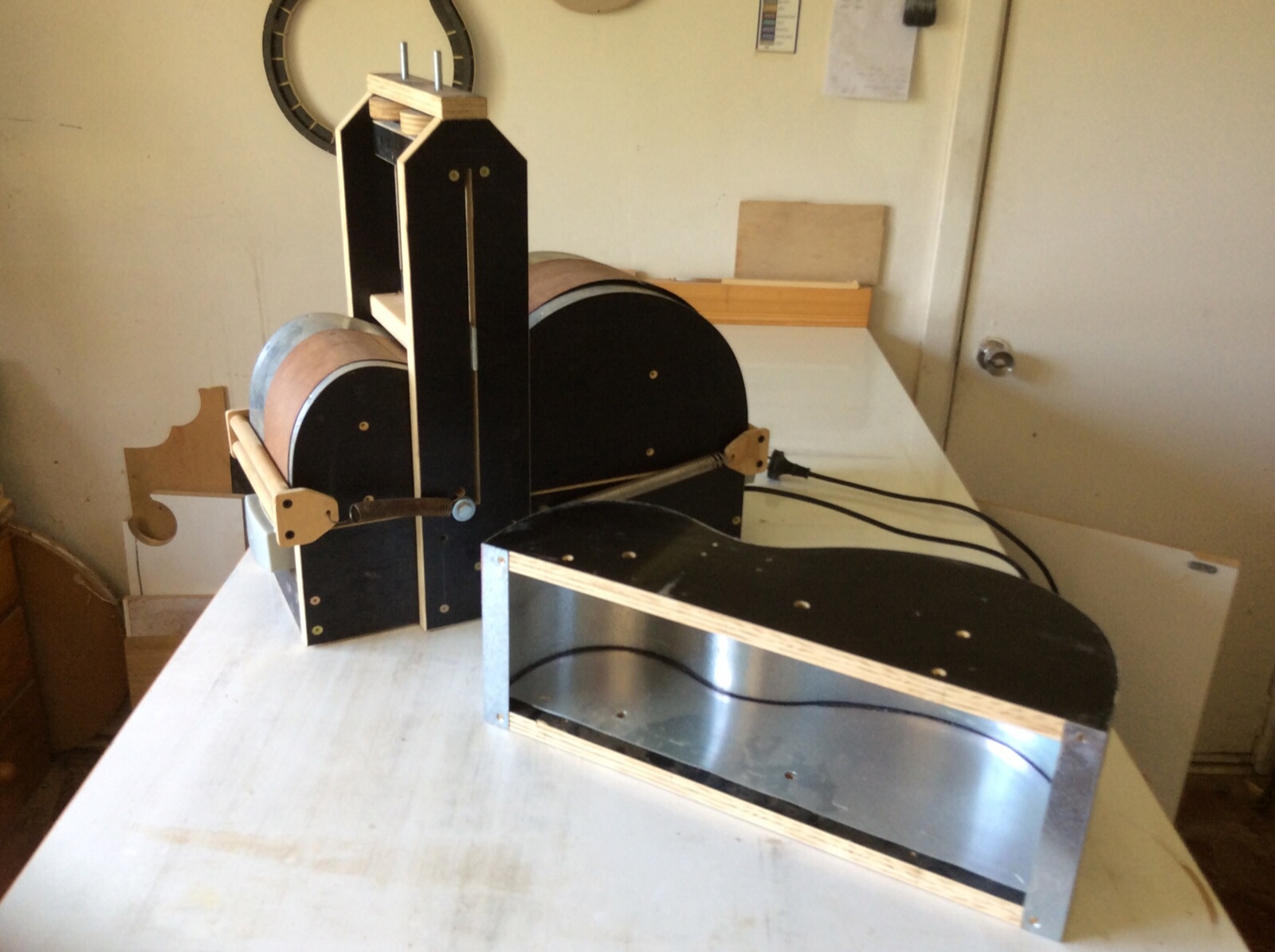

Side bender with interchange moulds. For the moulds I just glue the sheet metal to the ply side, line the inside with thin aluminium sheet. I then put screws through the face into the ply sides so it holds together when heated.
I use a bar heater to heat up my side bender. It was only $15 so cheaper than a light box setup and more appropriate for heating things.

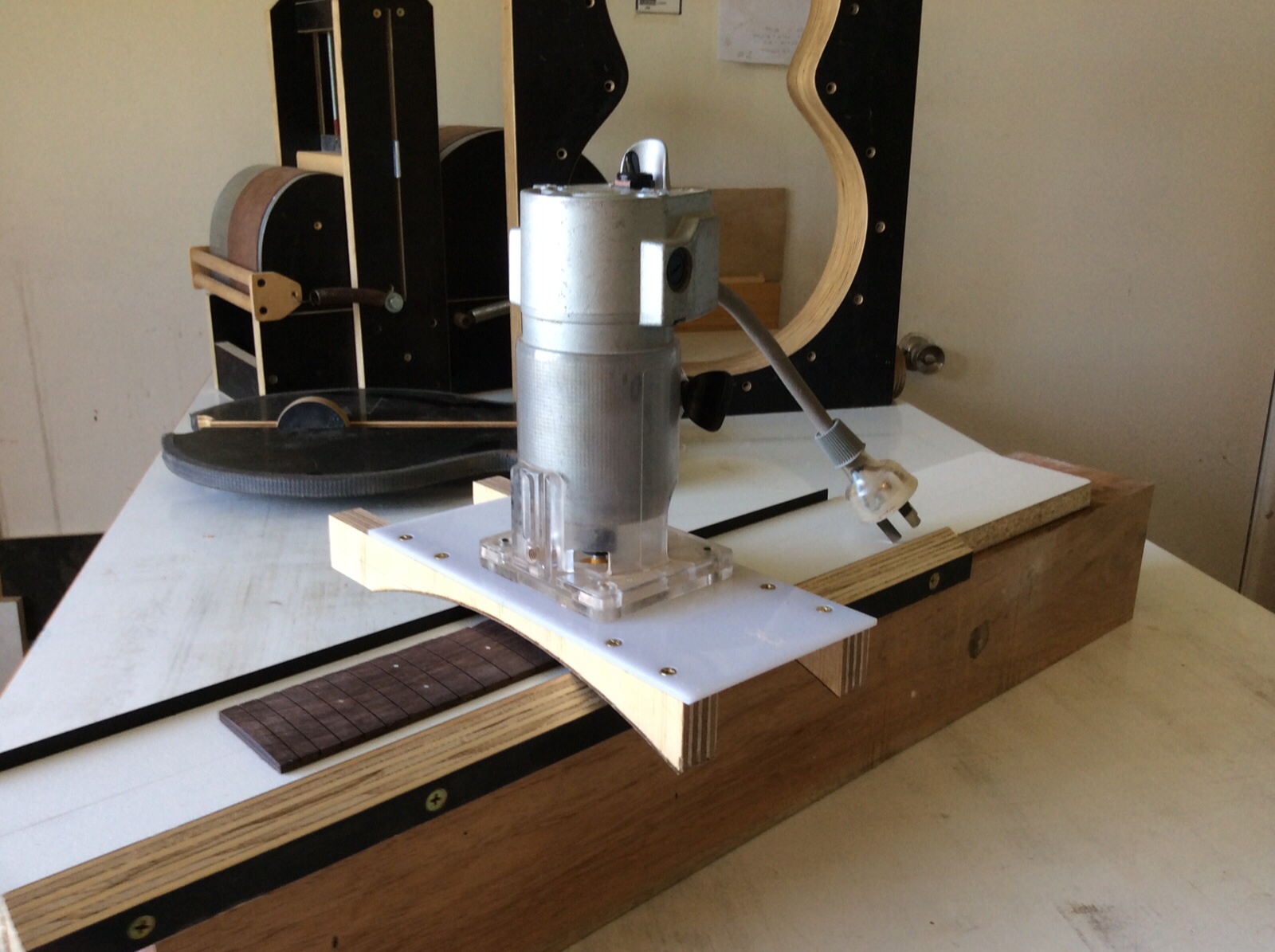

This is to do the radius on the finger board. I make a new router base for the radius I need. This is a 300mm radius for ukuleles. It slide along the plywood guides.

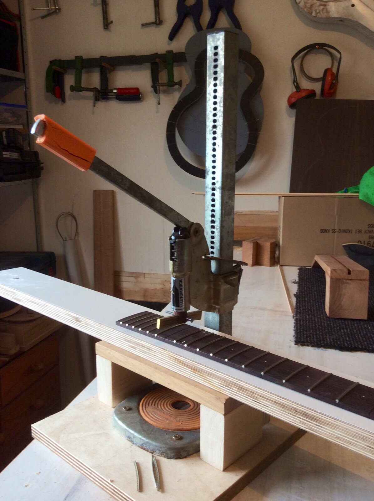

I use this as a fret press. Shaped a block of brass to match the required radius, it is also handy for bottling beer.
