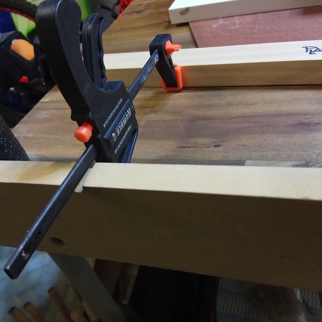

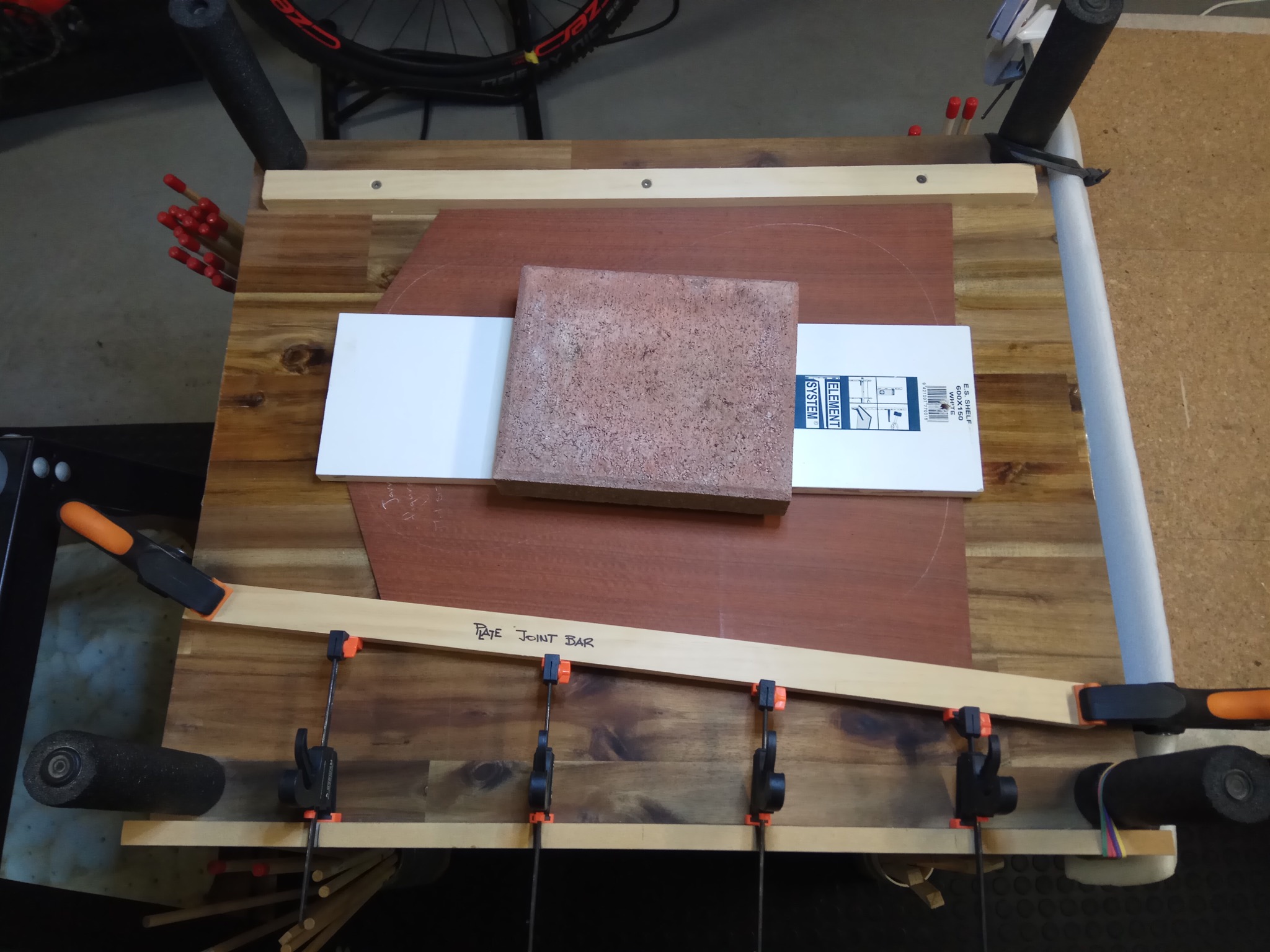

hi All, if you are using a go-bar deck, here a simple solution for joining top & back:
I do not have much space so my deck is at floor level and I am using the top of the deck to join plates, then when done it becomes a usable work surface.

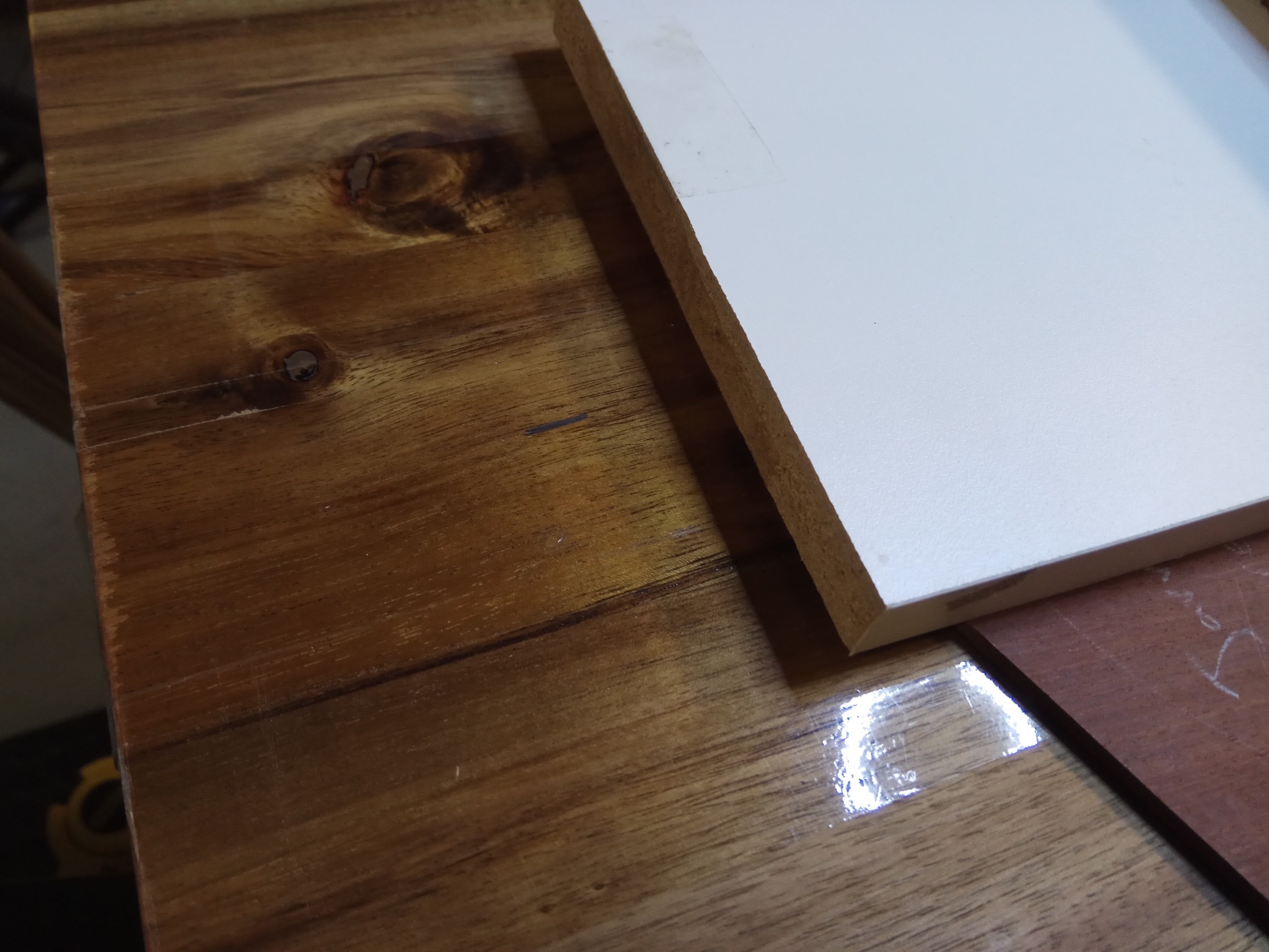

4 small notches to guide the clamps and some clear tape to avoid gluing the plates to the deck surface.
