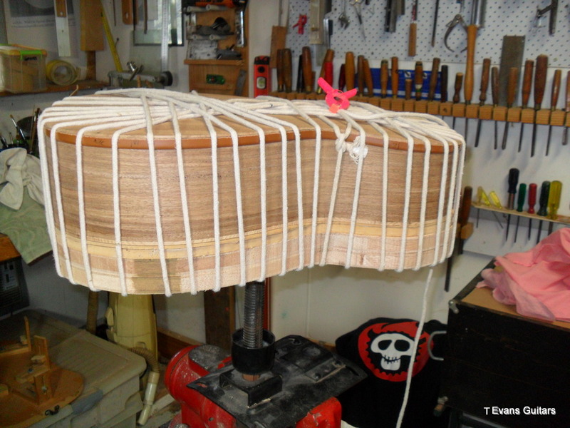

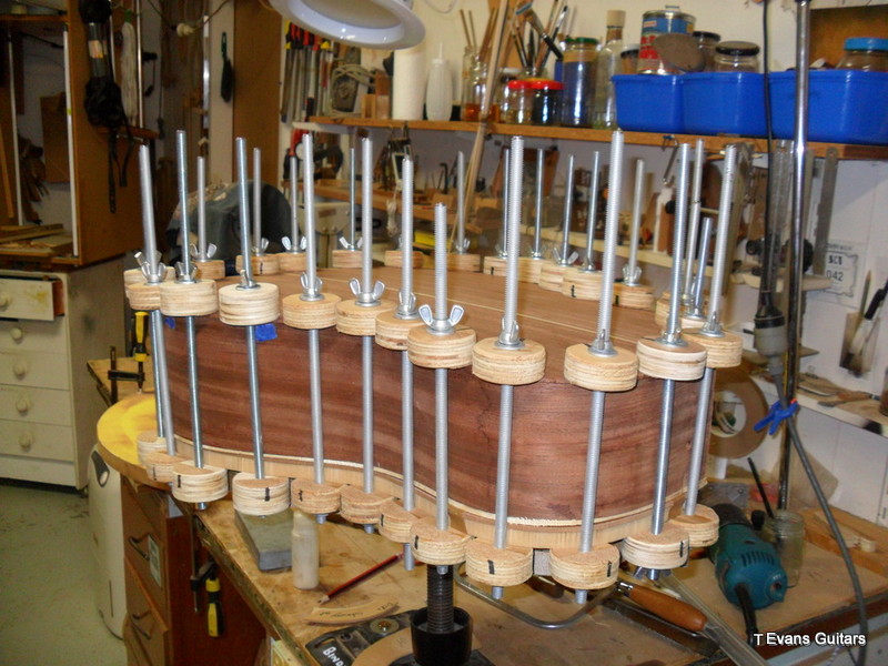

I find this unit very helpful when doing jobs that require me to work all around a guitar, such as in installing binding, purfling, and also fitting tops and backs. I can just sit [rarely] or stand in the same
spot. And in my cramped workshop that’s a bonus.
1 (2).JPG (152.38 KiB) Viewed 30269 times

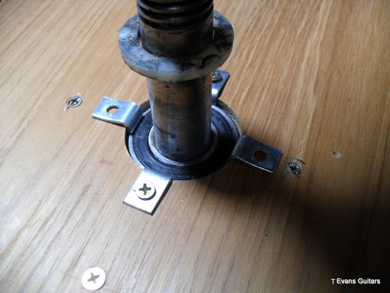

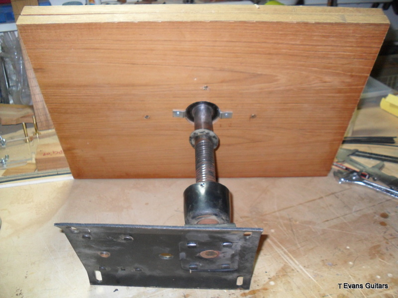

As you may notice the metal parts were salvaged from an office swivel chair…
It can be mounted on my island vice, or clamped to a bench top…
The only thing I had to supply was a bearing [from the front wheel of my trials bike…

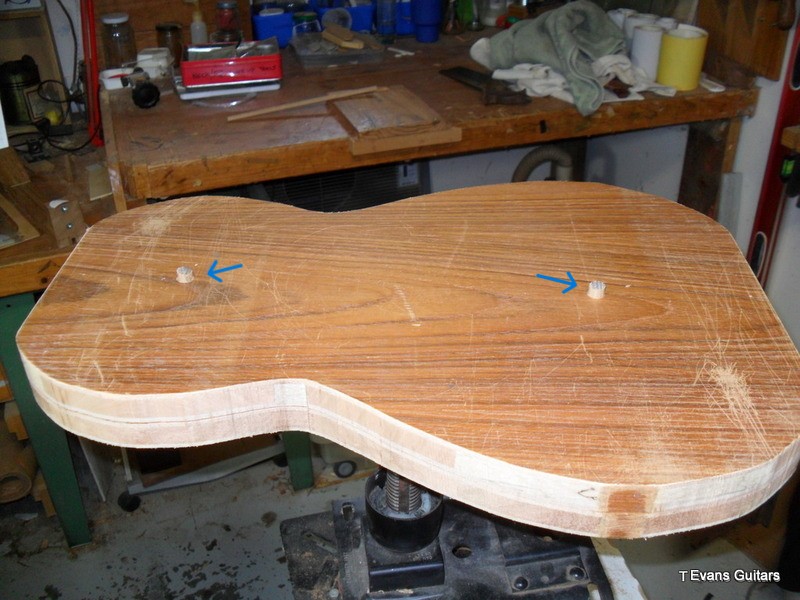

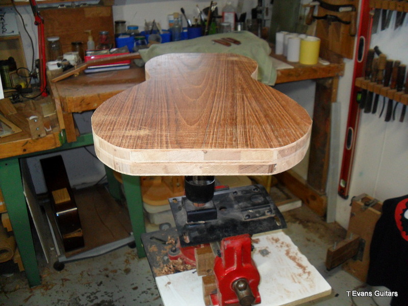

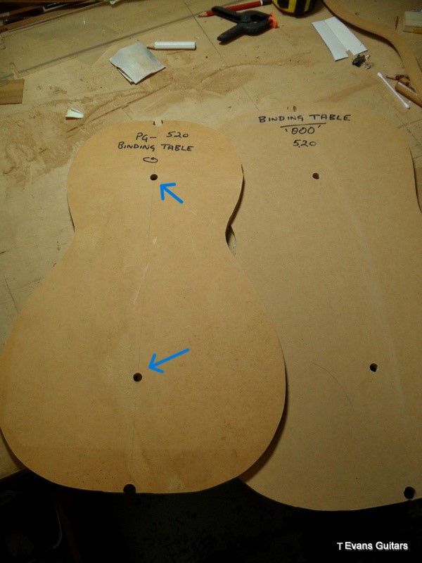

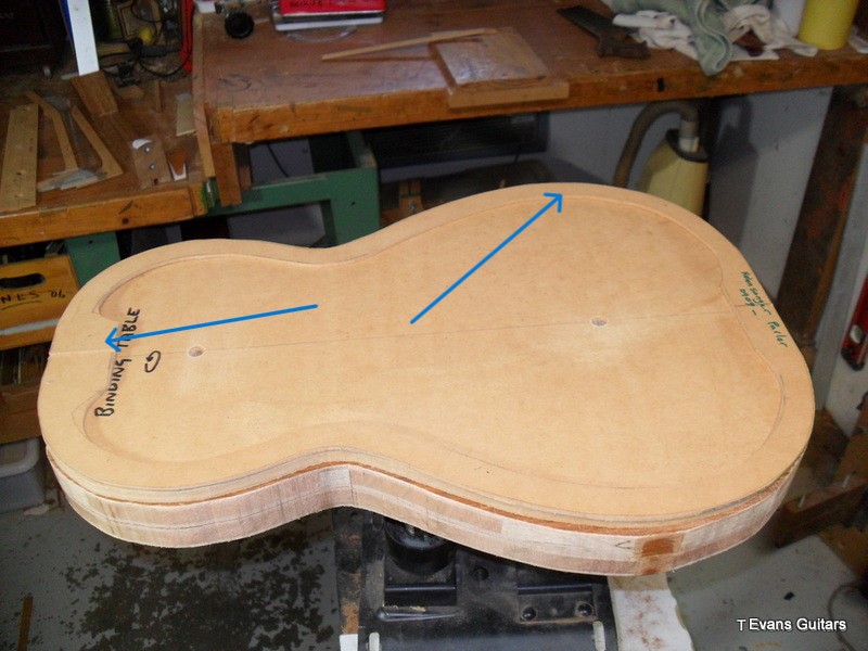

I have different tabletops that match the size of the guitar I’m working on, which are then located on the pins in the base table…
I also place different risers on the table's perimeter this allows for the radius of the top or back, and allows the guitar to sit flat on the table…
I can use tape, rope, or clamps and just spin the whole assembly around as required…
It works for me.

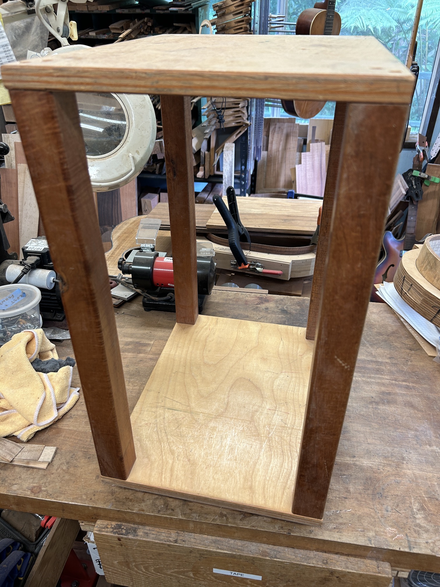

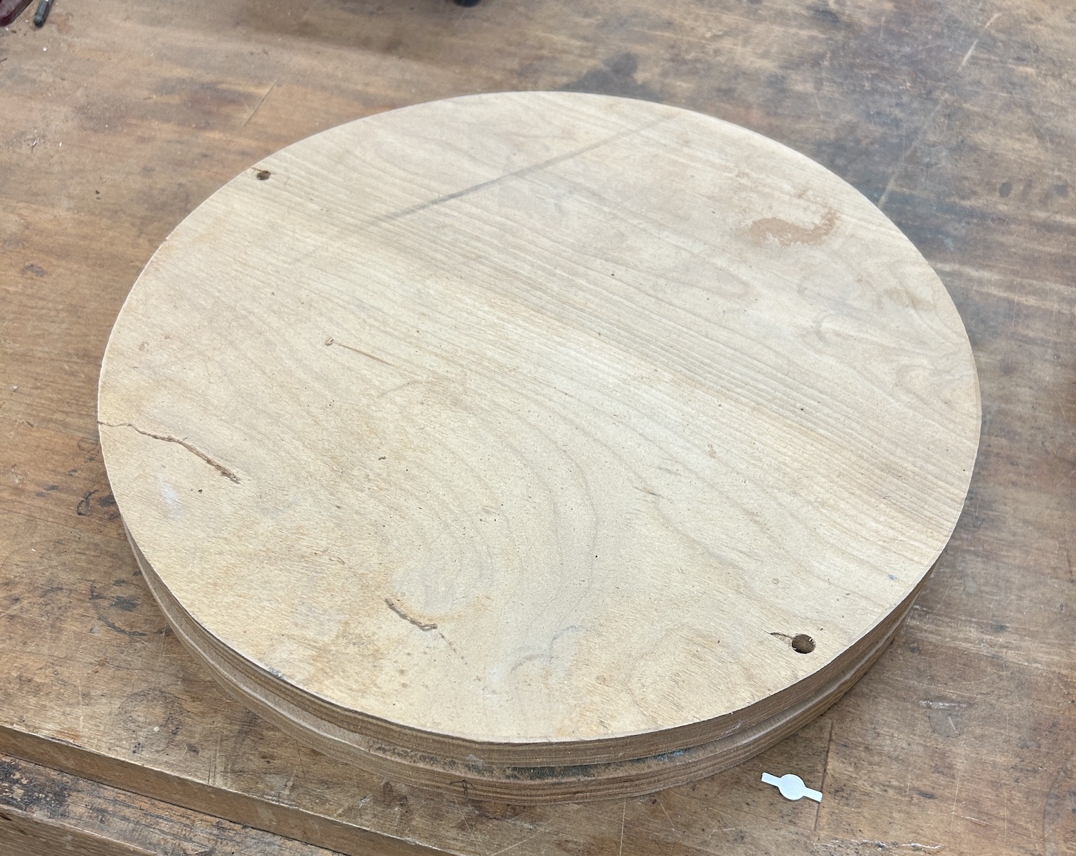

I use lazy Susans too, but not being as tricky as Taffy, I just buy a $20 lazy Susan bearing at a hardware store or on Amazon. I have a few and use the 12" size. Takes maybe half an hour to make a useable unit out of a couple of pieces of plywood. My main use is to hold go-bar decks for easy glue clean-up. Useful in the dining room too!
