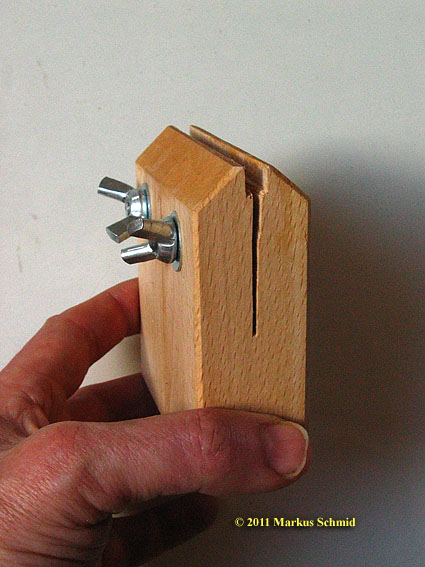

Without having seen this thread, (also!) about two years ago I made something very similar (inspired by the nut & saddle vise available from Stewmac), but with the clamp already incorporated so I can take it to the belt sander or also clamp it in the normal vise.
