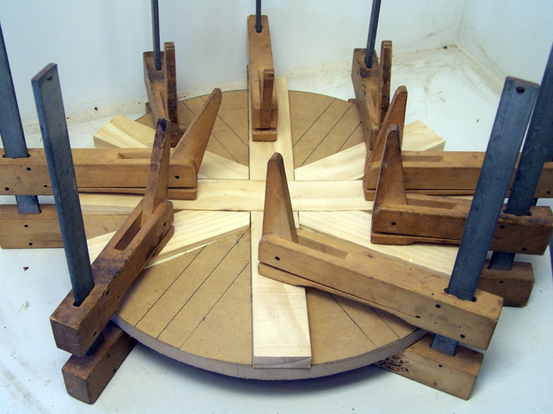

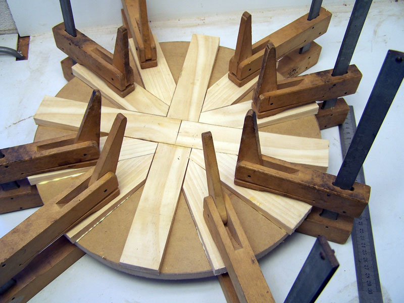

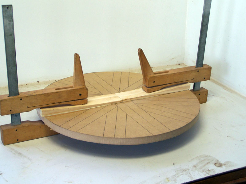

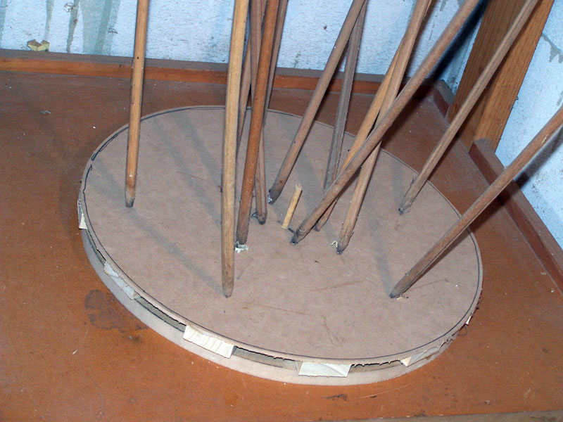

As most of this seemed to disappear in the Great Server Crash of '10. Here it is as it is (more or less) in my mandolin book. Remember this is for something the size of a mandolin or ukulele, so just make it bigger for a guitar. For whatever reason, the pics don't want to load in order, but I have added a note on each one for those who can't work it out
The credit for this should go to John Calkin, who published it in American Lutherie a few years back.
Radiused dished workboards
These are available commercially in a number of different radii, usually designed for guitar building use, but it is a simple and cheap device to build. A 15’ radius is suggested for both the front and back of a mandolin, but a tighter, 12’, radius could also be used (or a 24' radius for a guitar). Materials needed are two pieces of MDF or plywood 500mm (18”) square, one 18mm (3/4”) thick and the other 3mm (/8”) thick as well as twelve pieces of dressed 2x1” pine that are around 215mm (8.5”) long. For a guitar you would want the MDF 600mm/2' square and longer bits of 2x1.
Drill a 1/4” hole in the middle of both pieces of the MDF/ply and cut a 450mm (17”) diameter circle. A piece of wood with a 1/4” hole at one end and another 225mm (8.5”) away to take a pencil makes a simple compass. Using the 15’ radius pattern in the plans at the back of the book, cut curved strips from the lengths of 2x1 pine. The pieces should end up 5mm (3/16”) thick at one end and 10mm (3/8”) thick at the other. Glue the first two so they butt together in the middle, and add the others shortening them as required, as pictured below.
Once all are in place sand any unevenness out and glue on the piece of 3mm MDF/ply, using a short length of 6mm or 1/4” dowel to line them up. The best way to apply pressure is with go-bars in a go-bar cabinet. This is simply a rigid structure with a floor and ceiling and lengths of dowel the same length as the distance between floor and ceiling. Suppliers offer wood or fibreglass bars 24” in length, though longer ones are not a problem. Mine are 42’ in length and made from 10mm (3/8”) dowel.

- Third picture
- dish5.jpg (102.53 KiB) Viewed 61162 times
- The first pic
- dish1.jpg (65.4 KiB) Viewed 61162 times
- The second pic
- dish3.jpg (88.41 KiB) Viewed 61162 times
Graham McDonald
Re: Radiused Dishes
Thanks for taking the time to put this tutorial back together Graham, its pretty obvious quite a few people have found it helpful in the past and now are sure to in the future as well.

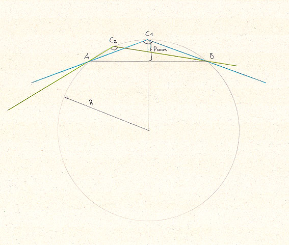

I don't know if "how to draw part of a circle with a great radius" a has yet been discussed on this forum. Those who don't have the book's templates or want a different radius might find interesting the (for me) easiest way to draw such circle lines. When I was going to make my first solera I was told that I could make a compass with a pencil and a loooong thread or wire. Although I had my difficulties to believe this would work well I gave it a try. Now I know how much different threads and wires stretch under even low tension... and I ended up drawing the line by calculating the coordinates of some of it's pointsGraham McDonald wrote: [...] Using the 15’ radius pattern in the plans at the back of the book, cut curved strips from the lengths of 2x1 pine. [...]
Later I found this description and drawing on Jon Sevy's website:
I need to draw such circle lines so seldom that I make these compasses (two so far) out of 30 mm wide cardboard strips and throw them away after having used them.
EDIT:
I nearly forgot to present the math...
R = radius of the dish's curvature
D = "diameter" of the radius dish
Pmax = maximum depth (the letter "P" stands for the spanish word "profundidad" - I'm too lazy to draw the whole thing again with "letters in English" ...

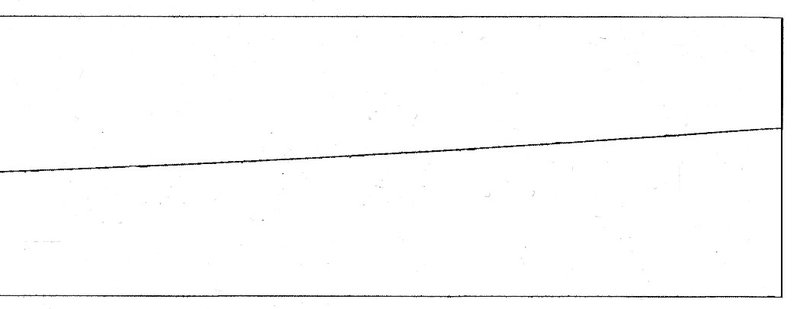

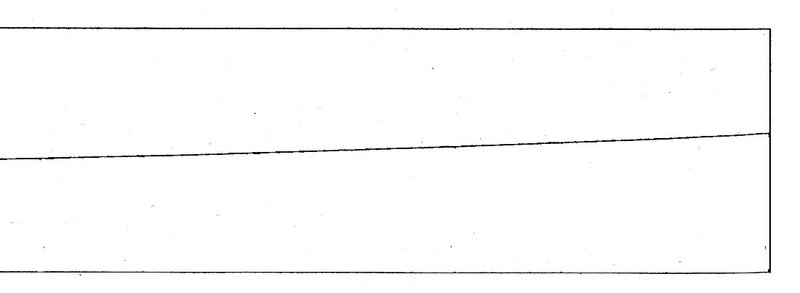

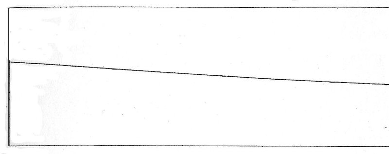

Re: Radiused Dishes

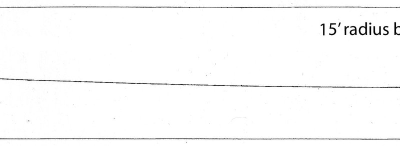

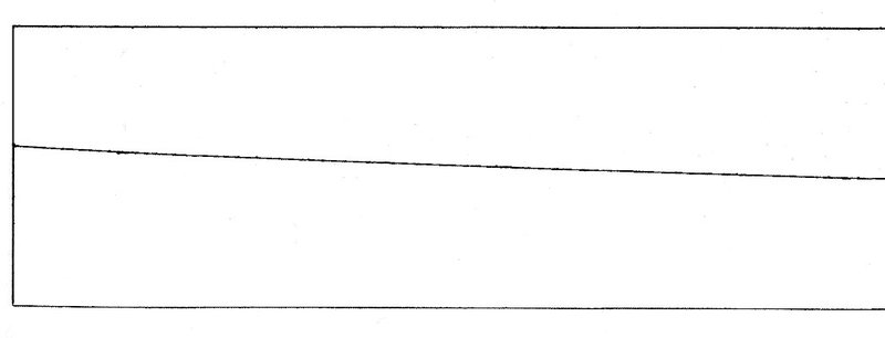

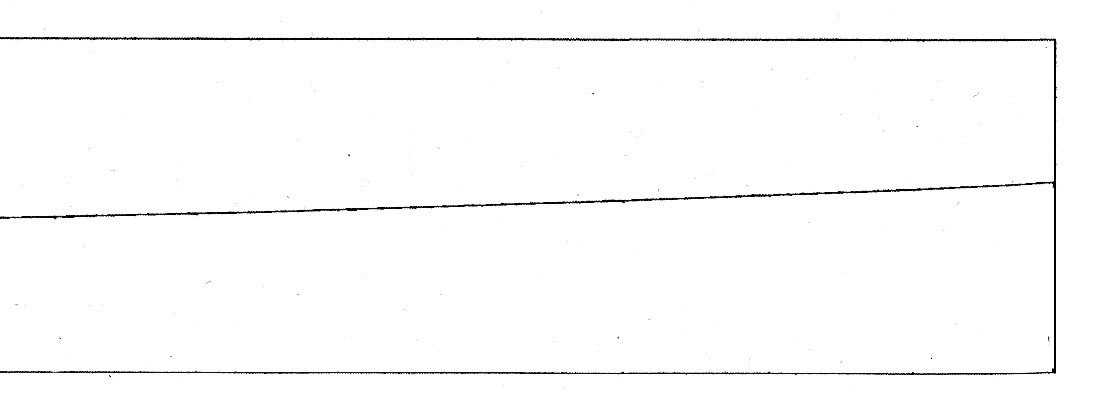

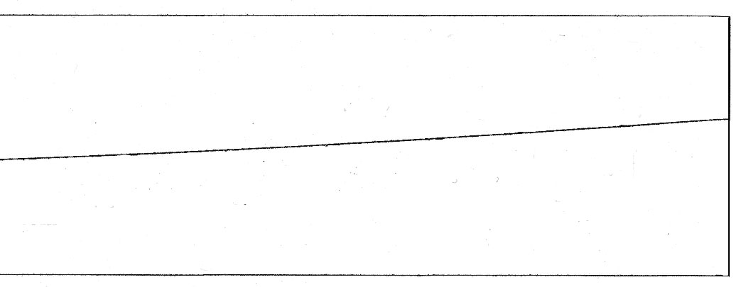

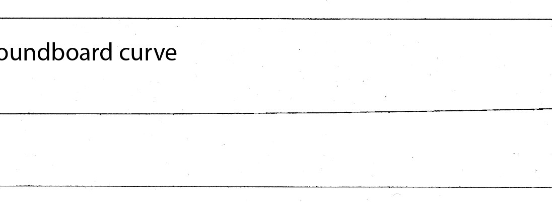

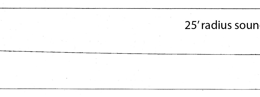

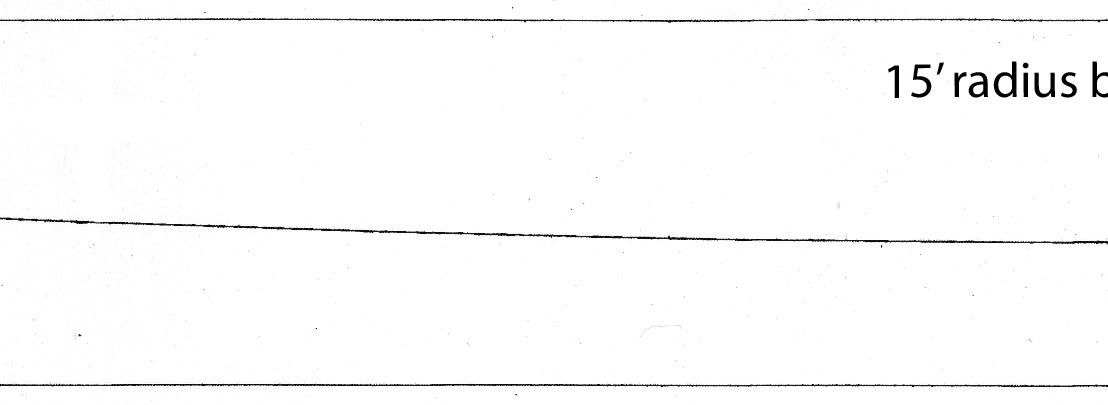

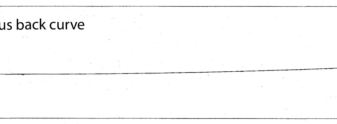

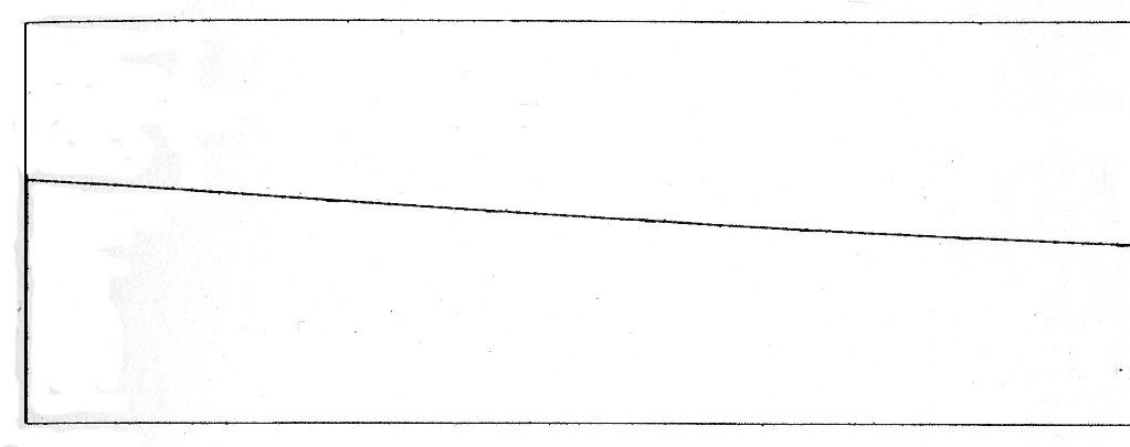

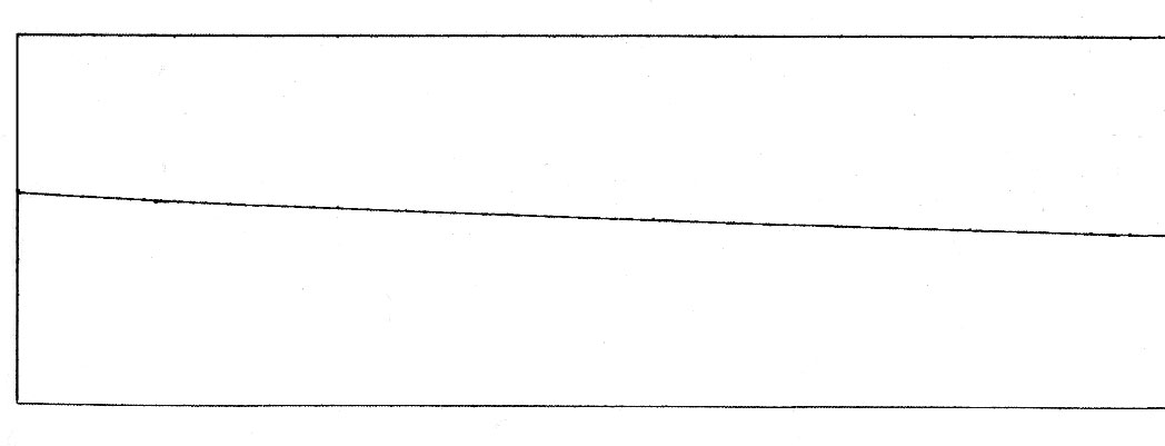

Thank you Markus, I had forgotten about the actual curves. I have 15" and 25" radius curves as jpgs, but the images are over 4000 pixels long, so I will have chopped them up into four sections as the site limit is 1200 pixels. They are numbered 1-4 and there are vertical line which can be used to reassemble the whole curve. There is some doubt about what radii curves these actually are. Someone emailed me a couple of months ago complaining that he had done the maths and these were not 15' and 25' radius curves. Perhaps they are not, and if someone wants to do the maths and let me know, that would be great. ALternatively they work quite well as they are and lots of people have used them since the Bouzouki Book was published 7 years ago
There should be eight images below.
