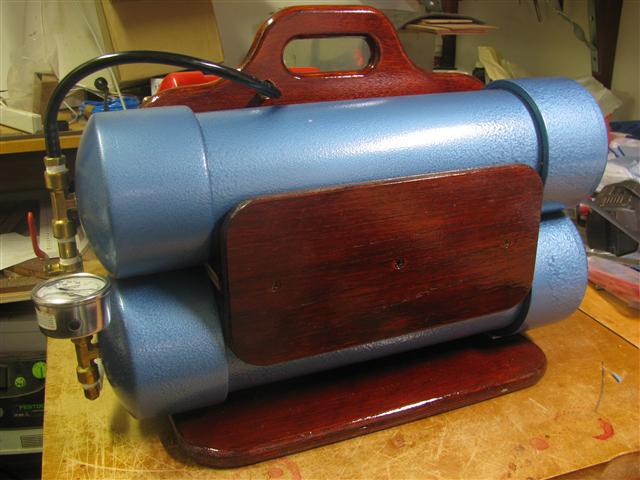

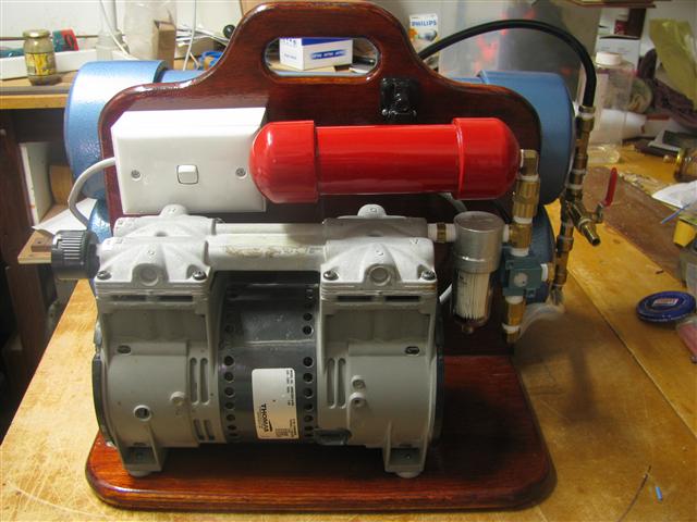

Hi Everyone, I thought that I would share a few pics of my latest bit of kit. It is an electronically controlled vacuum system that consists of a second hand Gast twin cylinder laboratory pump and some special components that can be bought through Veneersupplies.com that when cobbled together in the best Heath Robinson style gives you a very nice vacuum generator that will provide the required vacuum for any holding or veneering applications that you may have. My system is set to give 18inches of Hg (according to the supplied gauge) vacuum. My pump would only pull 19inches (again according to the supplied gauge) so I set it slightly less than that. I have used as vacuum reservoirs 400mm long 150mm diameter Vinidex pipe with a wall thickness of 4.5mm as this was the heaviest available to me but I put in an internal column in the cylinders to support the endcaps and that seems to be adequate at the moment. I know that there are a number of members that either have Vacuum holding systems or are in the process of building/acquiring ones so maybe we will see lots of good ideas involving vacuum here on the forum. Dom has already posted a great vac holding device for routing endgrafts so keep them coming. Thanks for looking.

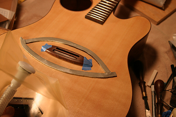

Looks good Woodrat. Nice compact design. Did you look through all the pics of various systems people have built on the Veneer supplies web site? I got some good ideas for my system from them. I used old gas bottles for the reservoirs.
These things are so handy and having the electronic cut off and reservoir makes them more friendly to use. My system has zero leaks so I can leave it on all the time. In fact, I did not put a on/off mark on the switch and I have open a valve to see if it is on or off.
Last week I made 8 x 600mm disks of 16mm mdf laminated onto 21mm ply (glued up in vac bag) ready to make various sized radius dishes in the jig I posted for use in a brace clamping jig.
I am betting we will see heaps of cool vac ideas coming over the next year as others get set up and start thinking about uses.

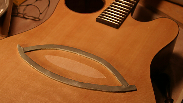

Vac things I have been thinking about.
Brace clamping jig
Head plate and rear head plate press
Fretboard gluing press
Side laminating press
Holding jig for fretboard while doing radiusing etc
Fretboard binding clamp
Also many uses for clamping instead of toggle clamps for machining parts etc.

Those systems look great. I'm looking forward to getting mine up and running. And seeing some innovative ideas on it's uses.

Thanks Dom, Yes I took my lead from the EVS system that Joe Woodworker designed but went for slightly bigger buffers because I could get 150mm pipe at the local Reece Plumbing store. I would like to know how accurate the gauge is though. I think that I have adequate vacuum as Robbie O'Brien said on his video that 15-25 in Hg should be adequate for most lutherie applications. Mine will pull 18 or 19 on the gauge...

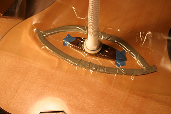

Micheal Connor and I were just chatting on the telephone a few minutes ago and were discussing if you could use hide glue with a vacuum press. Joe Woodworkers site says no to hide glue and vacuum veneering, but what about gluing on bridges and braces?
Re: Vacuum Pump Build
My take on that advice would be that the very common assumption made by many people in the USA when discussing HHG, that everyone else lives in an area with sub zero winters, has struck again Allen. With the ambient of tropical Cairns, my guess is you should be fine.

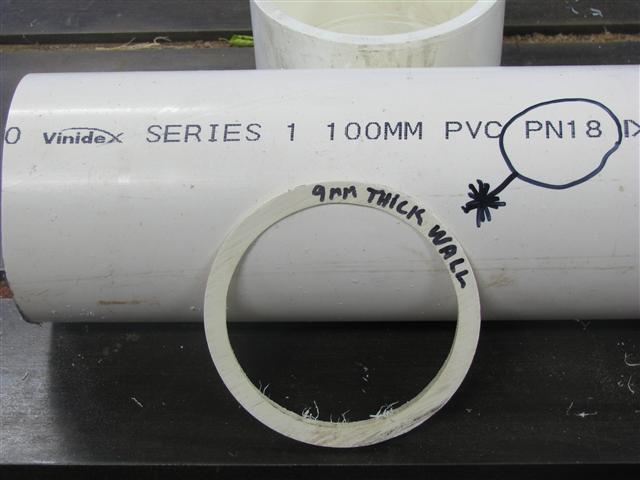

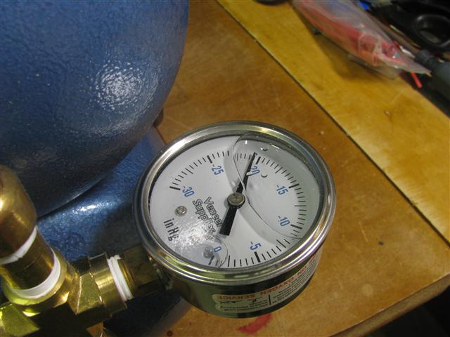

Well i finished putting my system together today. The pumps is a second hand Thomas and, if you wait a while for the last .5 to register on the gauge, it can juuuuust pull 25"Hg. I have it set at the recommended 21"Hg and it gets there quickly and with little effort. Best of all my system has held 21"Hg for the last 2 hrs without loss so that means no leaks
I've wanted to build one of these for the last couple of years if for no other reason than they look like an "eranium pu36 explosive space modulator" and i have always want one of them in case i get the urge to destroy the world.
I followed the plans from the Joe Woodworker site and found the project to be simple and fun to make. The one hurdle i hit was with the size or class of the PVC pipe. The plans, drawn up for the USA market, call for 30" of "Schedule 40 or 80" PVC pipe with matching endcaps. Here in AU we don't have that rating system so it was a little confusing. Instead we have a PN or Pressure Number rating. With a little research i worked out the or equivalent is PN18 or PN12 and that stuff can be Xie unless you get lucky and find a place to trade for a carton of beer as i managed to.
Anyhow a bit more research revealed that 30"Hg is actually only 1 BAR of pressure or just over 14psi. So there remains a big question over the need to go so robust with the PVC in the first place. For anyone else thinking of venturing down this track, i remain confident that PN9 PVC will be more than adequate to make reservoirs for these vacuum units.

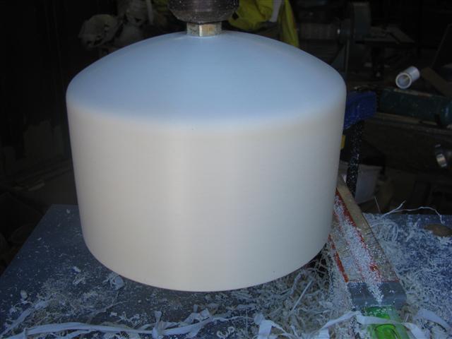

I see that John has used 150mm drain pipe with an internal bracing and it appears to have worked out very well for him so that is certainly a good option and as i found, is no more work than using the more substantial domed endcaps which fit the higher PN rated pipe.
You see the high pressure rated fittings are quite thick as they are all made to the highest PN18 specs allowing one size fits all PN classes. On the face of it this would seem to be a good thing. But when you go to assemble the parts supplied with the JWW EVS kit, you soon discover that the main manifold components, that is those brass fittings which join together to mate the two PVC reservoirs side by side to act as one, are too short to reach from centre to centre on the end caps DAMHIKT
Anyhow sitting half way between "look before you leap" and "there's more than one way to skin a cat" is this solution. The holes where drilled and tapped into the centre of two of the end caps. (A note on this, the Joe Woodworker kit comes with all NPT (National Pipe Tapper) threaded fittings. Either buy the correct 1/4" NPT tap from JWW when you by the kit or if you only have a 1/4" BSPT (British Standard Pipe Tapper) tap, then that will work OK.) Drilling the holes off centre will not work too well as the two endcaps need to be screwed onto two "T" pieces on the manifold and the oscillation as you attempt to screw them into place would cause them to jam upon each other.

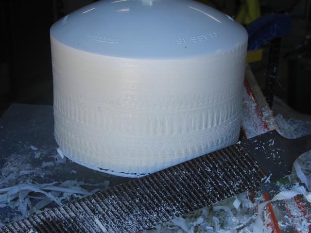

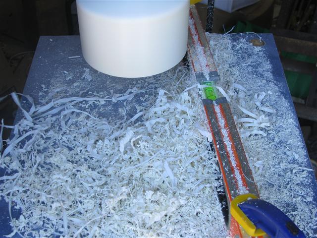

Once the fittings were tapped, i screwed a 3/8" barb supplied with the kit into the endcap and chucked it into the drill press. Using a chisel, and a spirit level as a tool rest, I turned the fittings down to size. This does not effect strength that much because the domed end remains untouched and most of the sides of the caps will be supported by the pipe once it's glued in place.
As you can see the finish off the chisel is quite brutal...
This is where a "Mill Cut" file comes into it's own. You can see it in the above image, it's like a rasp but each tooth is cut at an angle from one side of the file to the other. The mill cut file makes short work of the ridges and leaves a finish ready for sanding like this...
Then it's just a matter of holding some 80 grit and then 120 grit cloth backed abrasive against the spinning cap and you end up with a finish like this.
And a mess like this..
That job done it was just a simple matter of sanding a flat facet into the other two endcaps so the reservoirs would sit parallel, and then following the simple plan. You will note i used some paint to tart things up...no wallet was damaged in this production. The crappy 'jarrah' stained polyurethane used on the ply was left over from a little fix up i done for my mother around 5 years ago. It was lumpy but effective
The Hammer tec blue came from the last can of a dozen i bought at a disposal auction over ten years ago...lasted well that stuff...OK i paid $8 for a spray can of red. Why? Because i felt anything with the core function of this machine should be equipped with a stick of bright red lip stick
So here she is............meet Phylis

Allen, in the Charles Fox article I sent Kim he mentions that the vacuum helps take the moisture out of the glue quickly and PVA glues set faster. Makes sense. See no problems using other water based glues. Polyurethane would be a problem as it sets with water contact.
For bridges the clamp acts so quickly I recon you would have more time to glue on a bridge with HHG than with other clamp setups. I use two pins through the outside holes, push the bridge on, place bridge clamp on and turn tap. Bingo.

Hi Kim, Your pump looks great...very professional...I didnt spend so much time on presentation...
.....anyway your pump looks pretty much like mine capacity wise and will pull 25 when I can barely get 19. Do you think that there may be something wrong with the gauge or is my pump a whimp? Sad Any way at least 18 0r 19inchs of HG is adequate for our purposes....I'd just like more ...than just adequate.

I have a pump on the way and initially want to do a bridge clamp.
Dont really want to go with the LMI version for usage a few times a year.
any hints for homemade as cheap as possible?
