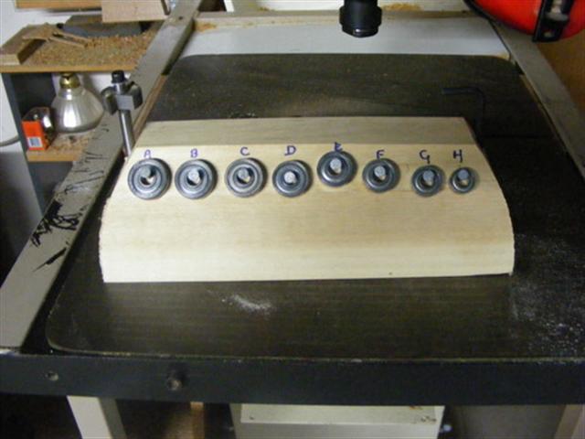

the holder for the bearings with their allocated reference letters A B C etc,

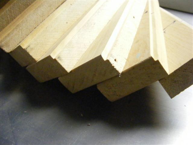

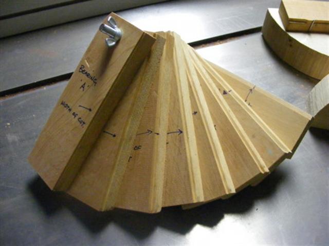

the wooden “feeler gauge” type thingy that has a wooden sample of cut each bearing produces with the reference letter

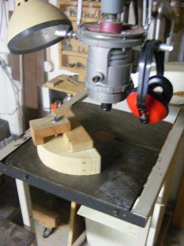

and the jig I made up to quickly hold the wood sample as it passed by the cutter.
Now I can fit the selected binding/purfling into the sample rebate and match this to the bearing referenced on the wood sample.
