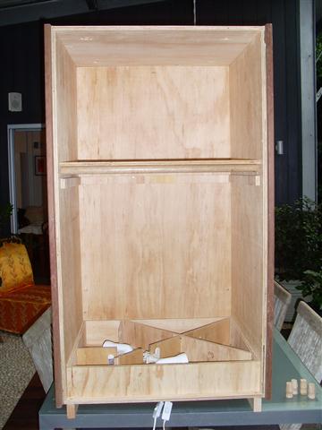

I got this idea from a thread in which a dry box is shown....
I have 1. limited space, and 2. limited funds for this hobby at the moment 3. an AC that only seems to make my little work room MORE humid when run on dehumidify...
So, I extrapolated from the dry box I saw, and made myself a mini dry room, which also incorporates a go-bar press, and ample storage for my small stash....
I'm running it overnight to see if it's adequate to drop the RH to acceptable levels.

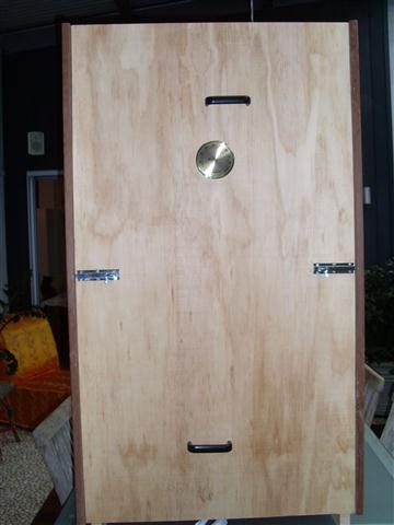

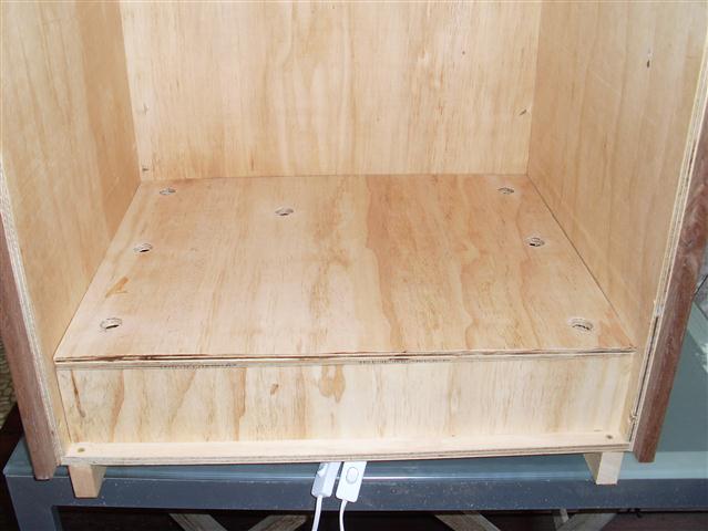

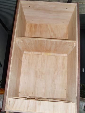

2 sheets of 12mm ply, one length of 25mm dowel, and od bits left over from my building days. also a hygrometer....

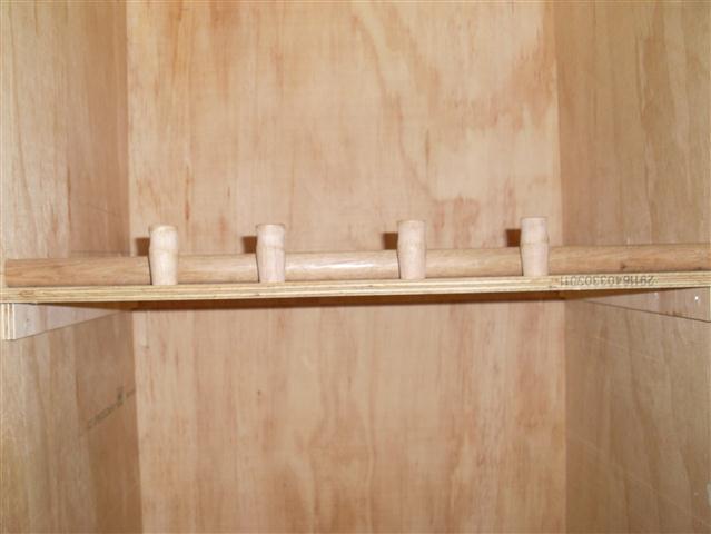

the three dowels act as a brace for the top of the go-bar deck when the shelf is underneath. There is room to store two or three made bodies on top. the shelf pulls forward to allow for storage of side materials, etc. I created a box at the base to hold the lights and brace the shelf there for the go-bar press. I drilled series of holes in the top and botom, and made plugs out of left over dowel to try and control heat and humidity levels, etc. I'll have to experiment with it, I guess, as the initial result is RH that went from 75% to 90%....Mayber more plugs for he bottom, which has 4 holes to allow air to enter. Theory being that hot, dry air will rise, filling the box.....

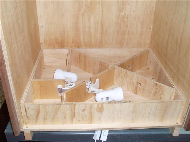

Report tomorrow morning after 16 hrs of lamp time....Oh, lamps are two 40watt clip on bed lights....may not be strong enough, but we'll see...
Here's some pix...
Now to see what happens overnight...
Here's some pix...

Hi Nick, that looks great, but... I'd probably do at least the test run while being around (and awake), or couple the light bulbs with a smoke detector...

You will actually need to get rid of all or most of the ventilation holes for this to work.There is a certain amount of moisture in the air in your shop, heating will not change that,or dry the air, but at elevated temperatures the air can hold more water so it becomes relatively less saturated ie lower RH.
You will probably need to raise the temperature in the box about 10-15 degrees C above ambient to get the required RH change and you will have trouble doing this if you are drawing fresh air through all the time.

I'll make a few more stoppers for the holes in the bottom, and see what happens then. RH only went down to around 85% this morning.
With all the holes closed off, a convection current can occur within the confines of the box, allowing the air to pass over the "heating element" repeatedly. I think there is quite a bit of moisture beeing drawn out of the timbers, as the room smells quite strongly of plywood....

Try closing the top holes too, You need to keep the heat in.
What sort of bulbs are you using? they should be incandescent not compact fluoros
