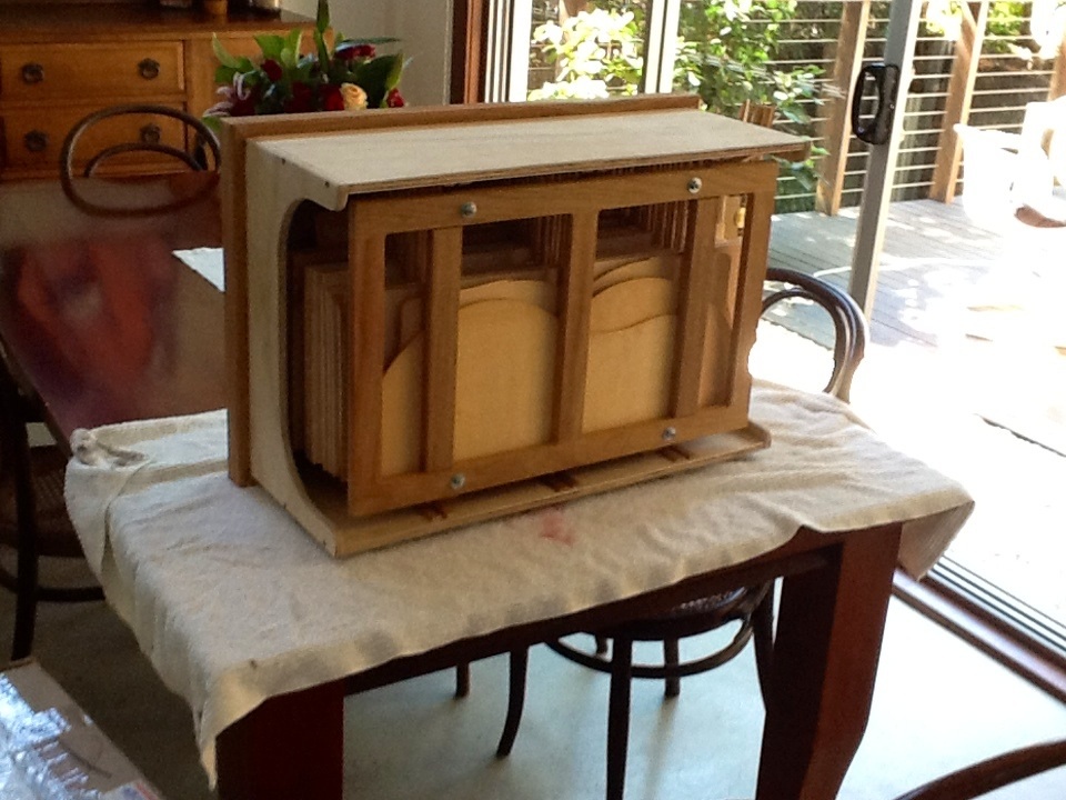

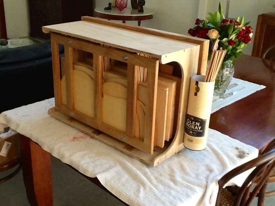

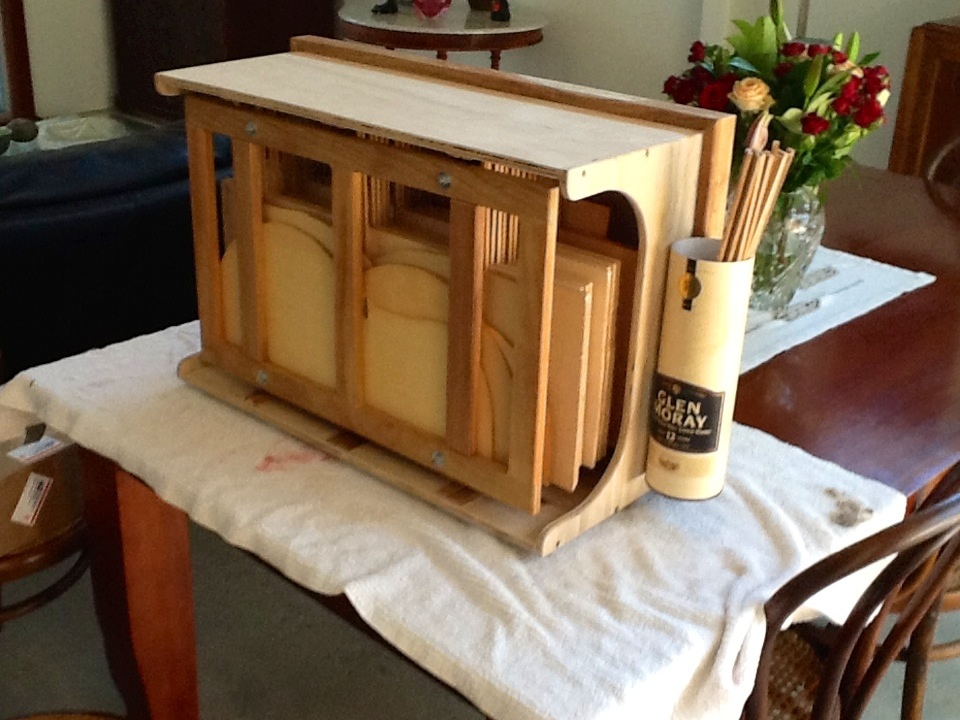

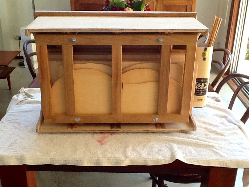

Having now accumulated a number of tops and B/S sets, I thought I ought to figure out a way to store some of them. One set, Tassie Macro, has potato chipped a bit, and I wanted a small press to keep them all flat-ish. I had two criteria. 1. Be able to hang it on the wall, and 2. be able to fit my small stash of 12 tops.....
Using stuff I found under the house, specifically, half a sheet of 12mm ply, some 40x19 NG RW, and a bunch of cedar offcuts, I came up with this..... The stripping is cedar cut into 4x4mm sections, and the box is ply, with the "cage" and trim NG RW.
Holds my little collection at this point. I'll need to make two more. One for backs and one for sides....

Now I like the ingenuity of the sticker holder, my kind of container,although it does indicate that the original contents have been drunk
Nice solution Nick & it doubles as a small table at the same time! Clever bastard.
