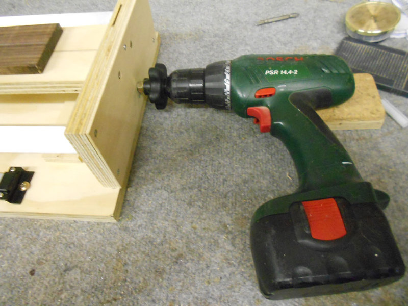

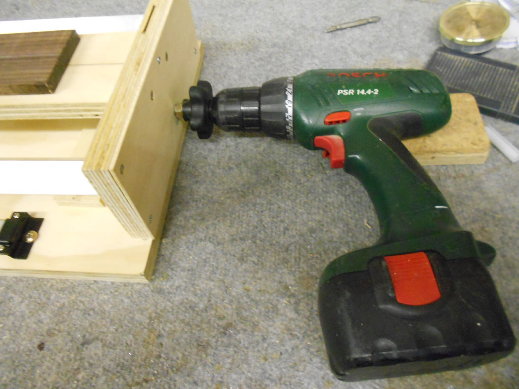

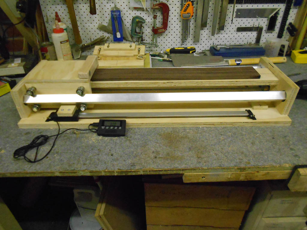

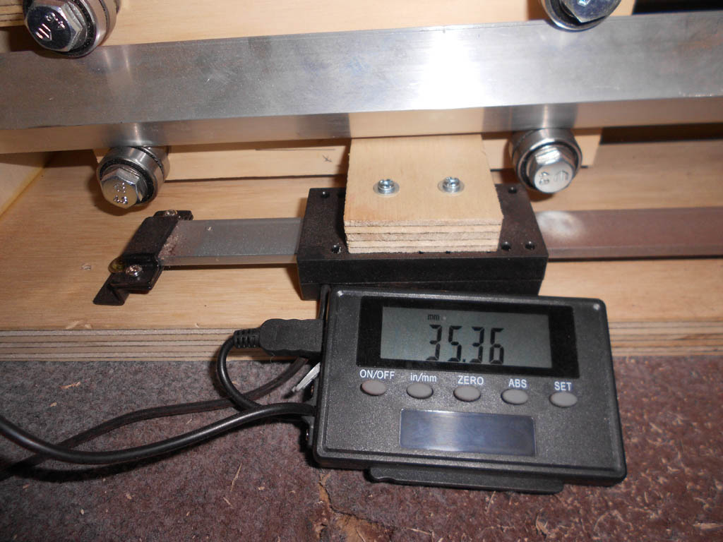

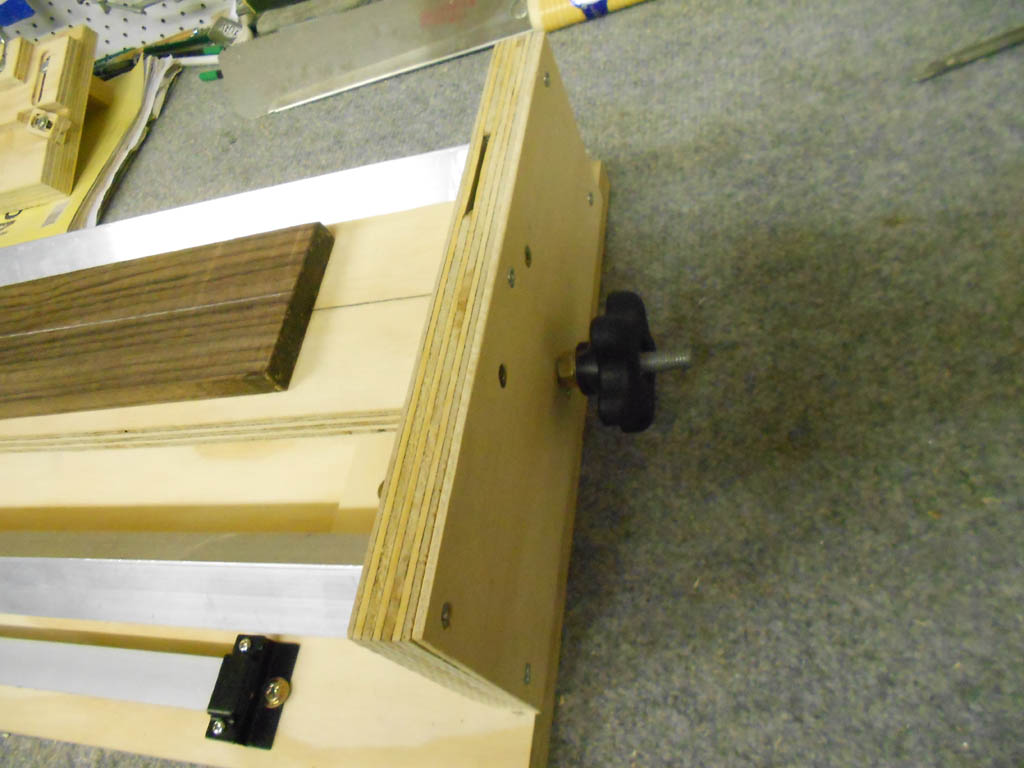

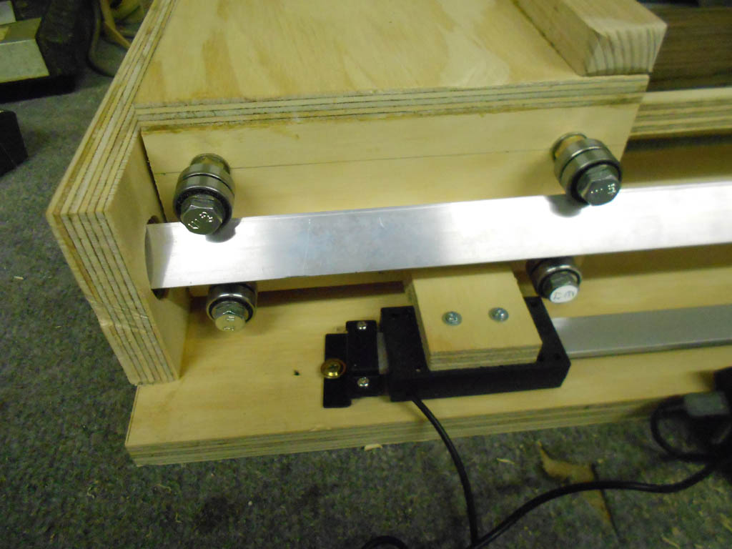

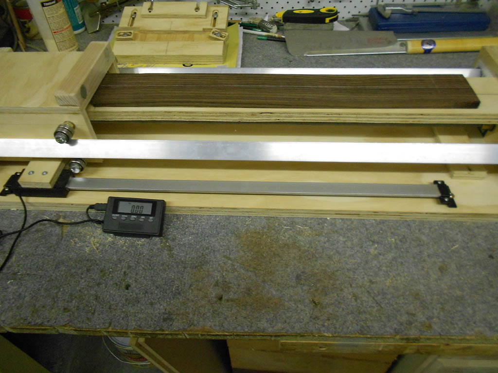

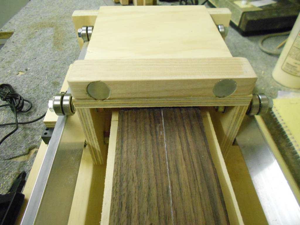

I tried using a rule and marking knife for fretboards but couldn't seem to get them accurately marked/cut so I resorted to preslotted and radiused fretboards for my first two guitars. The two I'm currently building have 'non standard' scale lengths so I'm obliged to make my own but was seeking more accuracy than I knew I could achieve by hand. I searched the internet but couldn't find anything so came up with the following by ripping off the CNC guys.

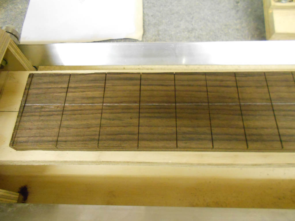

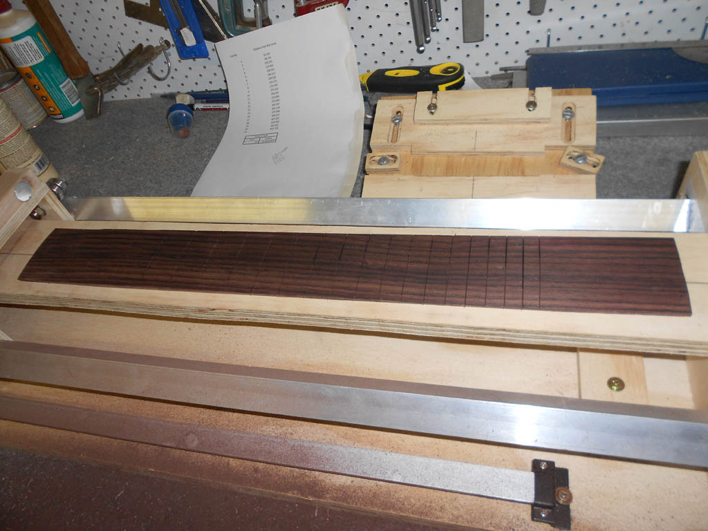

Basically, it's an X axis gantry riding on skate bearings on 25mm square section ally tubing driven by an 8mm longthread mounted in skate bearings. A handle on the end moves the gantry 1.25mm per revolution and I extended the threaded rod through the handle to attach a drill for rapid transit. I used a digital linear encoder to provide absolute position with 0.02mm precision (about $40 off EBay) so I didn't have to worry about backlash. To keep the saw parallel to the cut I mounted a couple of rare earth magnets. Just knocked off my first and it looks like it's within 0.1mm or so accurate between each fret (digital vernier) and I can't see any error with a ruler between fret zero and 21.

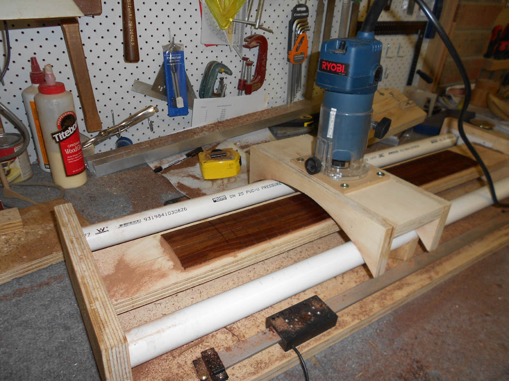

After having spent a couple of hours sanding the radius, I realised that it would be simple to modify it to carry a router as per Martin Taylor's post below.

Makes my jig look prehistoric! Would love to see how the saw is mounted.

It's sold as 600mm but it measures 500mm due to the 100mm encoder case. Pretty impressed, metric and imperial (in thou and fractions), relative measurements too and it seems accurate enough.
Modified the jig for radiusing today a la' Martin. Bloody ripper. I'm a bit under 1/4mm thinner at one end so I might have to shim the base up a bit one end apart from that, 5 to 10 minutes with the router and I'll run through a couple of grits to finish it off. I reckon less than half hour all up - bucket load better than the couple of hours of sweat and toil doing it by hand - thanks Martin!

The saw is held vertical by the RE magnets. I had to spend a bit of time getting it squared up and it's not too hard if you go easy with the pull saw. I found 4 or 5 easy strokes did the job. A couple of rough bits where the saw kicked a smidge but always on the edge so disappeared when radiused. I did another today and no probs, just slowed down a bit and stopped using the saw the way the old man taught me!martintaylor wrote:Makes my jig look prehistoric! Would love to see how the saw is mounted.
Ebay. A bloke in SA is flogging them. 500mm travel was a bit over $40 - just checked EBay for a link for you and it was actually $48 including postage. Try this http://www.ebay.com.au/itm/DRO-Digital- ... 51a6a45353Henk H wrote:Nice jig ! However thusfar I couln't find a reasonably priced digital linear encoder. What brand do you use and /or where did you find it ?
