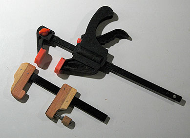

I use those cheap small quick grip "clamps" to hold things in place (they do not really clamp). They are of a similar size as my plumwood clamps, but much bulkier:

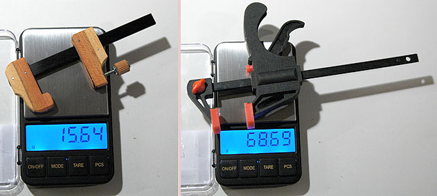

...and more than four times heavier!

Which one holds tighter?
Re: Simple small clamps
Post by charangohabsburg » Wed Mar 06, 2013 10:36 pm
With the wooden one I can clamp hard, the plastic one doesn't really clamp but only holds things in place.

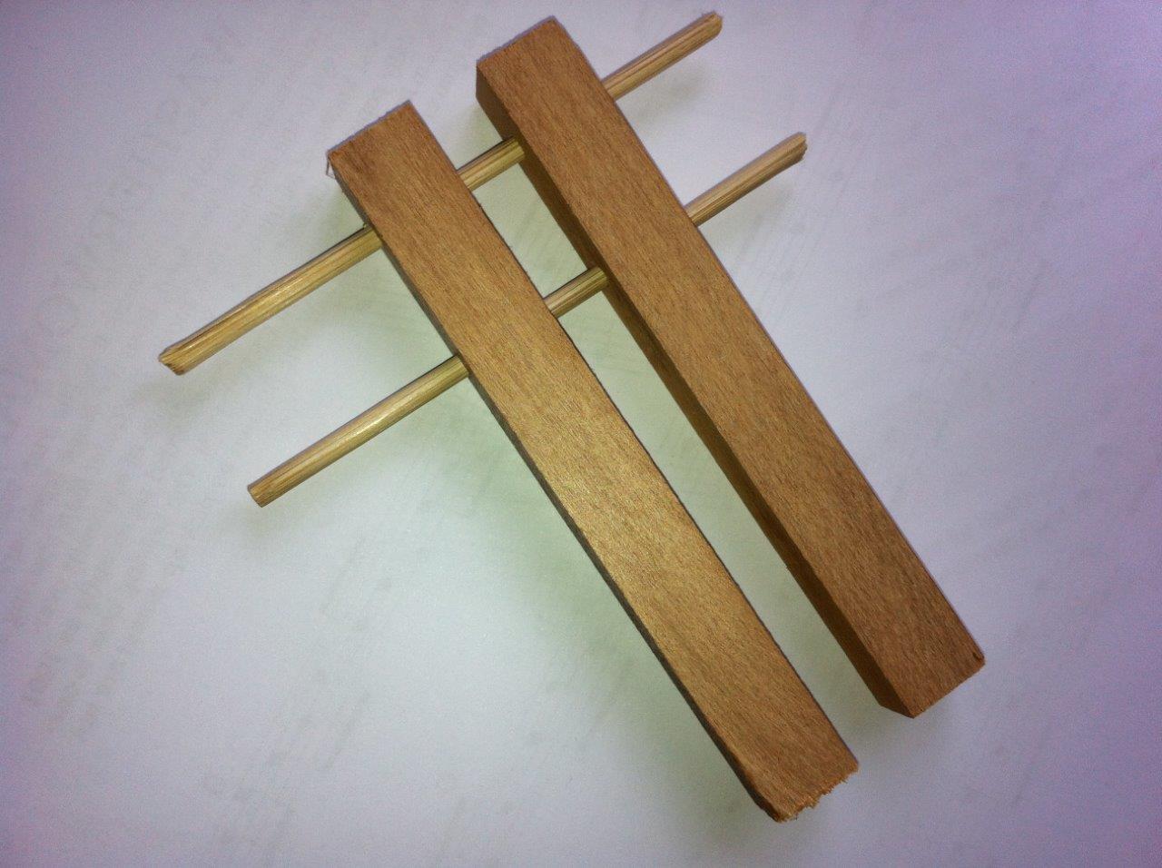

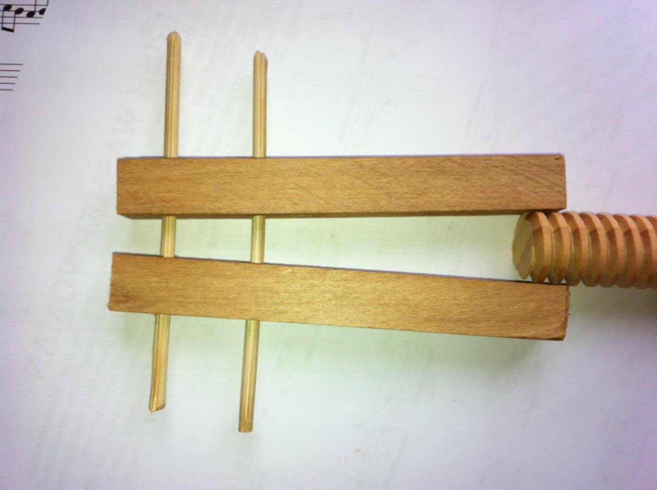

I was shown a very simple clamp recently which may be of interest. Not all that powerful but good for holding things in place while glue sets - for example holding kerfing.
Two pieces of wood say 10*10*100. One bamboo skewer as used for BBQs/satays etc. - this one is just over 3mm in diameter. Cut the skewer in half. Drill holes in the wood. The holes should be a snug fit so the pieces of wood slide easily over the skewers but don't wobble. When the pressure goes on the skewers bend unequally prohibiting further movement. You could make dozens in a few minutes.
