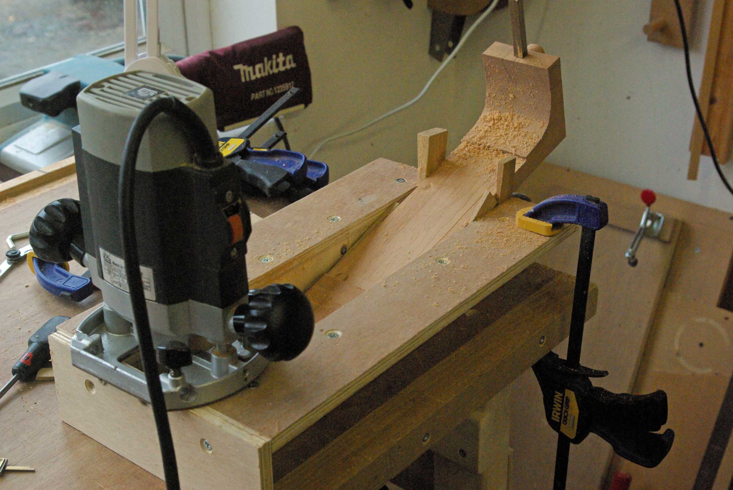

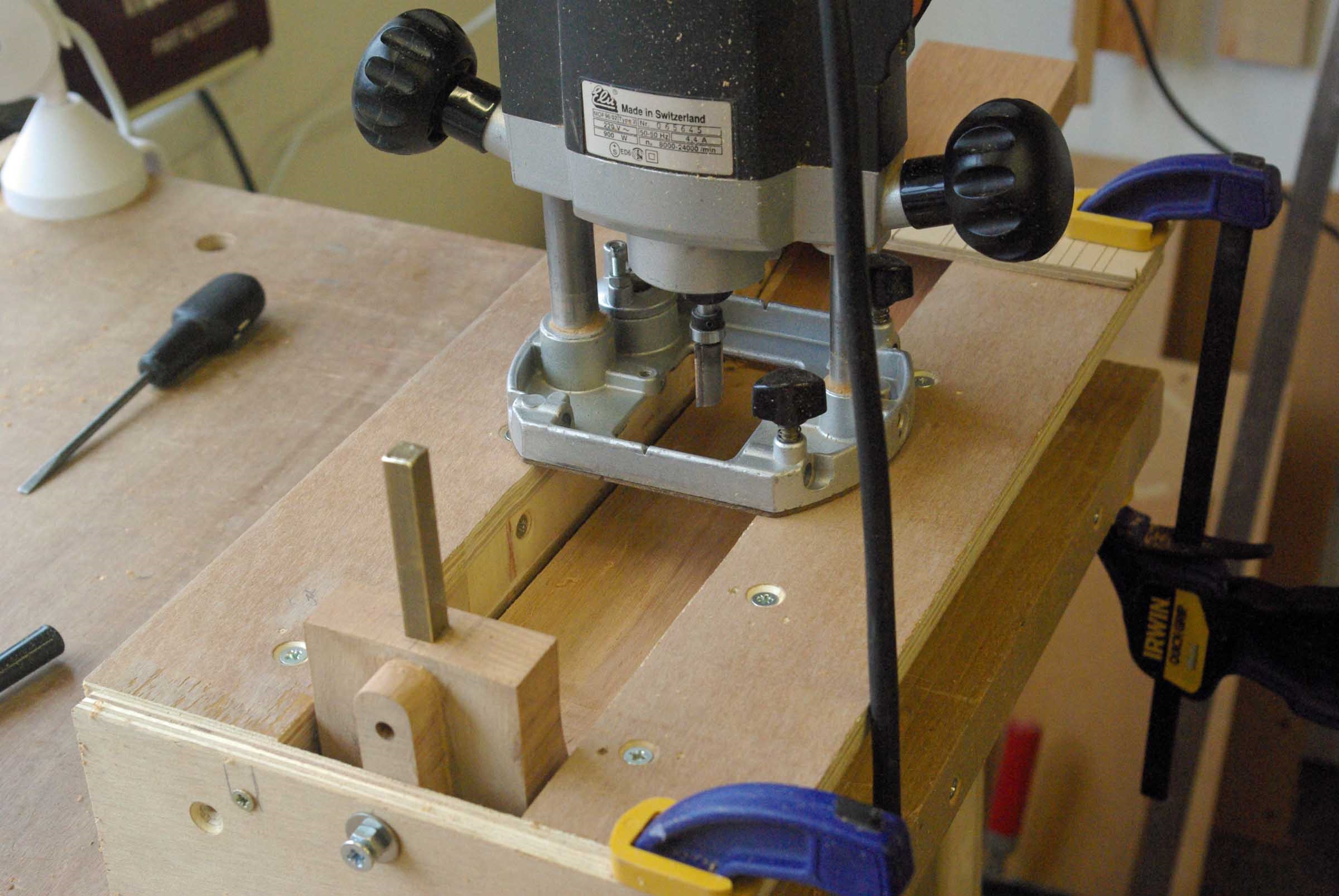

For those without access to a safety planer this will allow a router to be used.
The neck is raised the amount you want to taper at the head end, secured with a bolt at the tenon plus wedges at the head end as it is deliberately wider than the width of the neck which will vary.
You can't get to the 10 th fret (or12) because the heel is in the way but it is still useful.
You can do the headstock as well. This is not tapered and is supported under the neck by a big wedge then wedged very firmly into the jig. Not ideal since things could slip but it has worked OK for 3 or 4 necks so far.

Nice, but give me a handplane and spokeshave anyday.
Quicker, quieter, less messy, more fun :p .

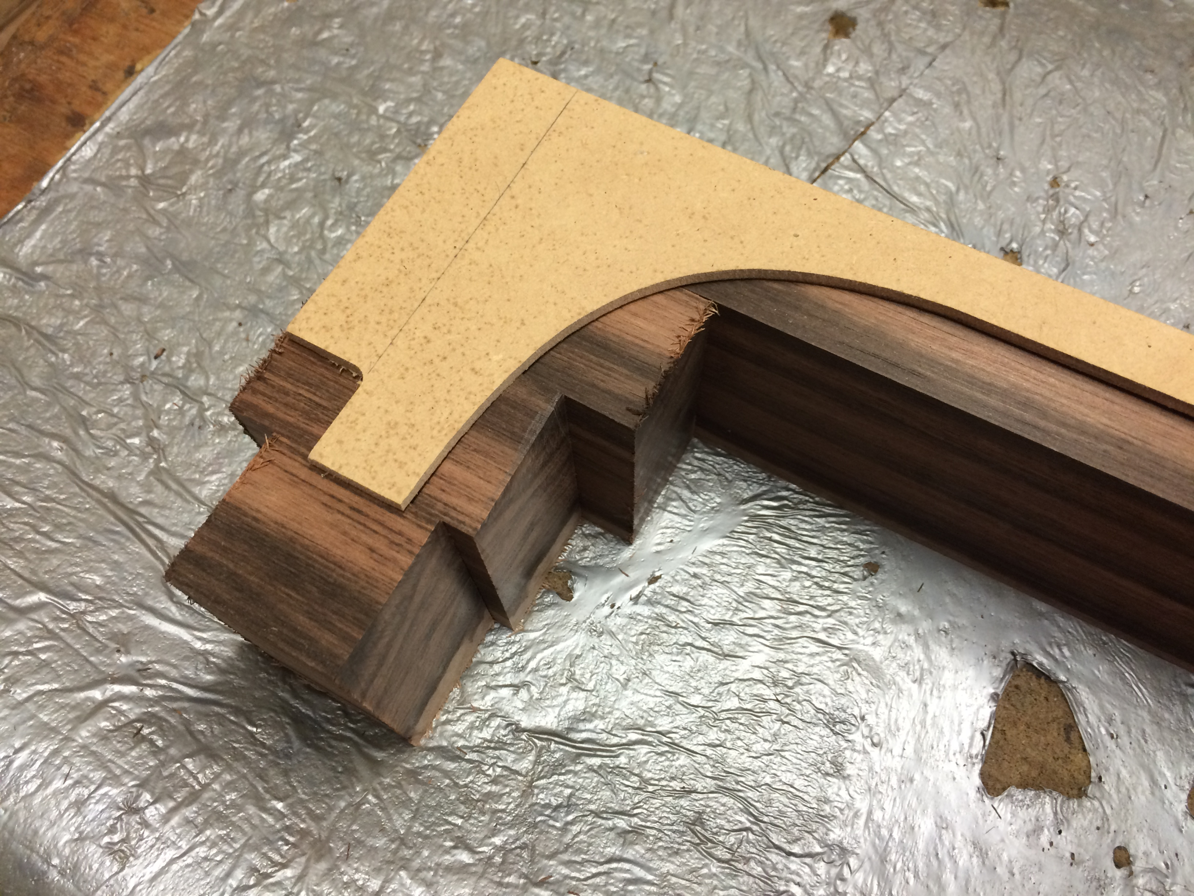

I just run it through the bandsaw. Quick and easy.
Home made template to get a line, cut outside the line and then rasp back to it before shaping the profile.
