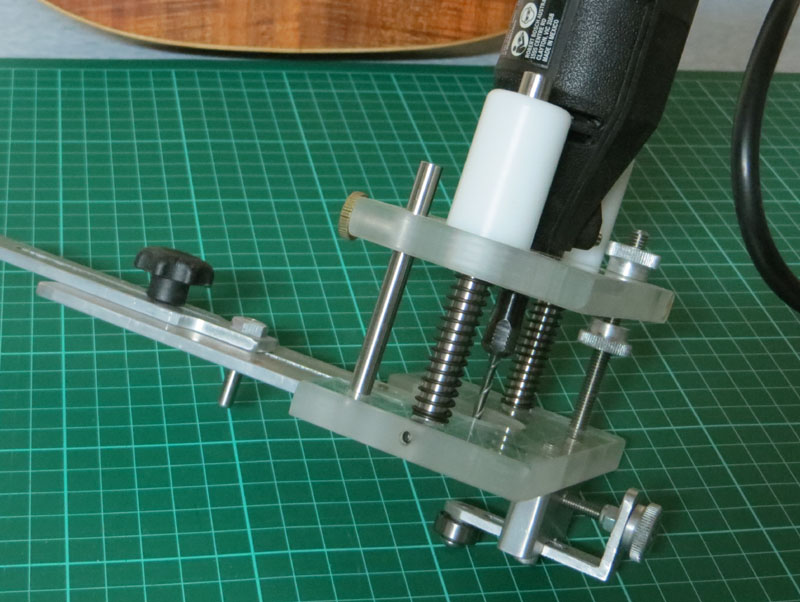

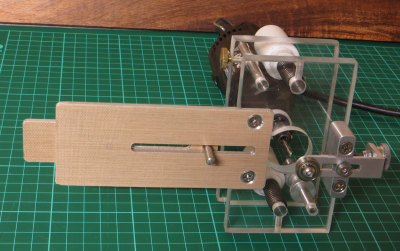

Years ago I needed a Mini router I was doing some inlay in some boxes then the Instrument thing for the mother of pearl ,after many incarnations and finding others that had solved the problem in many diverse ways I am happy kind of with this

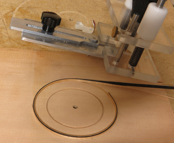

The circle cutting from 45 mm dia to 170 dia edge binding and just plain routing .I had some left over 12 mm acrylic sheet and I thought If I could see through it life would be easier .

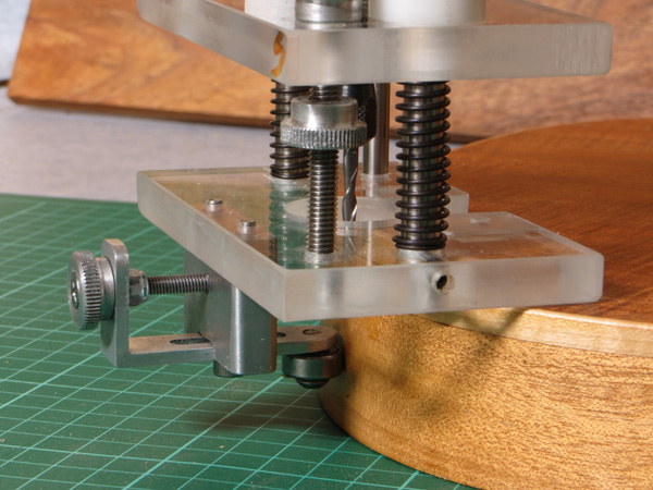

The adjustment is a 6 mm thread so every turn brings the cutter down 1 mm and I can also lock it off the other side ,the scale I scribed on the circle cutter has an amount of accuracy I have always used a compass to to draw out the diameters I want before I put the 5mm pivot hole in .
It is handy for all sorts that being said a dedicated trimmer would be better but the Dremel is also handy for a heap of other stuff that I do ,cheers John.
