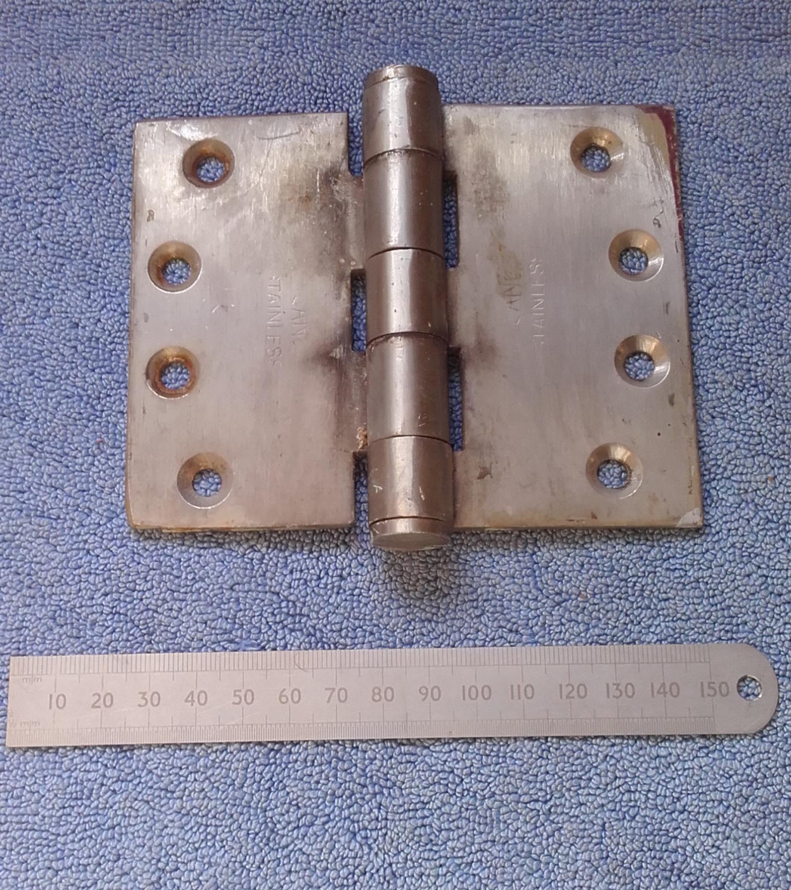

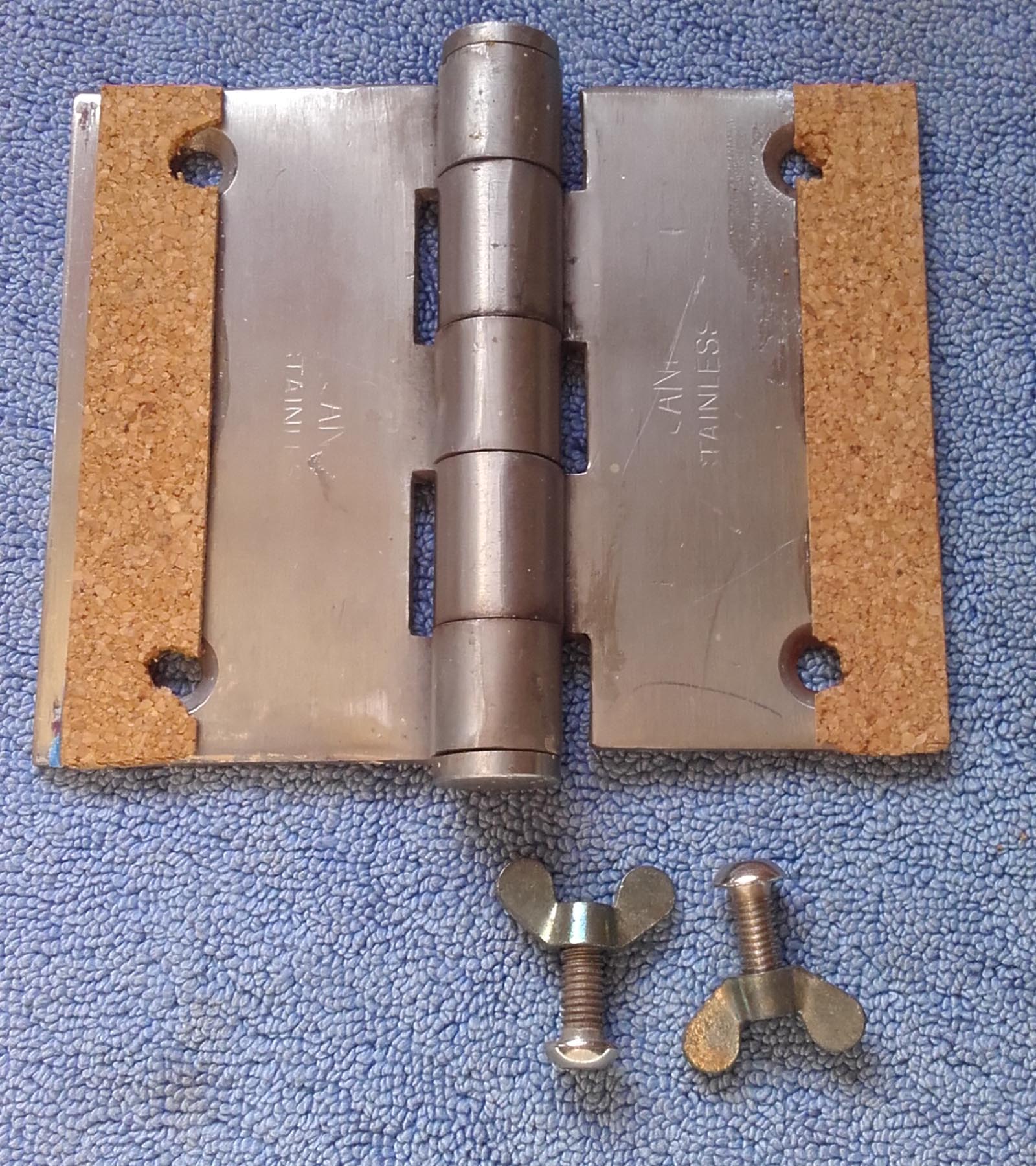

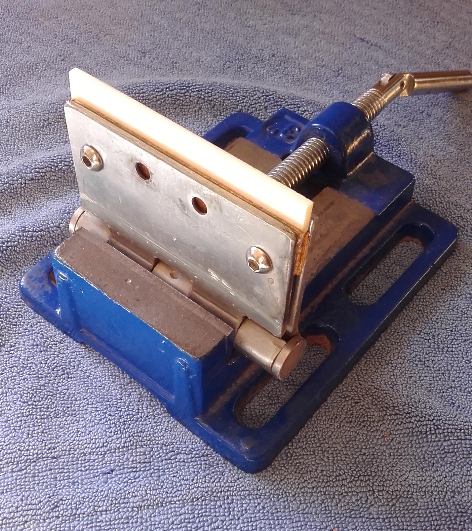

Post by Bruce McC » Thu May 03, 2018 10:00 am
My way of holding nuts and saddles.
Bruce Mc.

OK, that looks like it would get the job done! I love to see somethimg cheap-ass but also perfectly effective

Now that I like!
I've been thinking of adding some tall jaws to my Parrot vice for dealing with nuts and saddles but that looks like a good solution. Thanks for the idea.

Brilliant idea.
Love it.
Simple as!
