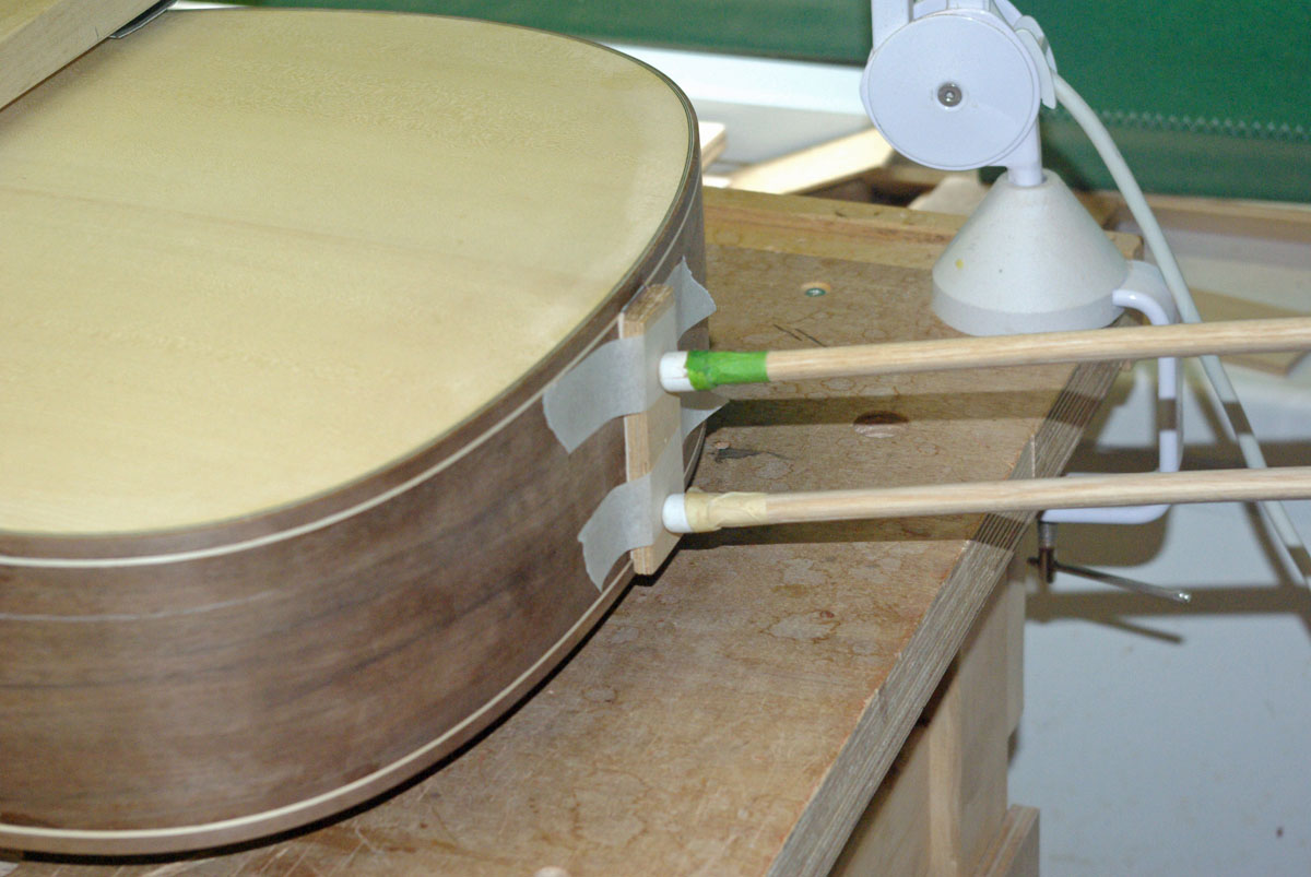

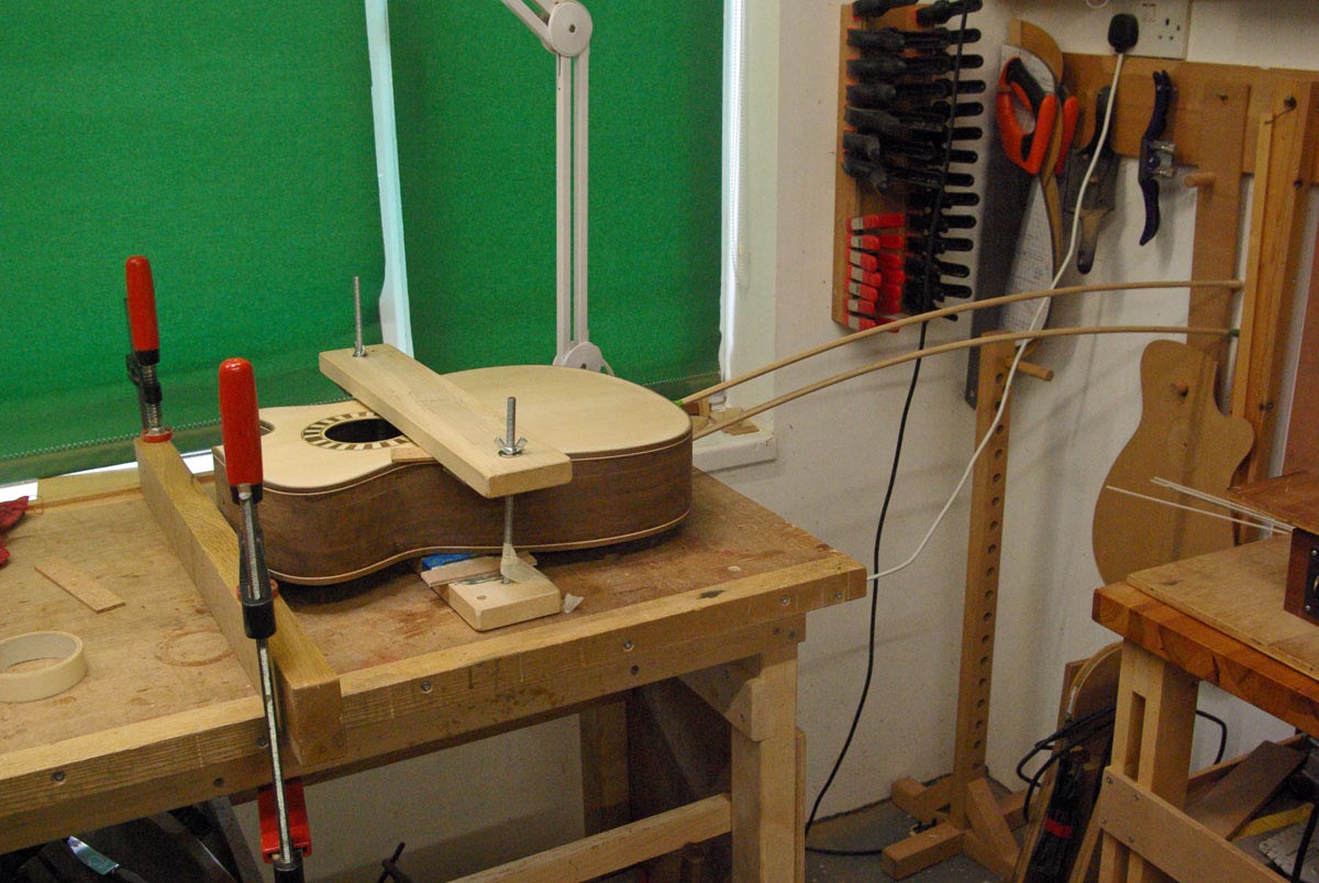

I saw this idea somewhere but since I can't remember where I can't attribute it.
Since I was doing this job today I thought I would try it and it seems to work really well.
A means of holding the body and resist the push of a couple of go bars.
Posts: 1169
Re: Tail Strip Glueing
Post by Mark McLean » Sat Mar 16, 2019 9:08 am
Very effective! Clamping challenges are often the time when we must be inventive.
