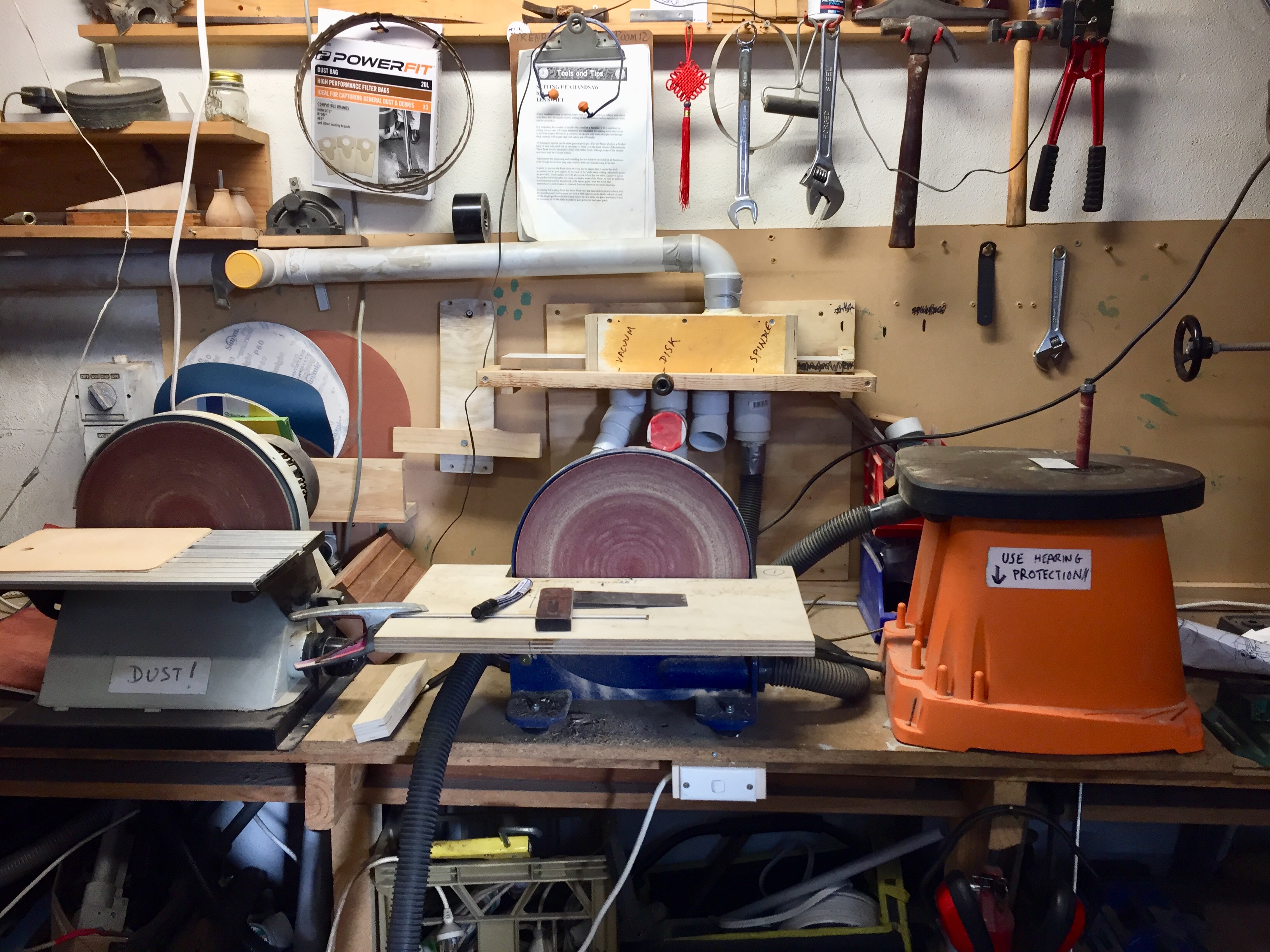

You know one of the things i’m most proud of in my workshop is my humble dust collection system. This has now been in operation for three years and we have very little dust problem in the workspace which adjoins the showroom. I don’t remember if i posted this already but the system has had a few refinements over time so i’ll post more pics here.

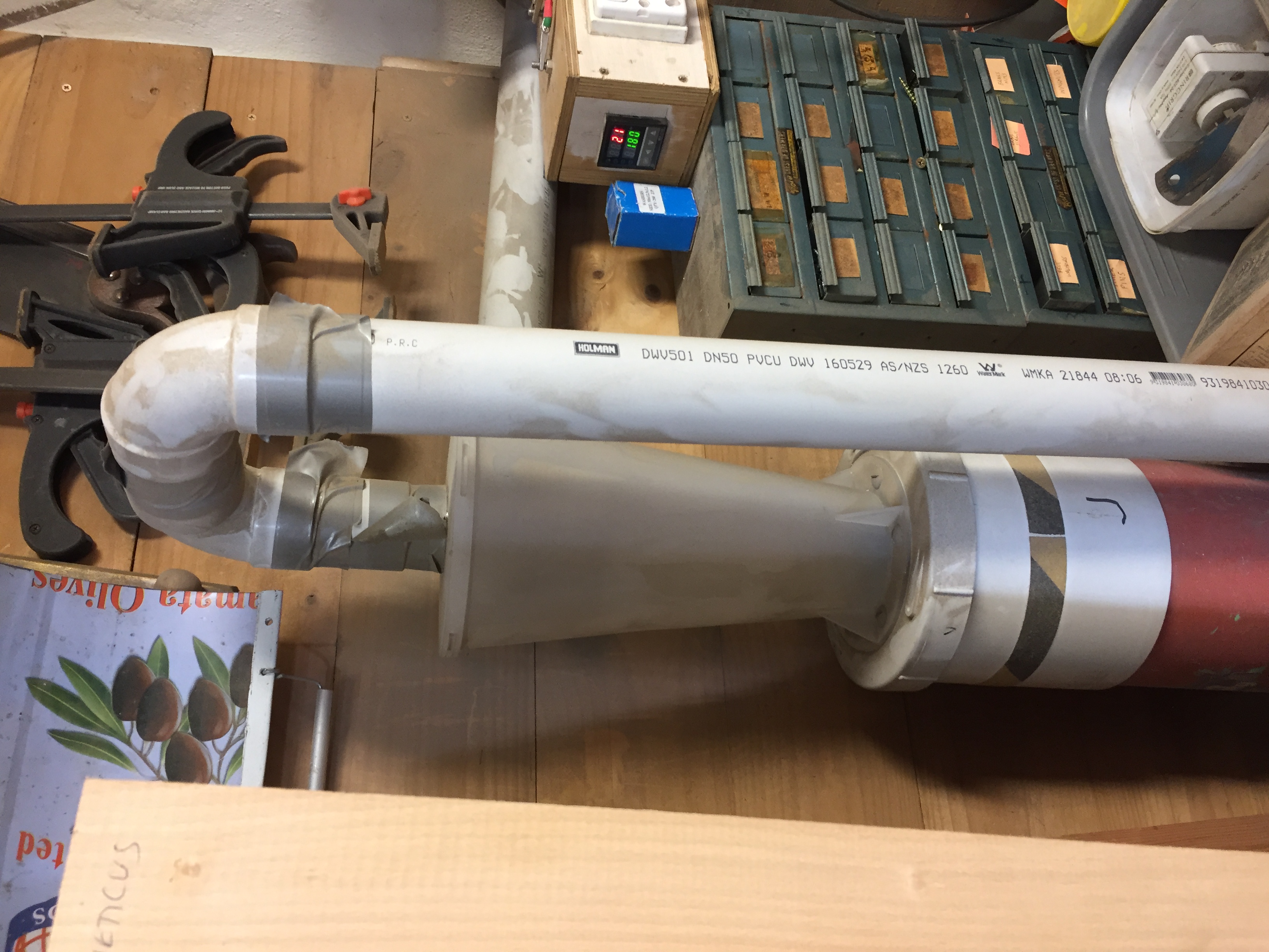

It is powered by a decent shop vac running through a cheap cyclone dust separator. Piping is just 50 mill drain pipe, plumbing fittings and flexible vacuum hose.

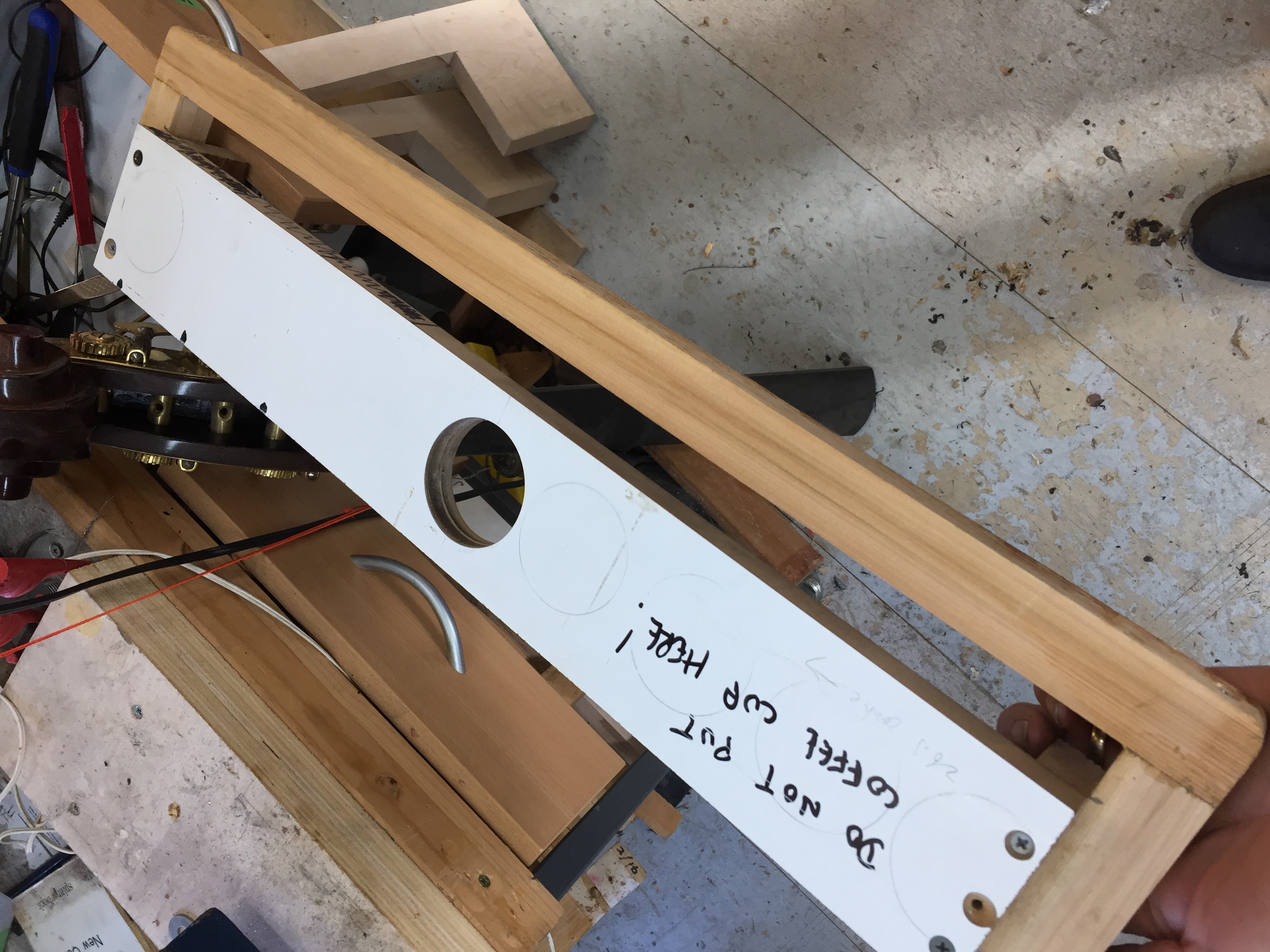

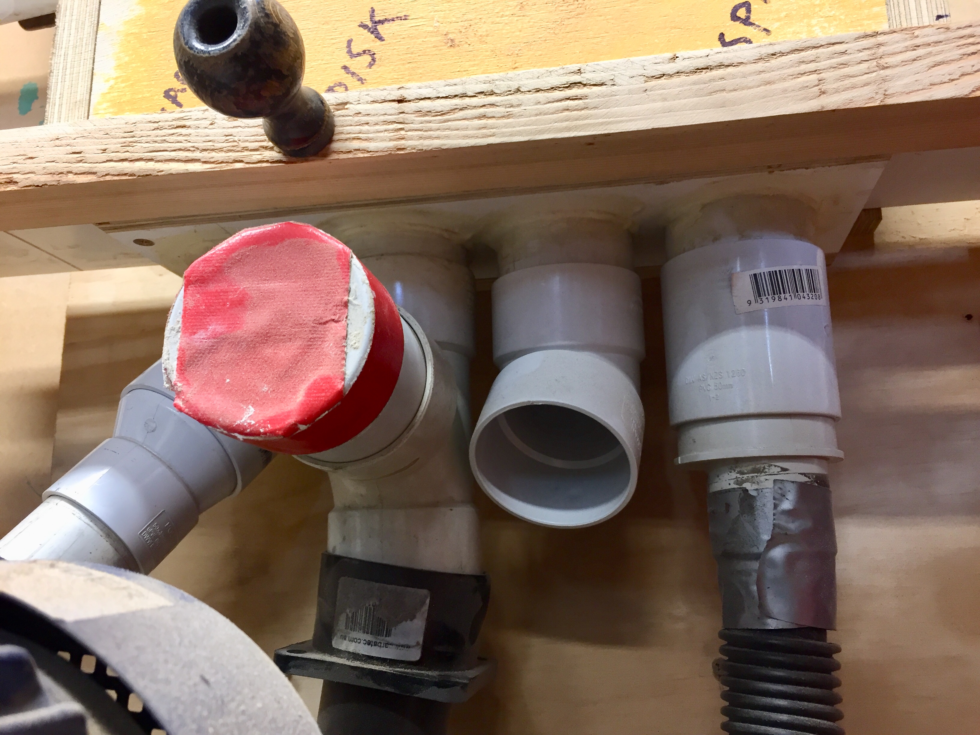

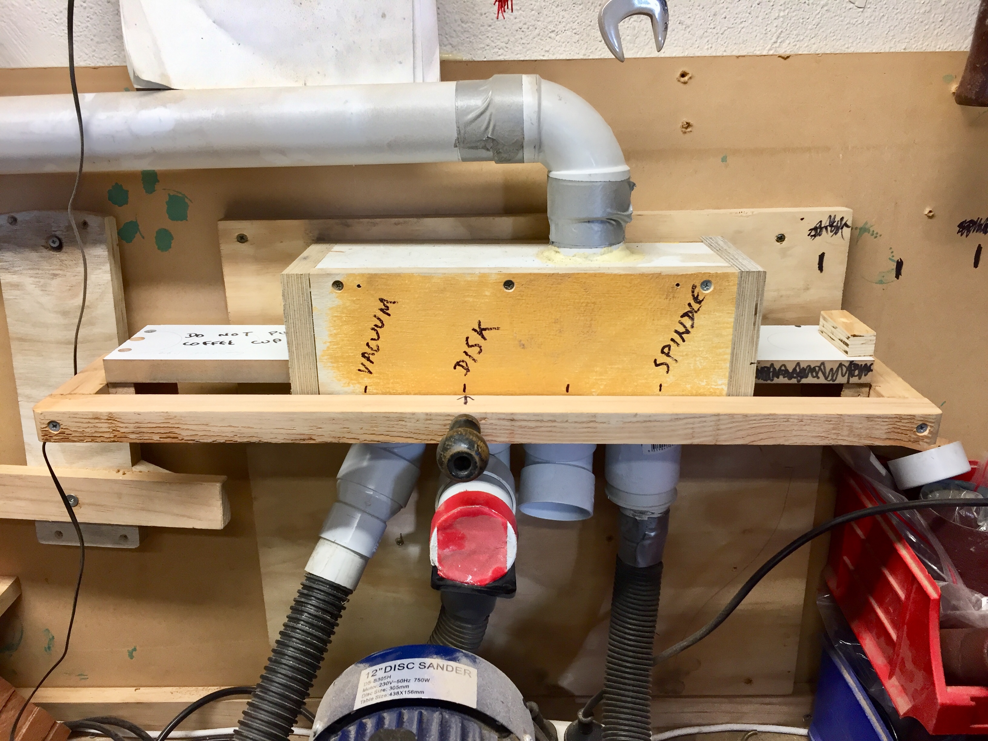

The jewel in the dusty crown is the manifold which I put together quite simply. This allows me to direct the suction to the tool manually very simply and without loss of suction. One blast gate centrally located instead of many. It is simply a box with four i inlet holes, a well-fitting MDF sliding gate, and a box with one outlet pipe.
Obviously the dusty tools have to be located close together for this to be practical, but it’s a great system and by capturing dust close to the source we have very little dust problem in the workshop. In three years I have never needed to empty the shop vac and we don’t use a shop air filter.

RodC
Posts: 58
Re: My dust collection system
Post by RodC » Wed Jun 26, 2019 8:47 am
very nice - I especially like the safety notes, cause I would definitely put a coffee cup there.

i might add that the engine behind the system is the cheap ozito shop vac with power take off under $100. In a sturdy box to reduce noise. i have a power board running off it and any tool turned on will power the dust collector up.

Me too....I mean that coffee cup sized hole is just asking to have a coffee cup jammed into it!!

Just out of curiosity, why two disc sanders?

Post by kiwigeo » Sun Mar 29, 2020 4:00 pm
jeffhigh wrote:
Fri Jul 12, 2019 8:47 pm
One for dark coloured woods and one for light coloured woods....or different grits?
