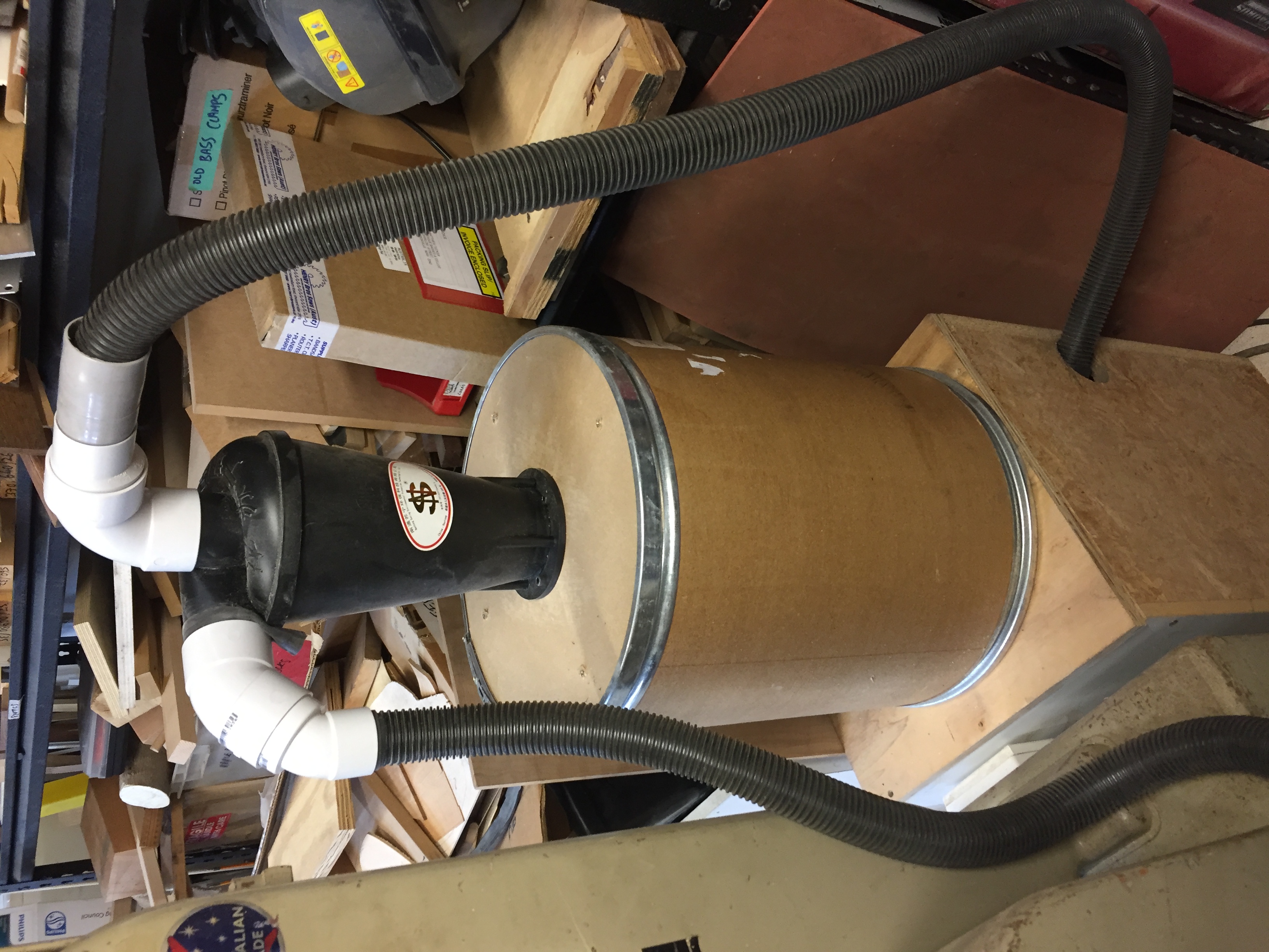

For some time I’ve put all my ozito shop vacs in a heavy ply box to reduce noise. I put a cyclone on top of this one in record time. the Cyclone is just a $40 one off eBay and the tub is one of those cardboard ones… Not sure what comes in them but you can get them at Reverse Garbage and places like that. I put a disk of MDF inside to strengthen the top, but the sides are fine. What I like about it is the quick release ring at the top. I put a strip of inner tube in there to seal it and it works brilliantly.
