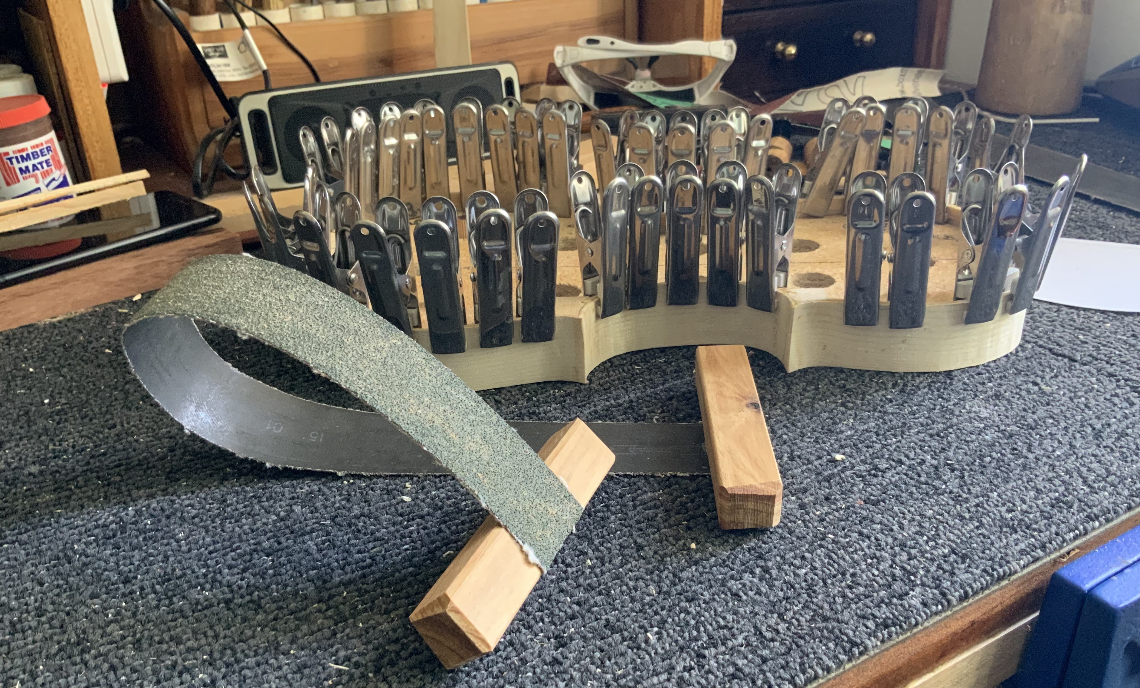

This is a “doh..” moment. Bending strap made from an old belt grinder belt. I’m more into fiddles nowadays and some of the corners can be tight, particularly with highly figured wood. Not an original idea I found it on Maestronet but still…. doh…

Now that I like. Dave

Doh indeed!. Looks like a good idea. I will definitely give that a try

Now that is a good use of waste :cl
