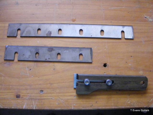

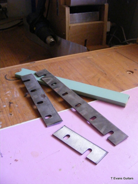

Hi, never one for throwing anything away, I found a good use for these old jointer/planer blades.

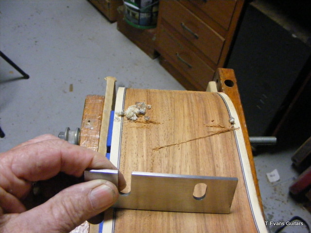

One is for scraping sides in general. It is hollow ground on one edge like the one available from Stumac.

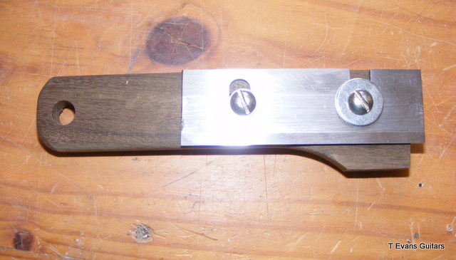

The other, fitted to a handle, I use for scraping binding, and purfling. It is adjustable to suit the width of the binding or purfling and keeps the cutting edge from contacting the main body timbers.

Very neat idea. I particularly like the handle limited binding scraper.
