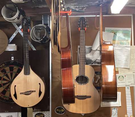

Zenith Sure Hooks from Bunnings happen to have prongs that are perfectly spaced to hang a guitar by the headstock. I don’t know if they will be useful for holding while spraying, but I find them really useful for storage. I have 5 instruments hanging from the walls and rafters in my workshop at the moment. The longer hooks can hold a couple of guitars on one hook.
Buy a multi-pack and they come out about $5 each.

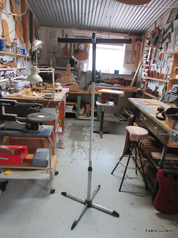

Hi, I seem to have a collection of old fan stands due to the fans failing far too easily and often. Well, what do you expect for $15.00?
Anyway, this took less than ten minutes to make.
I can't see it being over-engineered, maybe just to make it more stable.
