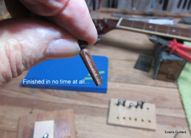

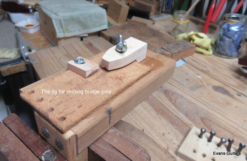

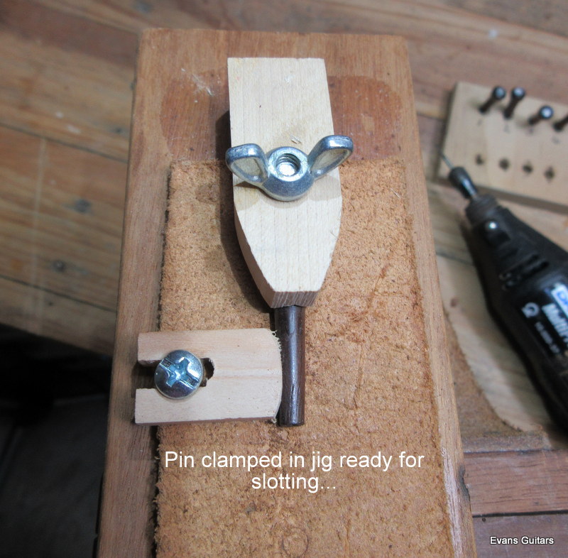

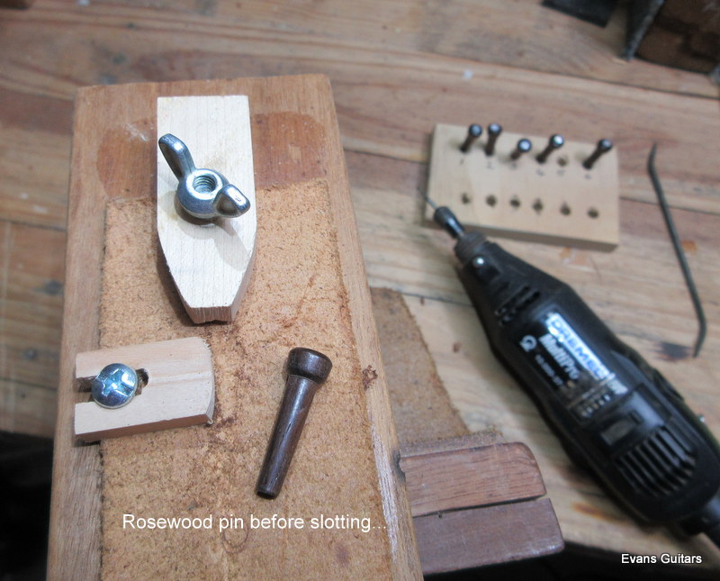

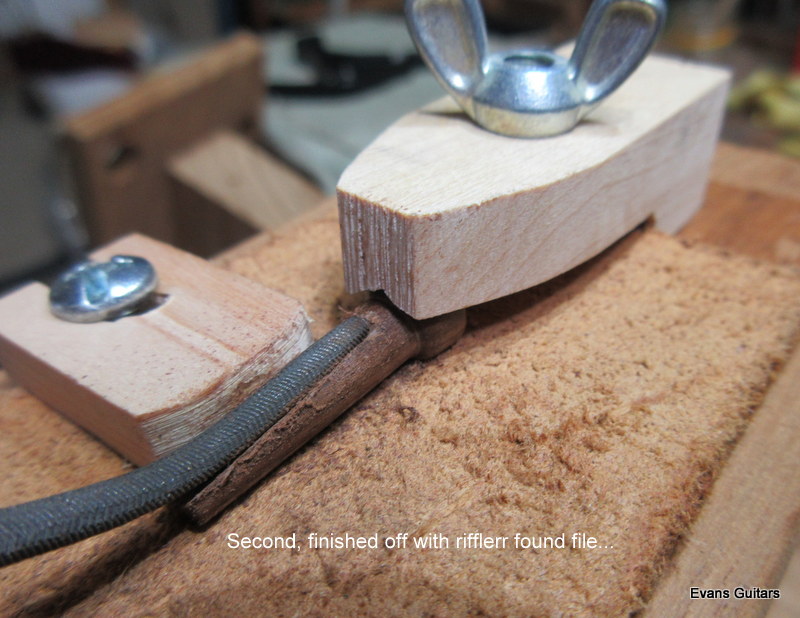

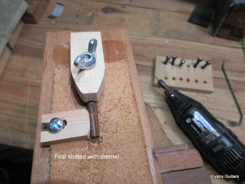

Hi, here is another small but handy jig, I think the photos will tell the story.
I came up with this when I bought a batch of bridge pins that were not slotted. Many times though I would slot the pin holes in the bridge.
