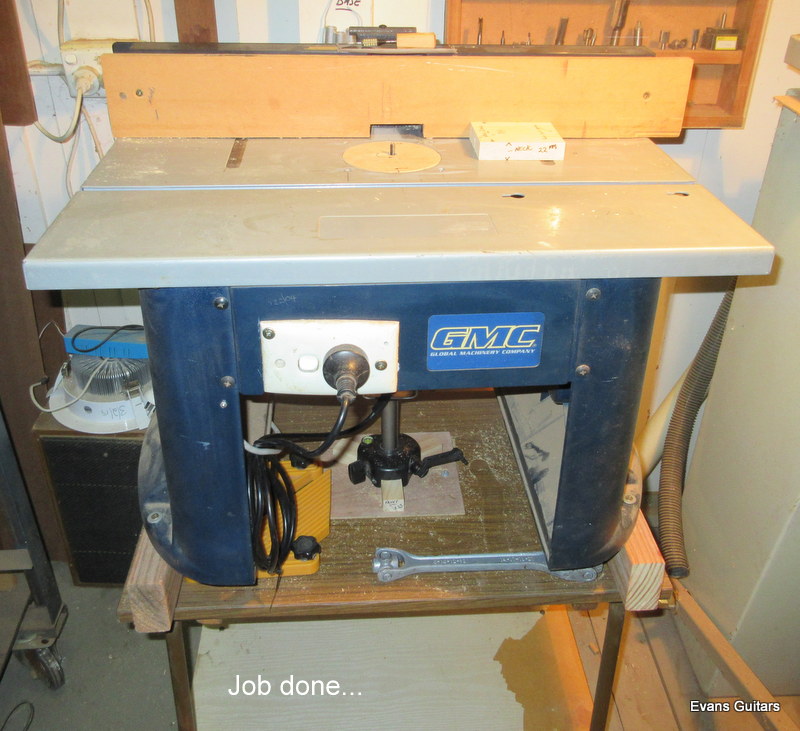

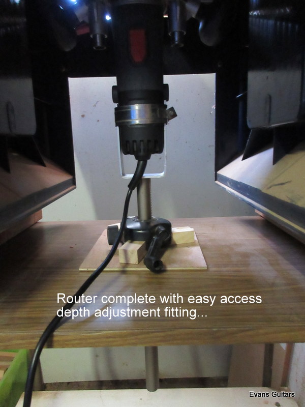

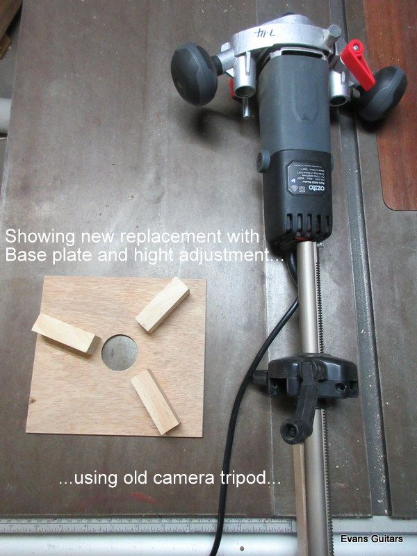

Here is another router project I completed this year.
The original router had a depth adjustment that could not be operated if the fence was used close to the router bit, so I could not do incremental depths of cut without moving the fence.
A stupid arrangement, using the large adjustment tool shown from the top, that I put up with for years… until now.
I think the photos will tell the story. Now it’s a dream to get a fine depth setting, just wined the handle, and then lock it in place.
