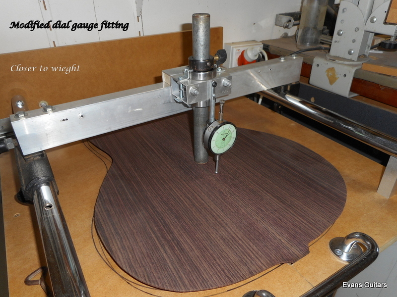

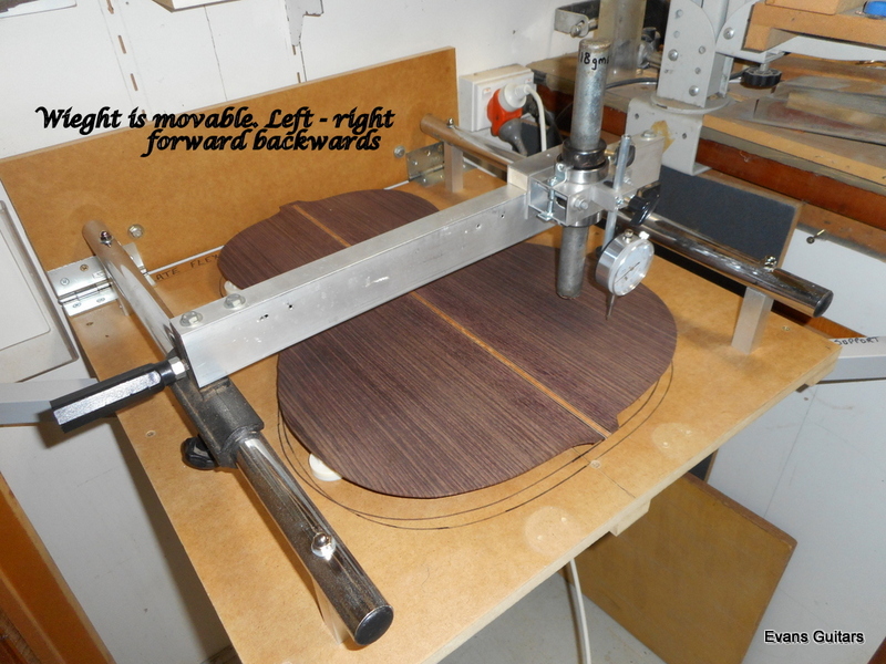

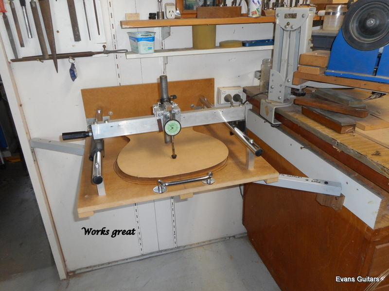

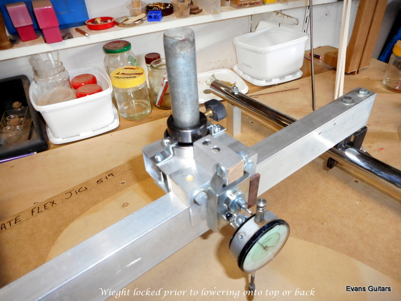

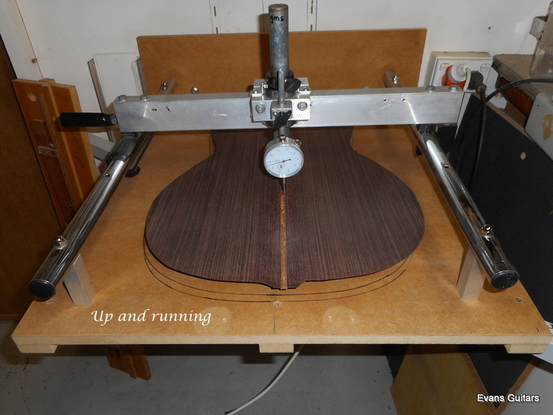

Hi Tony, I am not aware of Trevor’s flex jig, but I thought mine, as basic as it is, may give you some ideas. I have used it for many years now.
The beam that supports the weight and the dial gauge is movable back and forward and the weight and dial gauge can be moved side to side this enables any size or shape of plate to be tested.
The weight has a lock ring that holds it off of the plate until needed, it is then lowered onto the plate for reading of the dial indicator. Weight amounts can be varied if required.

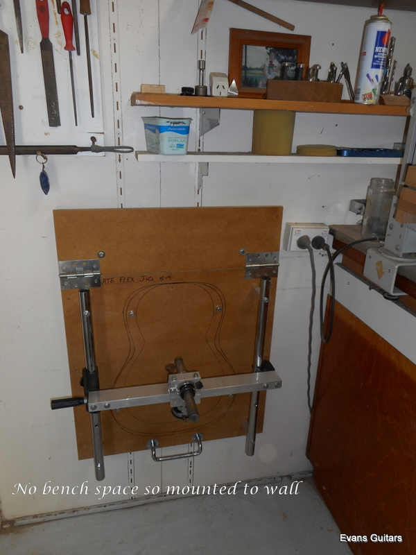

I also use it to test the flex in braces. As shown, it is hinged to the wall to create a safe space.
Cheers Taff

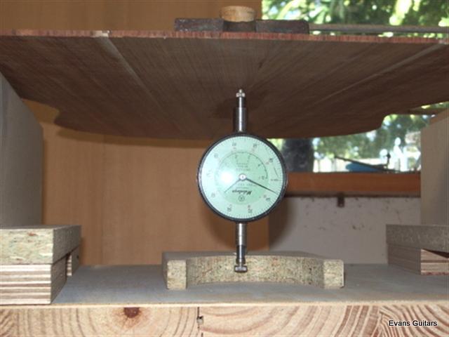

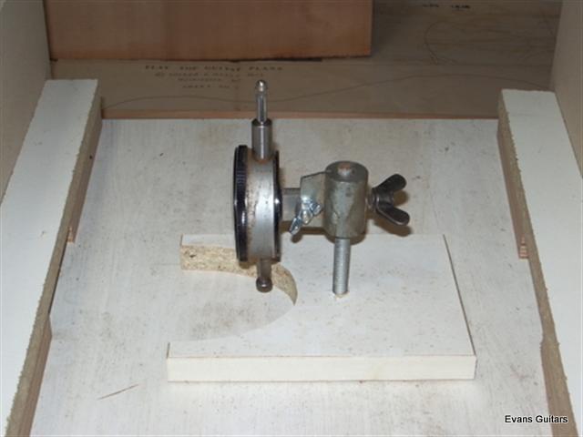

Hi again Tony. Ok you want simple, I can do simple too. This was an early model. It all folds down to a flat pack type looking thing thing.
