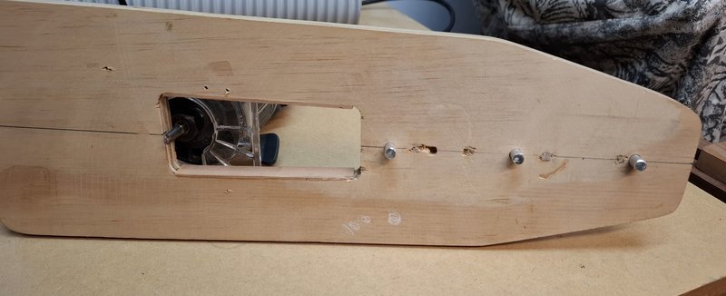

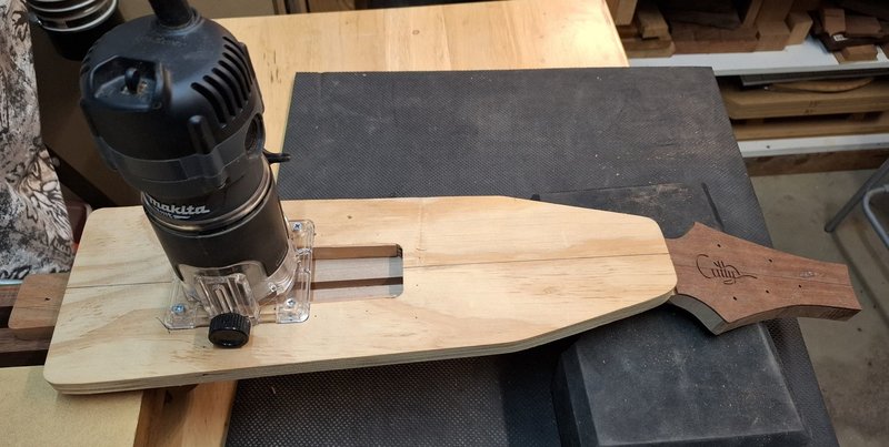

After struggling with understanding how 'the book' does it using a table router, and much head scratching, I repurposed the (failed) first version of the bobo mortise jig I made and mounted the router to it.
The pins in the jig locate it central in the existing slot in the neck to slide it along. I was even able to use it to extend the slot towards the head as I hadn't cut it long enough originally.

Thanks Cutty. That looks like a robust and reliable jig. Can you show how the router base fits into the cutout slot? What is it that registers on the insides of the cutout?

G'day Mark,

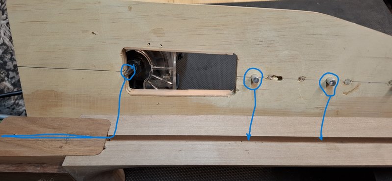

There are three aluminium pins on the base of the jig that are originally used to locate it centre on the existing truss rod channel when routing out the pocket for the bolt on neck extension.
In this iteration, those pins still sit inside the channel and stops any lateral movement, but the base can slide along the neck (i.e. left and right in the first picture).
The router base is screwed onto the platform on the opposite side from the pins so it is fixed in position. I did consider just drilling a hole in the centre line of the platform to put the router through but that wouldn't have fitted into the existing groove.
Not sure if the picture below explains it any better...

Ahhh, I get it now. The whole jig slides along the truss nod slot, and the router is screwed down to the wood plate. Nice.
