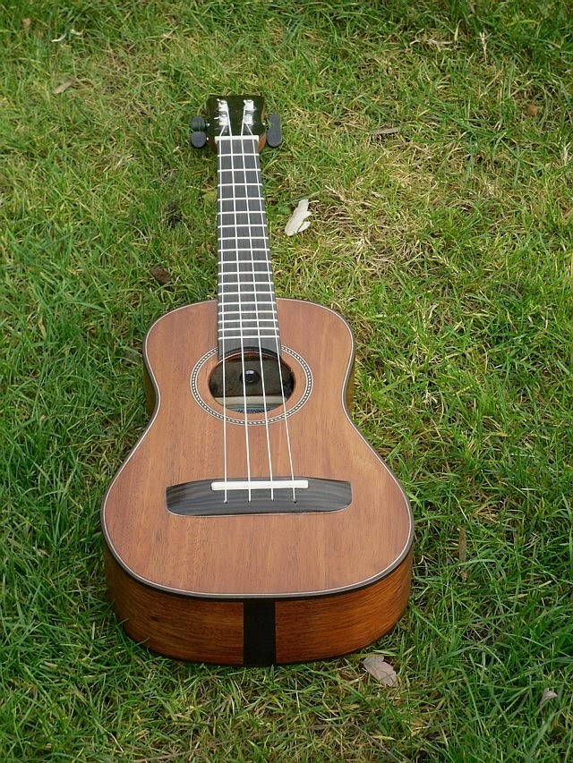

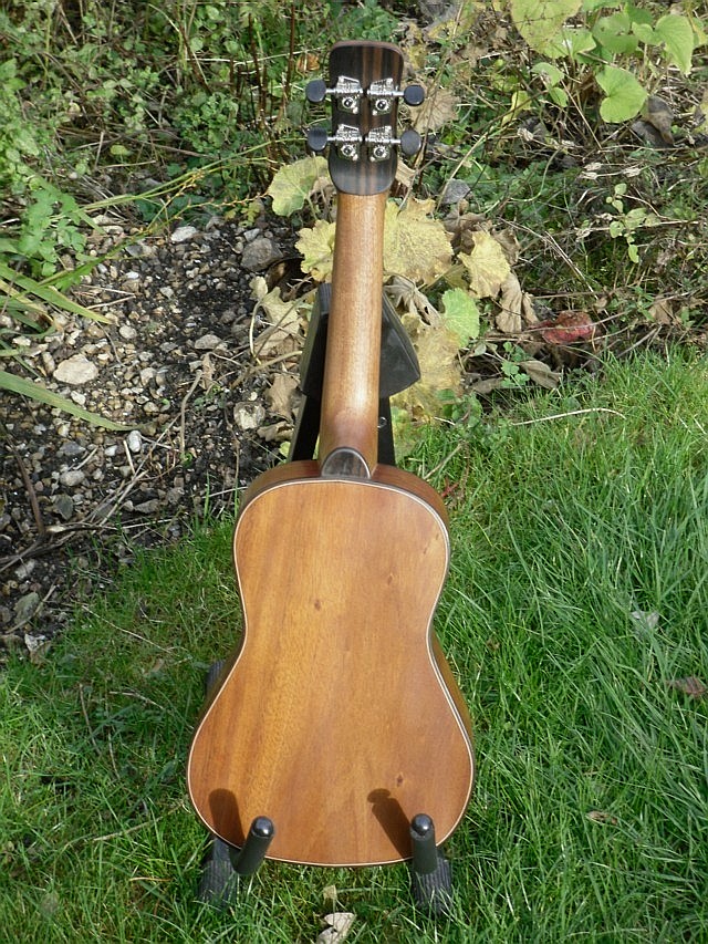

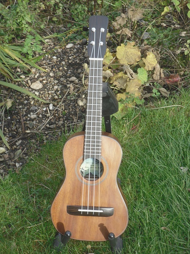

My eldest daughter Becky asked me to make a uke for her to give to her best friend as a Birthday present. So I looked through the scraps pile in the shed and three weeks later ended up with this Concert uke. He's called Merry to go with Pippin - the first Concert uke I made earlier this year. Top back and sides are Mahogany reclaimed from an Edwardian Bureau - the top and back are one piece and the sides aren't bookmatched . The neck is a scrap of Sapele with an ebony centre "truss rod" that was a fingerboard off-cut. The fingerboard, headstock veneers, bridge and heel cap are Macassar ebony offcuts, the binding and end-graft some Old Rio Rosewood off-cuts and the braces Euro spruce brace trimmings. The only "bought" parts are Gotoh ukulele tuners (re-fitted with Stew Mac ebony buttons), Aquila nylgut strings, the bone saddle (the bone nut was a reject from a larger instrument) and the black/pear/black purfling and rope purfling (used in the rosette). The finish is hand rubbed pre-catalysed lacquer over Z-Poxy apart from the neck shaft which is Tru-oil over the Birchwood Casey Sealer/Filler. The neck is a single bolt M/T and there are carbon fibre flying buttress braces (offcuts again). There is a page here on my website showing the build. The main difference from Pippin is the shape (this is how Pippin should have looked ) and a single saddle slot that intonates much better than the "fancy pants" split saddle I did on Pippin.
Here's some pictures:

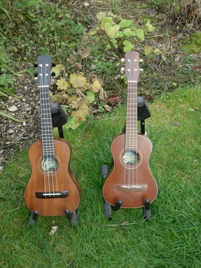

And here's Merry and Pippin together:

Ok, sites back up and you didn't disappoint Mr White. Interesting "aerodynamically designed" bridge on them both, don't let NASA see them Do you find it gives them a different sound from the 'normal' ukes? It sounds a little 'fuller' but then that could be the sound that size is meant to make? I know bugger all about ukes.....but I'm learning!
