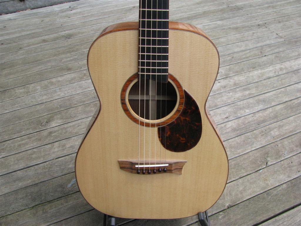

Finished the final setup on this today and it's new owner came and took it home.

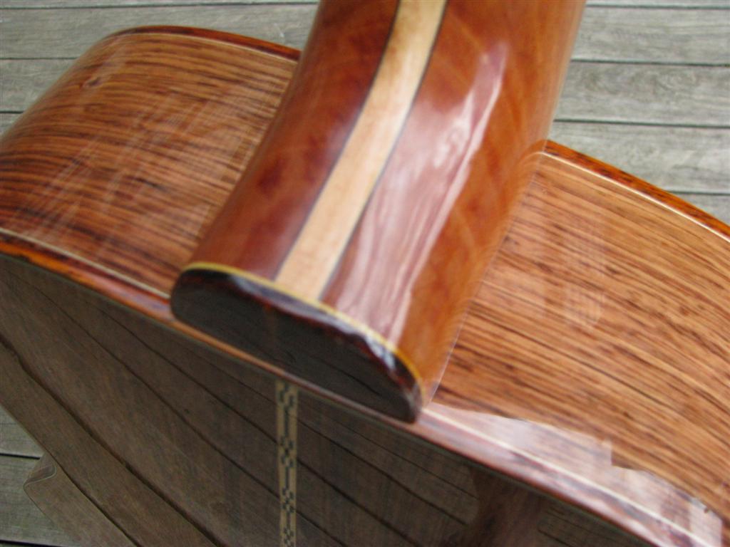

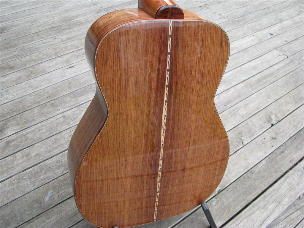

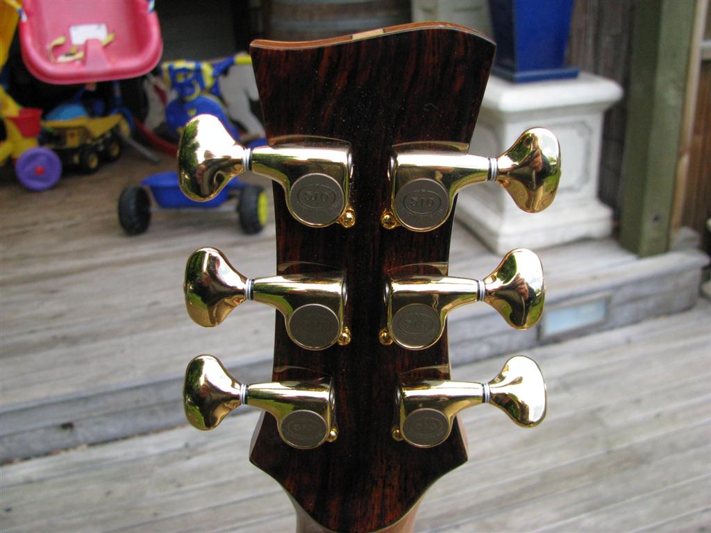

It's a Honduran Rosewood 0-18 with a Lutz Spruce top from Shane Neifer, Cocobolo bindings, rosette, head plate and back strap. The neck is Fijian grown Honduras Mahogany, fingerboard is Ebony with Evo frets and Gotoh 510 tuners.

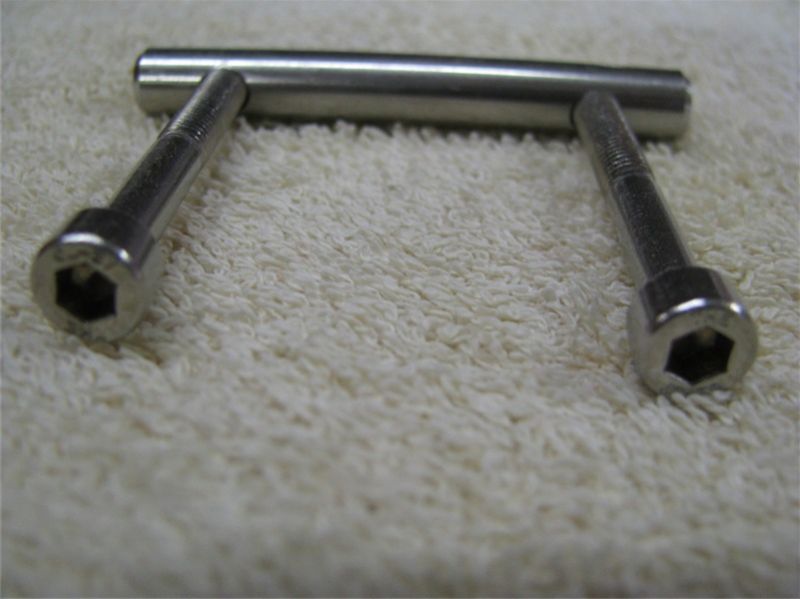

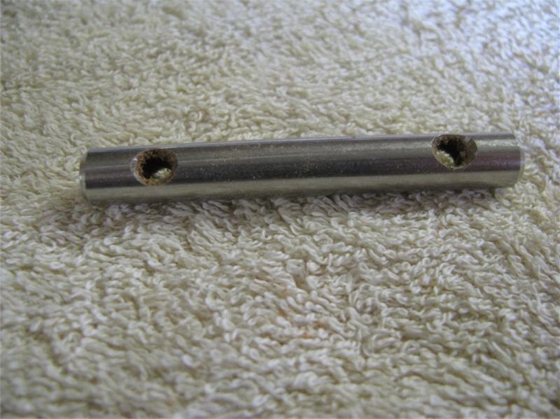

The guitar has double sides (the inner is blackwood), lattice bracing in the lower bout (3mm x 5mm) and a new (for me) neck attachment system which is a stainless steel bar in the heel of the neck to which stainless hex bolts are screwed (see pic below)
It sounds great. Tony commented when he first pick it up that it felt like it had the power of a dready. It has lots of sustain and I reckon it'll sound great once it's played in a bit. I would say I've only played it for about half an hour.

This is the neck attachment system. The steel bar sits vertically in the heel of the neck

Once again a display of great craftsmanship Bob. What is the finished side thickness and when you say lattice in the lower bout do you mean the same style as the King Billy top?
Re: Honduran Rosewood/Lutz Spruce 0-18
Post by Bob Connor » Wed Nov 03, 2010 6:17 pm
That's right Jim.
The same treatment as the King Billy top.
I took this one down to 2.4mm so I'll be interested to see what the top does over the next month. If it stays put I can probably go thinner on the next one.
The sides are bloody thick. I left them both at around .070" so it'd be about .150".
I intend to go thinner on the next one with both pieces of the laminate at around .040" - just to lighten things up a bit.

Another fine looking instrument, Bob. It looks good all the way from Arkansas! I really like the shape of your bridge.
