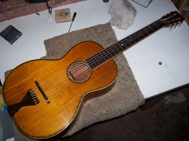

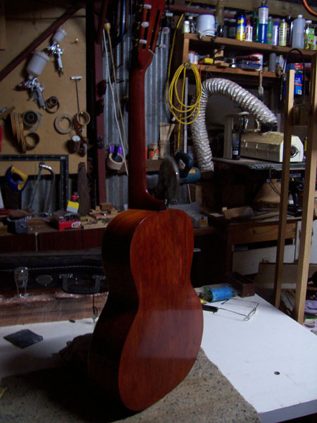

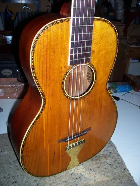

The gallery seemed a good place for this, not because it is hand made but just cause it is still kicking around today. I bought this one about a year ago on Ebay and have recently finished it, sort of. It came to me unoriginal, no tuners and no bridge, the heel was stuffed and there were three cracks in the front and 4 on the back (make that 6, two more opened up in the back after the first four were repaired, I wanted to hear the thing so I spayed it anyway and will get back to it another time). It is ladder braced job with one bridge brace perpendicular to the neck and another just below the sound hole at a angle leaving a bit more wood below it on the low E side and less on the high. It has been re-sprayed with gloss pre-cat that I just sanded down to one of those white scourer type pads to give it a look or age. All I can find out about it is that it appears in a 1928 Montgomery ward catalogue and my best guess of the maker is Stromberg Voisinet judging from the time it was made the bracing and especially the binding marquetry but it's a guess. As you can see by the repairs to the front, on old stuff like this I like to make the repairs sound but obvious, part of its provenance. If you were in the market for a guitar in 1928 you could of had this one for $5.45US brand new.
Top. red spruce I think
B and S. birch
Neck. poplar
Fret board. pear
The tail piece was rusty as, so I made a new brass one

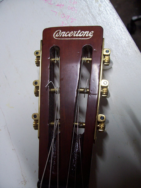

This is the only form of identification on it.
