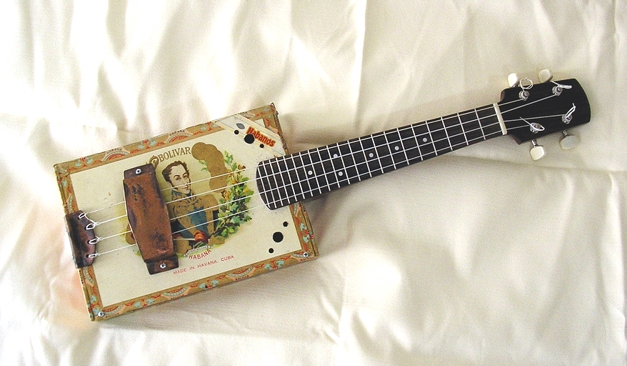

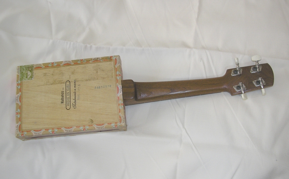

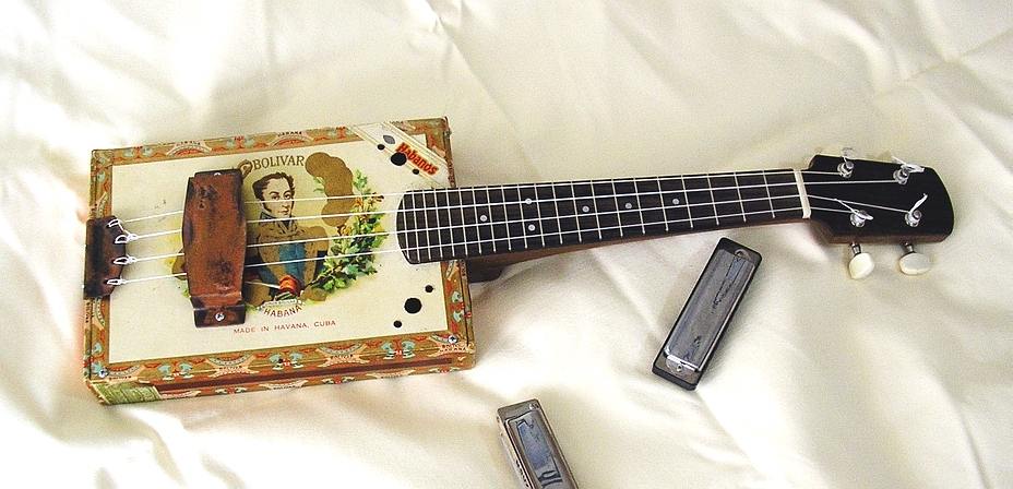

My latest quirky instrument hope it brings every one a smile :)
The Cigar Box Sardine Tin Resonator Ukulele
This little blues machine features
Funky Cuban Cigar Box.
Norwegian sardine tin found in a paddock very old, special alloys for improved tone
Black Bean neck recycled from a cabinet.
Fret board and head plate Rosewood
Copper tail/and bridge cover.
Tuners off an old Japan made (Canora) Baritone ukulele.
The bridge is Vic Ash with rosewood tip.
Scale is 14" low G concert strings.
Very happy with tone considering just strung it up Aquila strings take awhile to sound there best I reckon. I shall record a sound sample latter in the week. Thanks for looking.

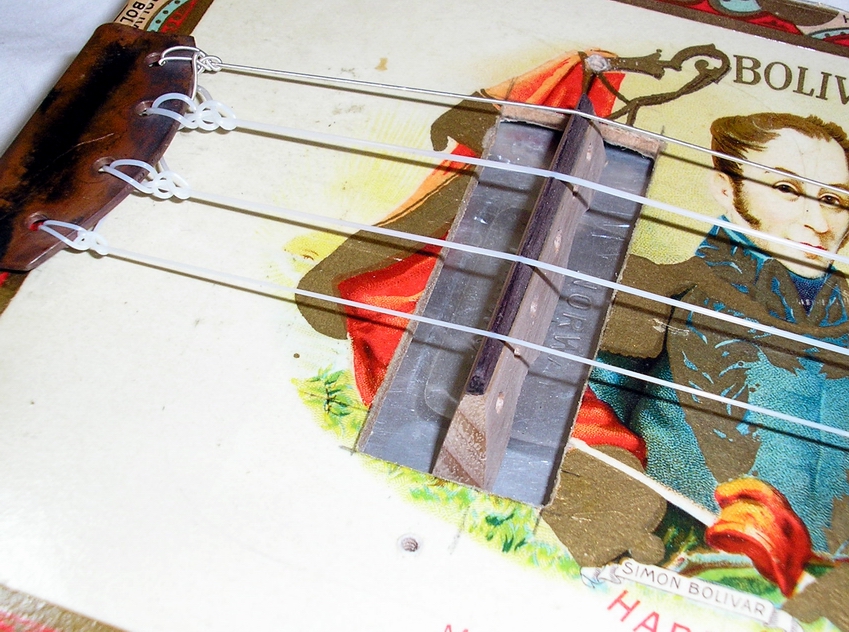

I want to see the guts, the resonator/bridge coupling. C'mon you're hiding the magic. :D

Hi John and others the sardine tin is inside acting like a traditional resonator cone like in a National guitar.
It sits on a little frame inside the box all very simple.
