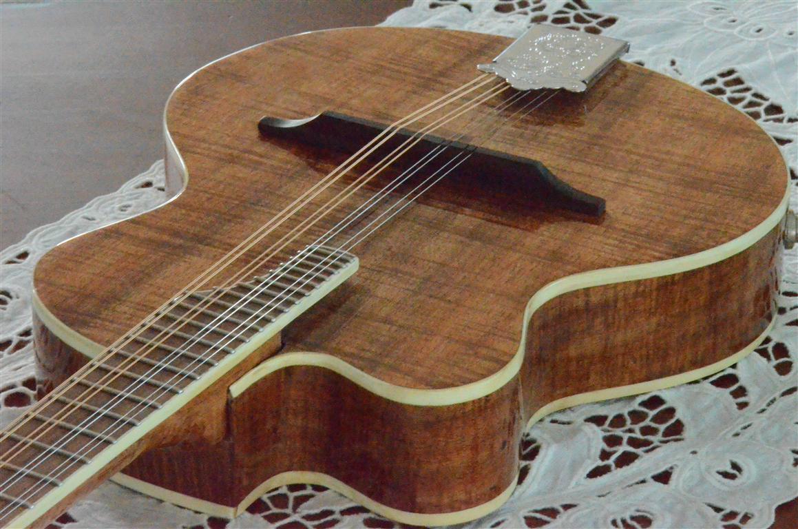

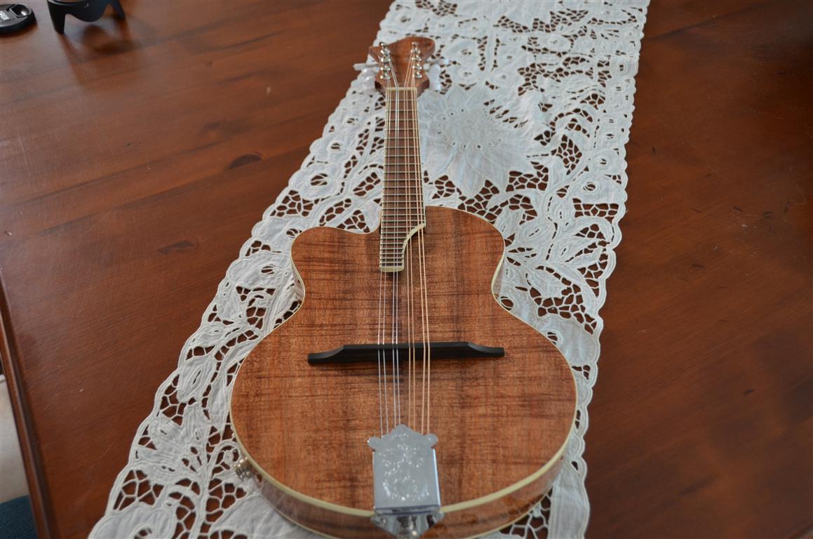

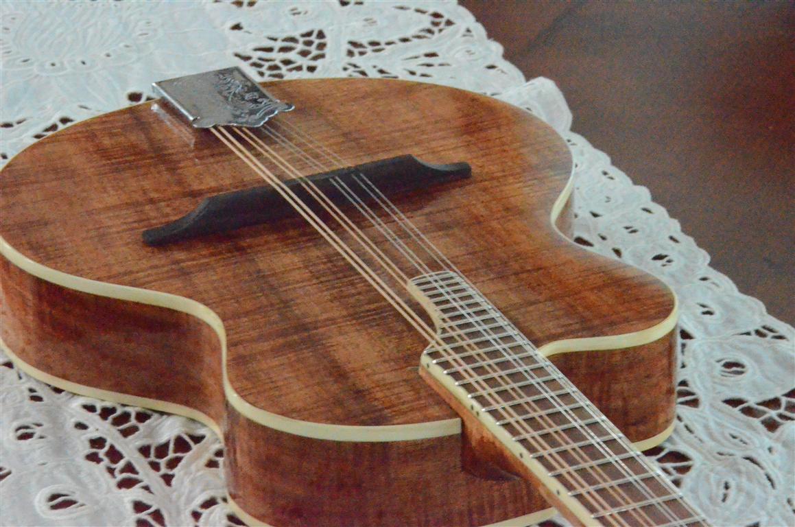

Finished this one today.
All Blackwood acoustic mando with a K & K pickup - no soundhole.
However it's almost as loud as my Ray Black F-model.
And yes it is left handed.

Allen the bracing is just an X-brace 12mm x 6mm. Top and back are both flat.
This is the second such beast I've built. I did a prototype with an Engelmann top but it fed back on stage at reasonable volumes so this one has the Blackwood to try and get more volume before feedback.

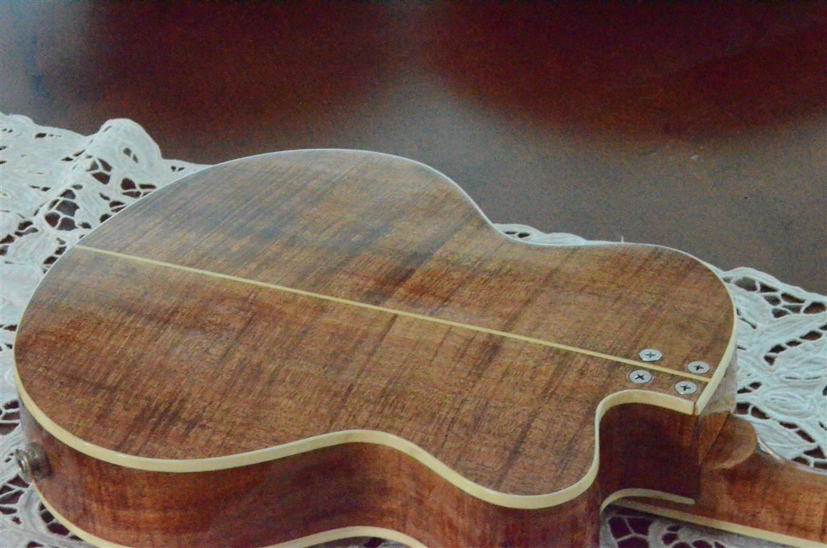

The back of it has a 2" x 1/2" lump of Blackwood glued down the centre to take the back out of play so this is purely for stage use.
You may remember that I started a guitar for the same reason. Again I didn't like the Spruce top on it so I routed it off and it's waiting to get a Blackwood top as well.
I sort of like the look of the long bridge Craig. It's a bit like the bridges on the Macceferi. Because the acoustic properties of this instrument aren't my main consideration I felt i could afford to stretch things a bit
I cheated on the binding and used ivoroid
