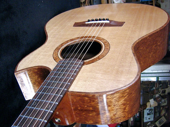

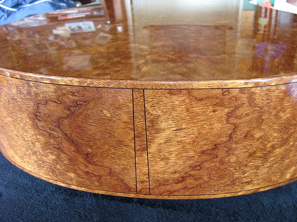

Hi Craig
That is one lovely guitar and your detail work is immaculate.
A couple of questions if you don't mind.
1. How did you do the end graft so the grain pattern matches with the sides?
2. Is the mahogany sound hole edging integral with the sound hole reinforcement or inlaid separately?

Re: Adjustable guitar complete
Rod , Markus, ,Bob ,Colin and Bruce. Always means a lot to me getting compliments from those that share a similar passion ,, or should I say obsession. Many thanks guys and much appreciated.
That ,and have the Graft blend in kind of seamlessly. Colin , I played around with a side panel off- cut until I felt I had a match. I kind of booked matched the binding too !Here's a different shot of it :
To answer you second question Colin regarding the soundhole binding . No, nothing to do with integral soundhole reinforcement , although it probably does offer some reinforcement . It's a binding of the same Mahogany and the same thickness as the soundboard . Worked out really well and I like the look a whole lot. A bit of mucking around , particularly because of the wood being a Mahogany Type as well as being Pommele figured. Makes for a bending challenge .
My aim with that end graft was to confuse other guitar builders !afshar wrote:Hi Craig

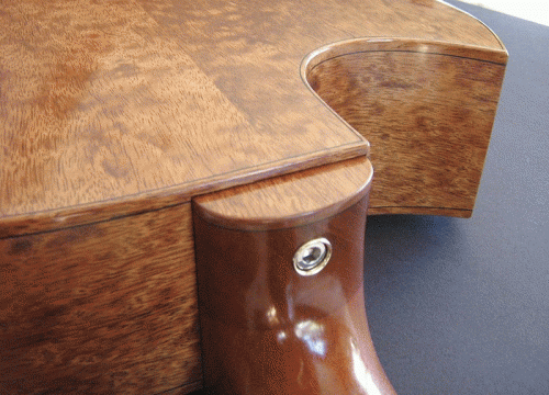

Pictured, the flush mount (stainless steel) adjuster along with the alternate Strap pin adjuster.

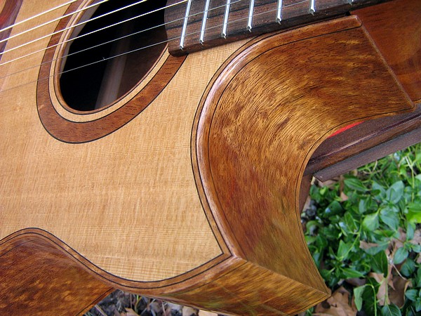

Nice mitre mate!Craig wrote:The unbound florentine cutaway mitre was achieved by stacking both the side and cutaway pieces on a shooting board ( as you would do plate joining ) I used a block plane which I had set on the correct angle to suit . (This was done prior to bending of course ) This picture taken prior to binding and finish
I presume your using a donkey's ear jig on your shooting board or something similar?
What do you mean by setting the the block plane angle?
Mike
Apologies for near fritzing your brain with the gif pic Nick
Thanks and much appreciated Craig
I used a shim on the side of my block plane to get the correct angle .H3ytm@n wrote:
Nice mitre mate!
Craig Lawrence

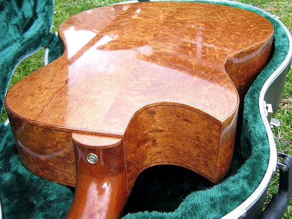

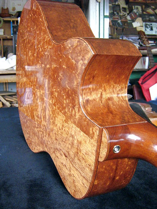

G'day Jeff,`
The neck has a mortise and tenon to line it up to the body and cutaway.
The headblock is flush to the width of the neck on the cutaway side . The bent side panel gets glued to the headblock and overlaps by 5 mm. The 5 mm. being the depth of the pocket the neck sits in. Hope you can understand that description.
Here's a big tip : When carving the neck ,leave the treble side of the heel a little wider than it should be . After you have the body complete, insert the neck's tenon as far as it will go ,and scribe a line from the cutaway edge onto the back of the oversized heel . Take the neck out and scribe another line parallel to that line but narrower by the thickness of the side panel ( in my case 2 mm. )Trim off the heel exactly to that line with a chisel
This should give you a really good fit between the neck and body/cutaway with no horrid gap.
The bass side of the neck is different in that I finish it completely ( to finished width ) and scribe a line off it onto the side of the guitar which will become the neck pocket ( 5 mm. deep ) .
Hoping your following this Jeff , but if I haven't made myself clear please ask again. A picture being worth a thousand words
