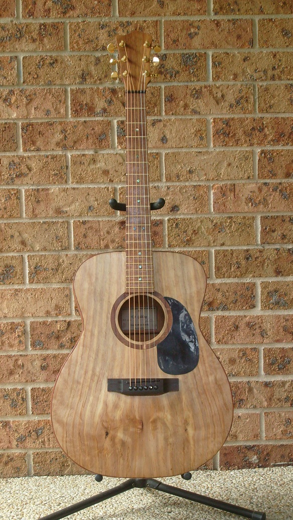

I built this guitar for my son, but it was also an experiment in the use of Bunya as a soundboard.I hadn't heard many bunya topped guitars that I liked,most lacked volume and projection.with this one I took the top down to 2.2mm and X braced it as I would with a more traditional top, it has worked, great tone, even response and volume across all strings and good projection. If I have learnt anything from this, it is that bunya tops need to be taken down a little more than most species,but I need to get a setup to check accurately the deflection,before making any conclusions.
And improving my joinery skills :D
Specs
Tasmanian Blackwood Back and Sides
Bunya Soundboard
Braces and neck Australian Red Cedar
Fretboard and headplate Sally Wattle
Machines Grover Rotomatics
Scale length 25.4"

This top surely is an eye-catcher! :D
Nice background too, great colour-match with the guitar. 8)
