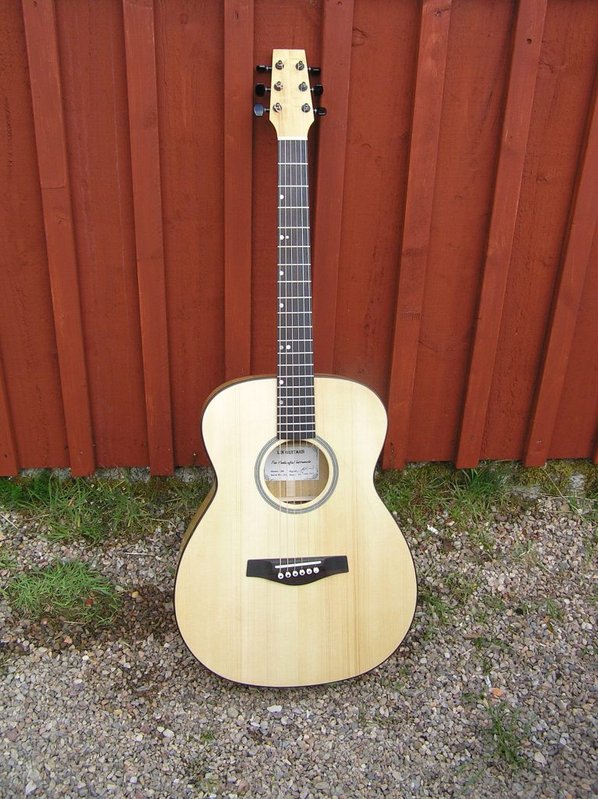

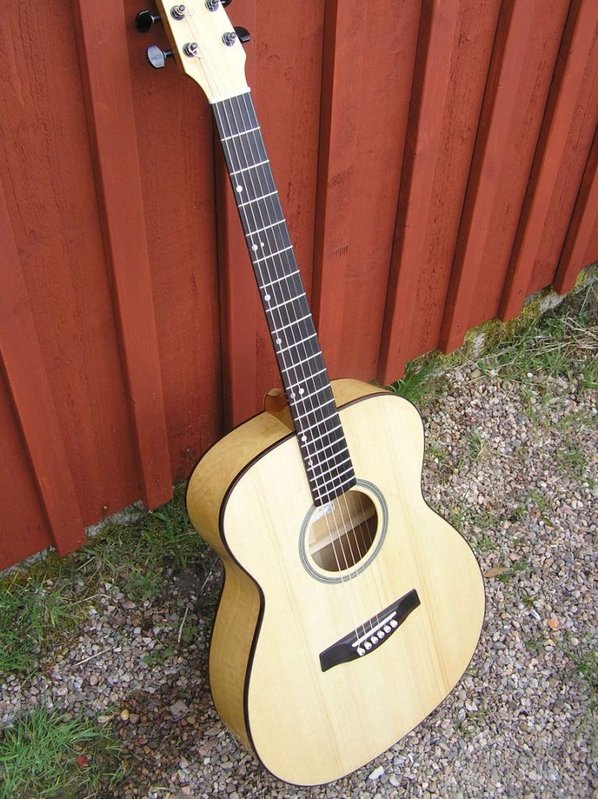

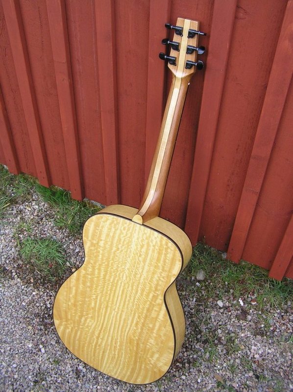

Just thought I'd let you gays have a gander at my third build.
OM, Satinwood/German Spruce with EIR binding and fingerboard, BRW bridge.
Neck is Honduran Mahogany, Wenge veneer and (Rock?) Maple, salvaged from a bowling alley refurbishment.
Finish Tru-oil.
All woods and tuner colours were chosen by the (well happy) new owner.
Thanks for looking.
Finish Tru-oil.
Thanks for looking.

That's very nice Colin, I have just finished my 3rd, that was also built for a friend
Workmanship looks exceptional , very blond , but then they say"blonds have more fun".
Yes I like that
How does it sound ?
Yes I like that
How does it sound ?

Thanks Todd.
It sounds, well, like an OM ( I used the Kinkead book) I suppose, not to shabby. Reasonable for both pickin'n strumming.
I'm not a great fan of light coloured guitars in general, but this Satinwood stuff is dense and stiff.
The set rang about as good as the EIR i used for a build I did at the same time.
When first finished, I thought this one was slightly better, but as the EIR "played in" for about 6 months it opened up a lot.
The owner of this is a beginner, and doesn't play it that much.

Colin, are you planning a pickguard for this guitar ?
I only ask because a spruce top with tru oil I would think would be very easily damaged by a hard strumming long fingernailed player like myself or even pick
I have a WRC topped guitar finished with a tung oil that is very easily damaged.

Todd, there is a clear pickguard fitted, I like them because they don't hide the wood. I can just see it in the first pic.
