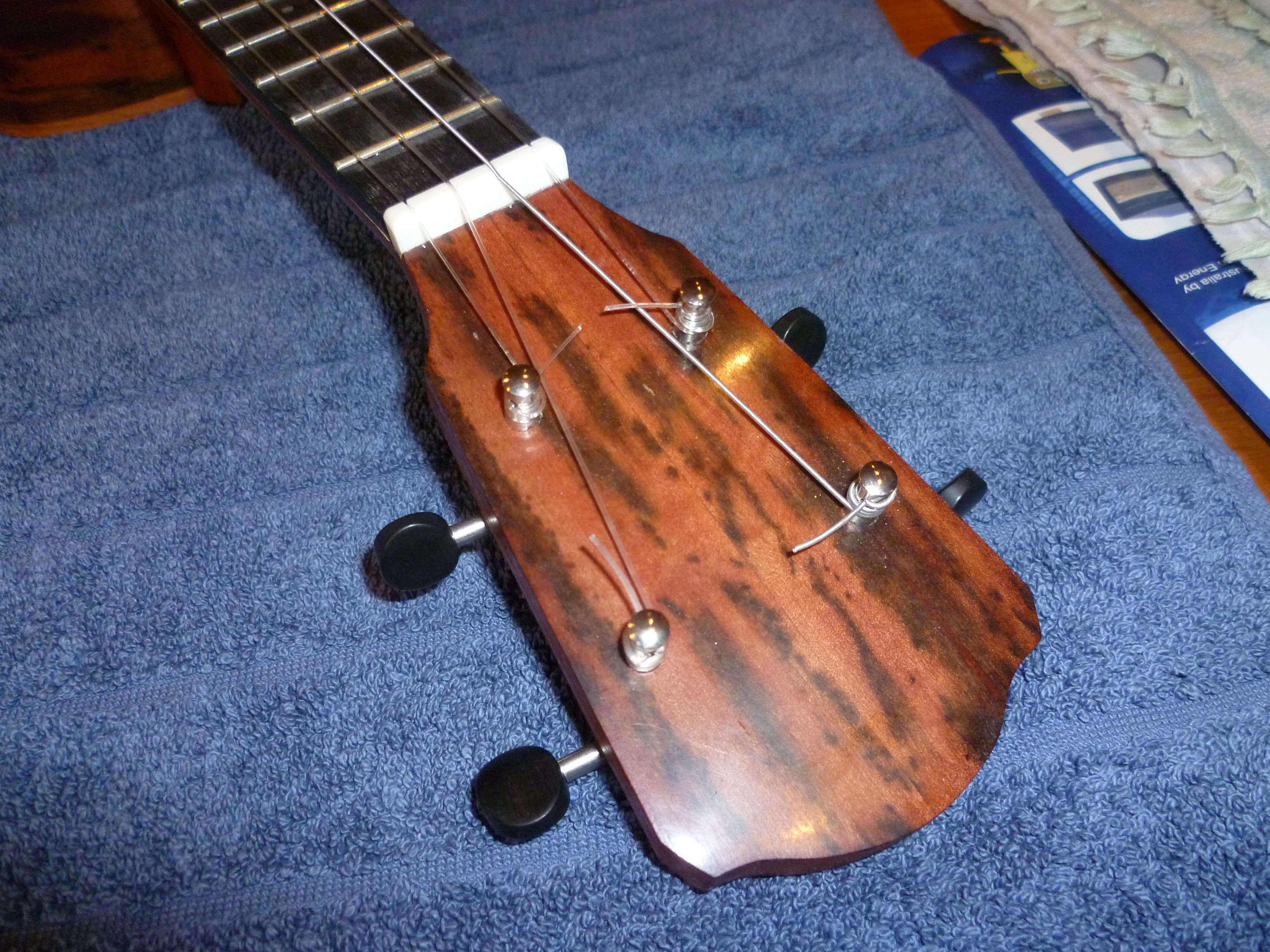

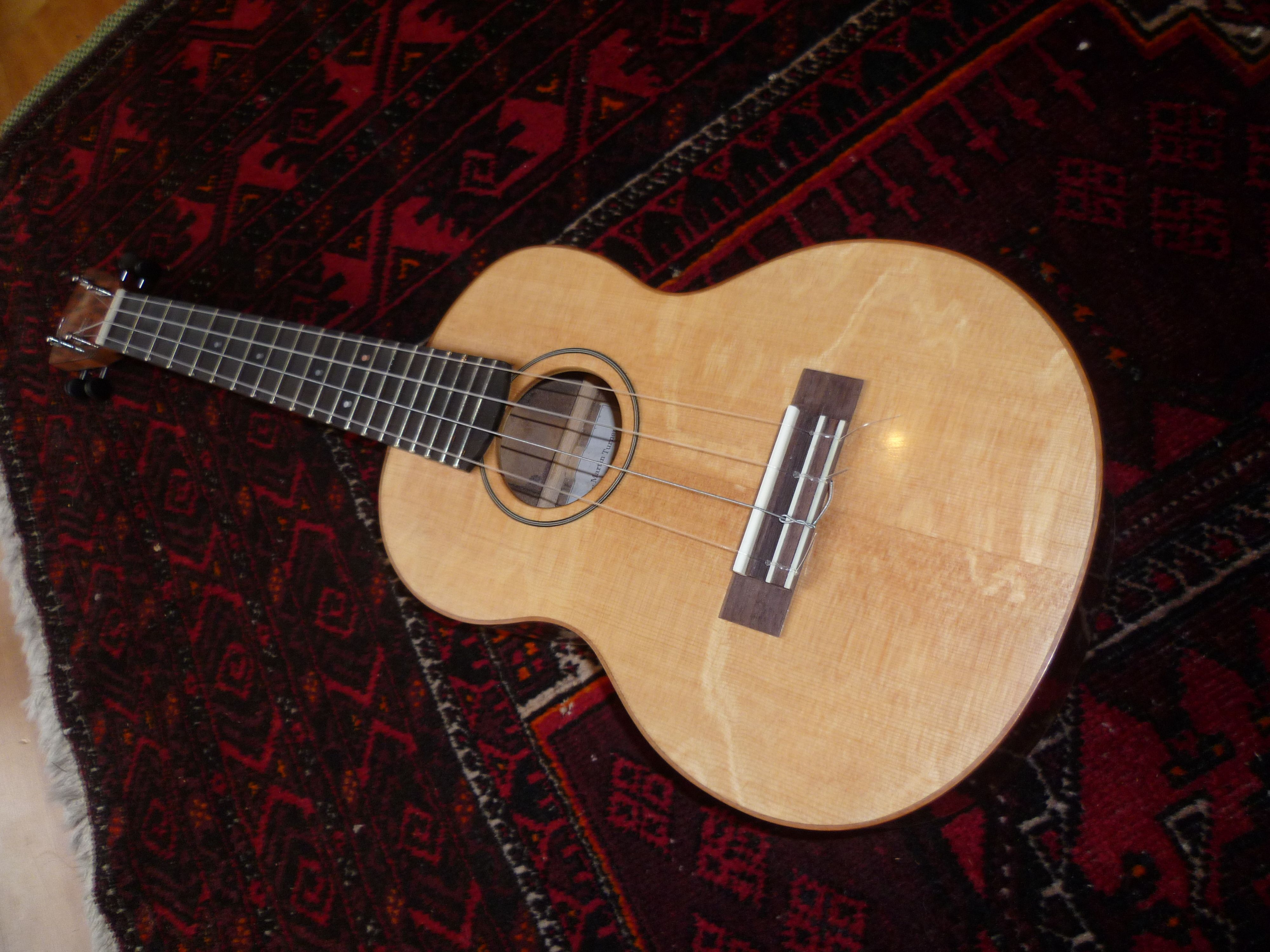

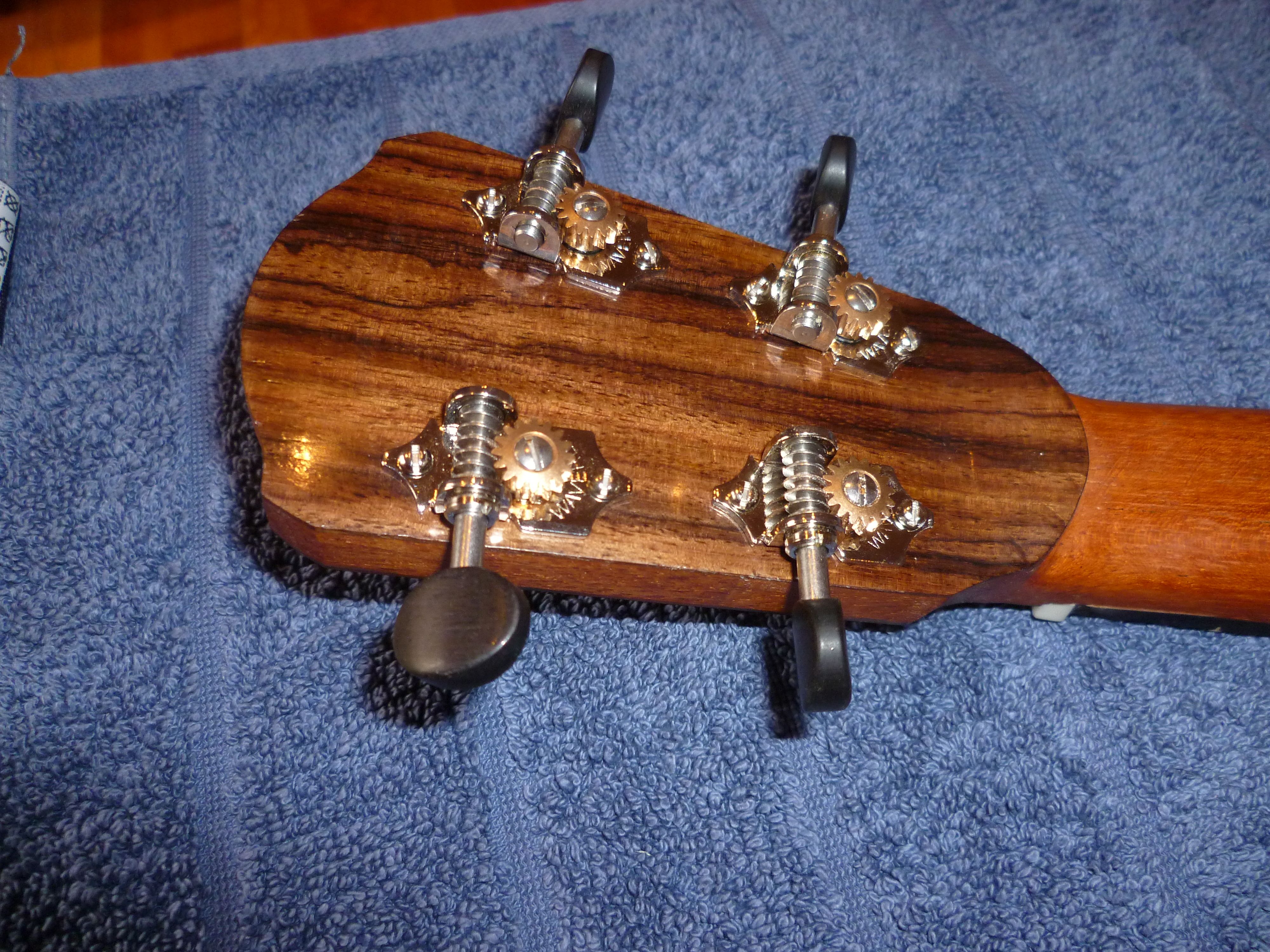

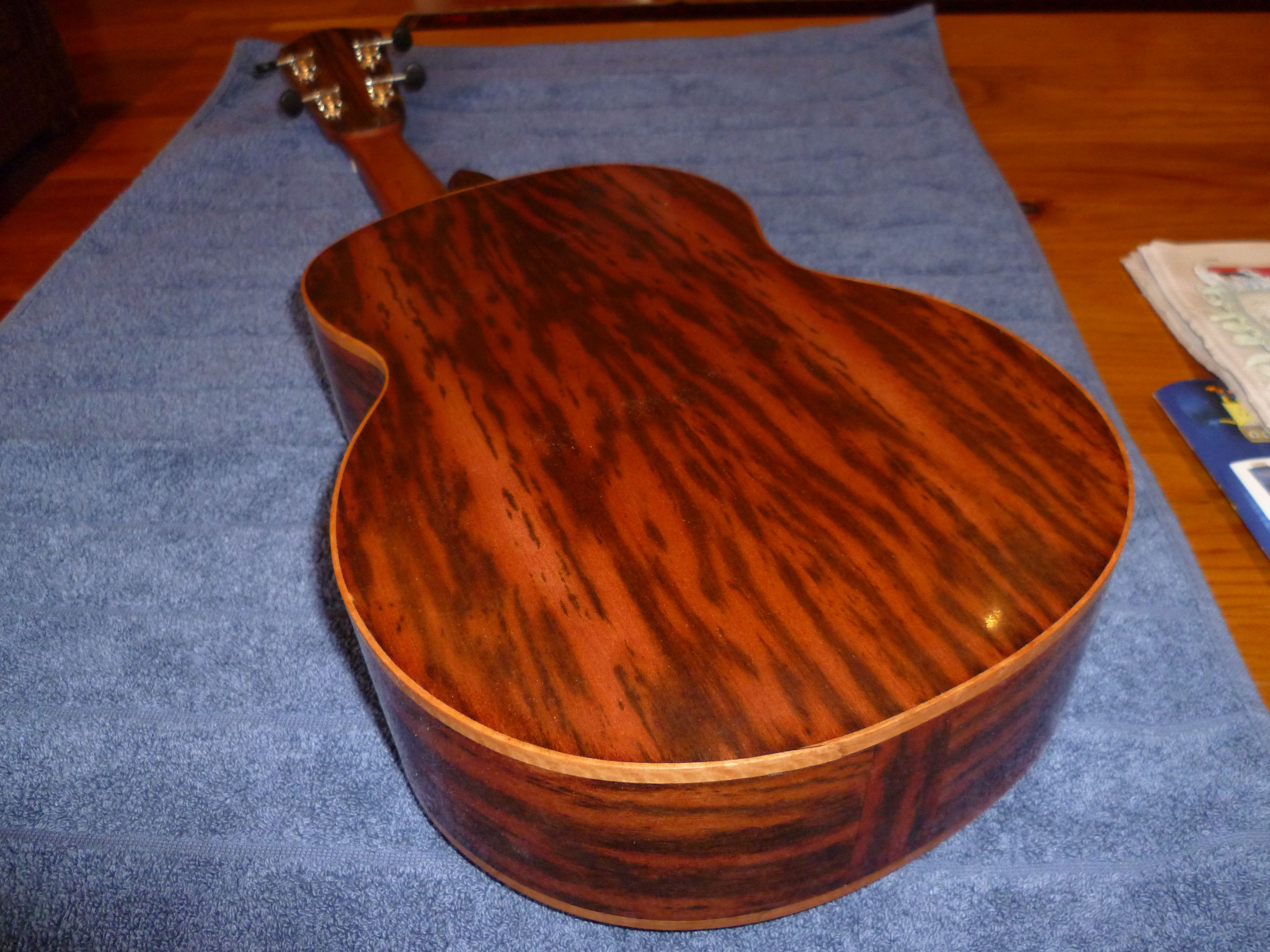

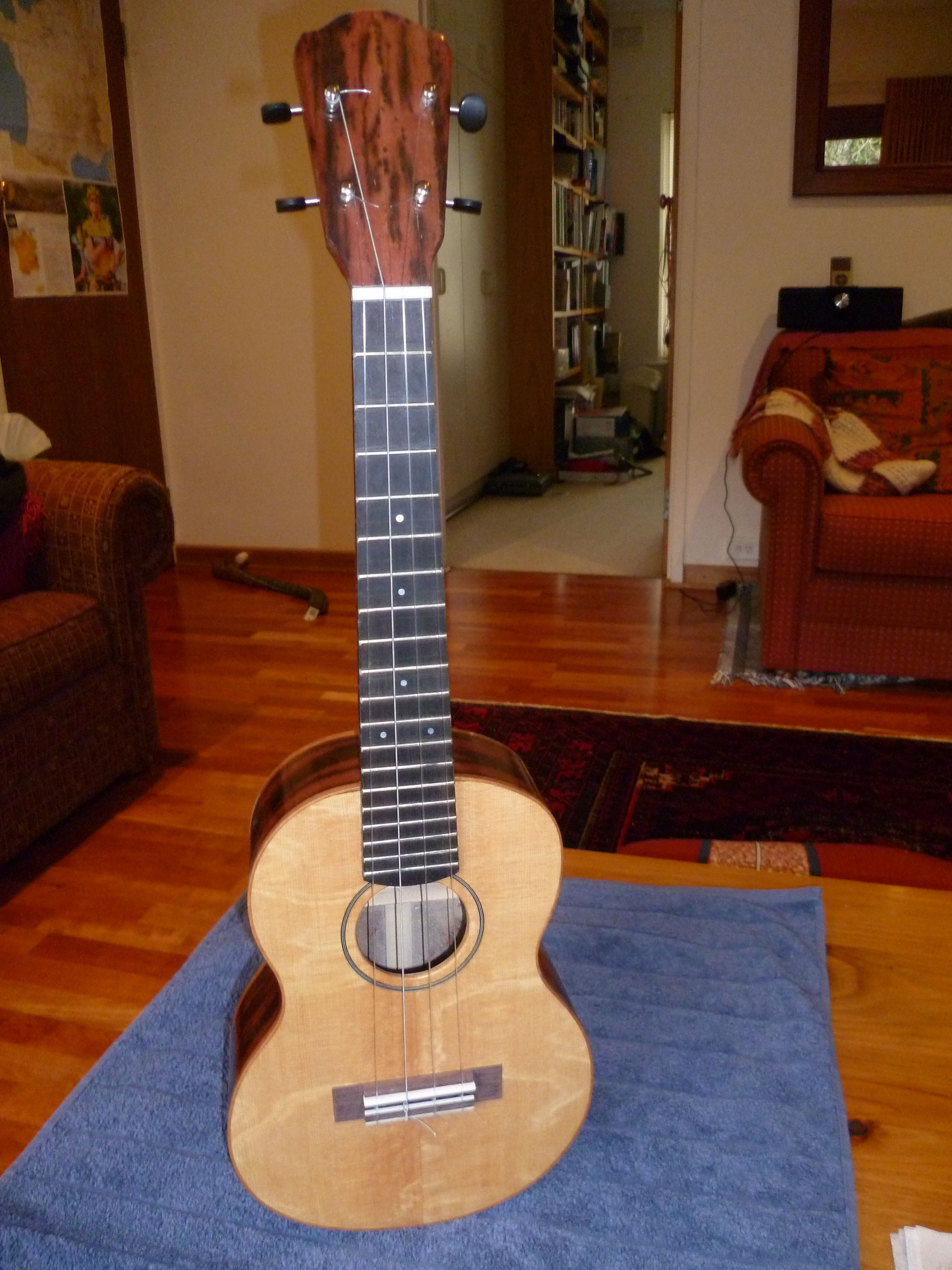

Well at long last my first uke is finished.
Back and sides: Tiger Myrtle from Tim.
Top: Bearclaw sitka from Tim
Neck: Honduras mahogany
Headstock backstrap: Indian Rosewood.
Bridge: Indian Rosewood.
Finish: French Polish (LMI blonde)
Tuners: Waverlies
Strings: La Bella.
Construction was using the spanish method.

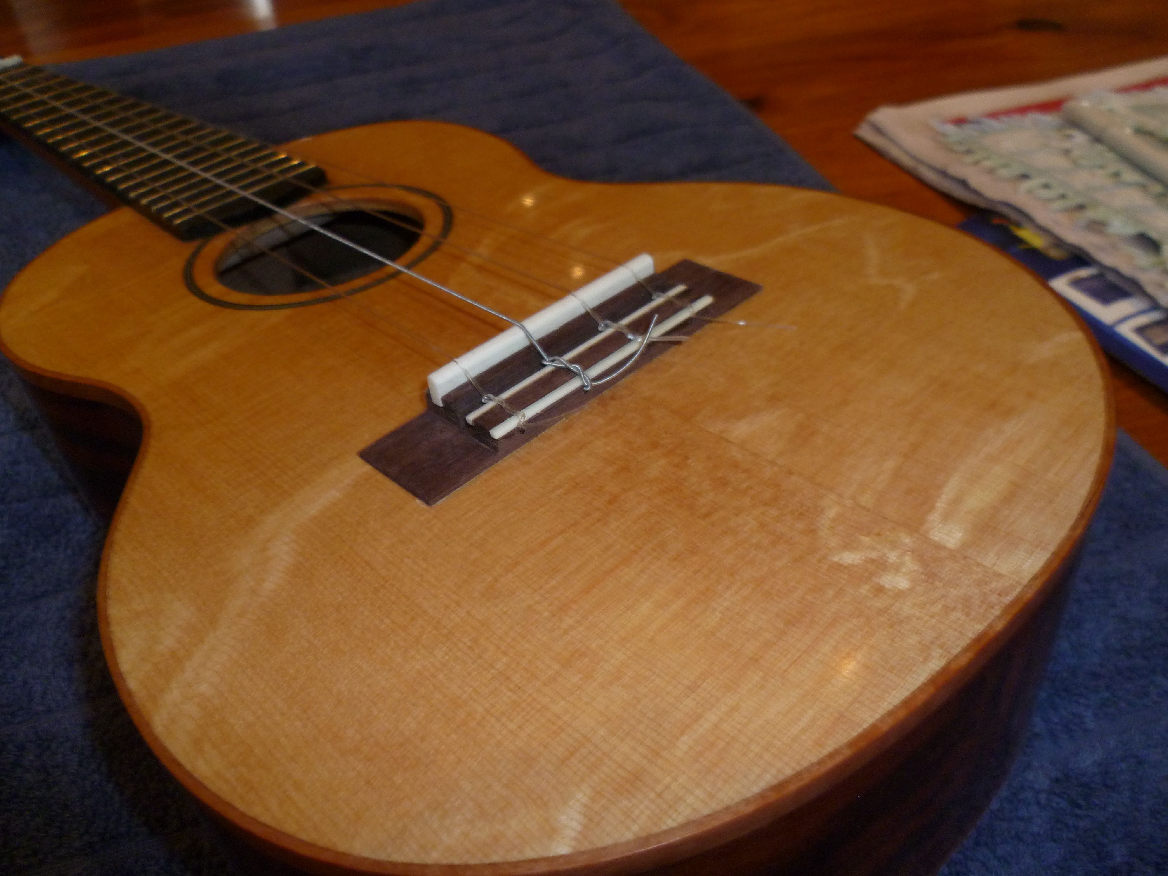

Nice job Martin, very clean & tidy :cl :cl Your Sister's going to be one happy plonker :D
Forgive me but is that the grain of the binding near the tail of the rear or a splice? & how did you get your hands on a bit of Honduran Mahogany? Was that purchased pre restrictions? Seems Sapele is about the only mahogany-ish style timber you can buy nowadays! :(

That's the splice you can see in the binding.....it shouldn't be so visible. Not sure what the binding is..its been sitting around the shop for years.
The hog I bought off Gerard Gilet when I first started stocking the shelves with wood. I had a steel string neck Id stuffed up so recycled it for the uke.

Is the body outline your own design or did you scale down a guitar shape? To me it looks very pleasing and a bit uncommon for a ukulele. The bridge position seems to be somewhere between the ones on classical and steel string guitars.
All in all, well done! :cl

I worked off a Hana Lima plan but worked up my own bridge based on the bridges I use on my classicals and some of Jeremy's instruments.

Top string is buzzy........nut is ok so will look at top of saddle tomorrow.

This is the first uke Ive made....and also the first time Ive ever sat down and played a uke for any length of time. At this stage all I can say is...it sounds like a uke. Volume is ok but I suspect the back and sides could have been made a bit thinner and more "live".
