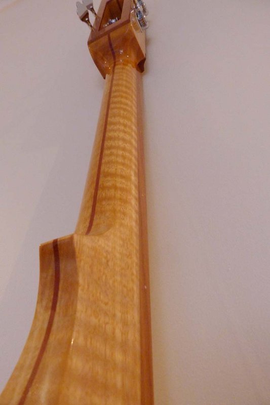

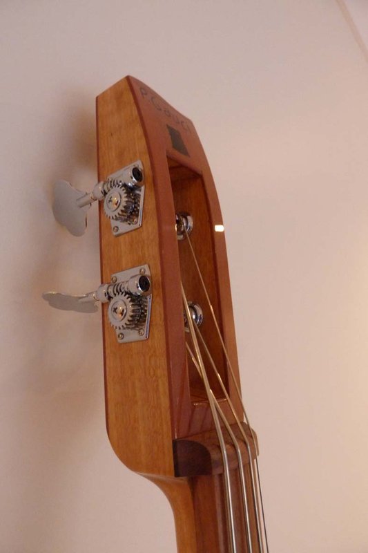

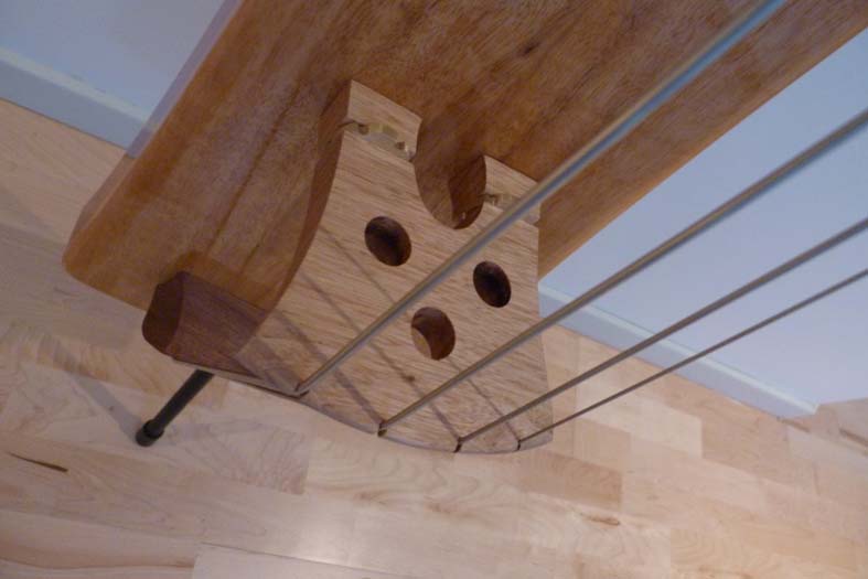

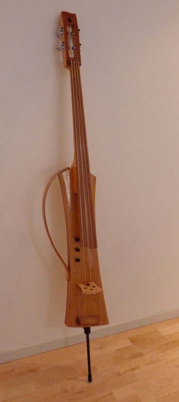

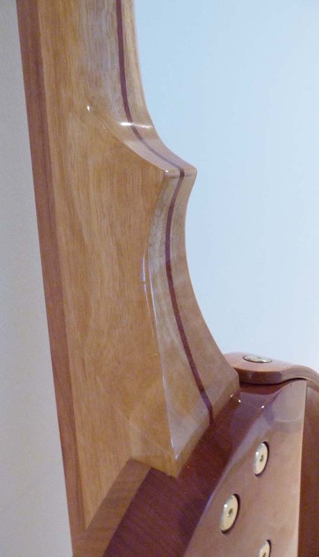

hi - recently finished a 3/4 size electric upright bass for my son. Specs are:
- 1051mm scale length
- tas myrtle body (kind of hollowed) with a vic ash cap.
- neck is vic ash with a jarrah strip
- fingerboard and tailpiece are grey ironbark
- bridge is vic ash
- tuners from stewmac
- 2 piezo discs on the tailpiece side of the bridge -> volume, tone and blender controls -> homemade tillman preamp http://www.till.com/articles/GuitarPreamp/
Got the idea of the piezos from here viewtopic.php?f=1&t=3371&p=41066&hilit= ... scs#p41059
Many thanks to Bill Paulin for your help and great construction pics on the ozbassforum http://www.ozbassforum.com/viewtopic.php?f=27&t=1484 Spent lots of time examining those pics.
Don't have sound clip yet as I need to replace one the strings that got damaged. But here's some pics for now.
Paul

Nice.....I like the lines of this, well done Paul, I'm sure your son loves it!

A thing of beauty, Paul.

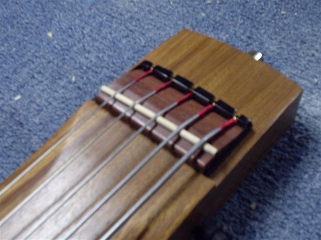

Hi, I like that, looks like a fun build. I built one for a mate some years ago and enjoyed the challenge of treading new ground, it was a five string.

Very nice Paul,
I like your body rest solution and introducing a curve to the body. Hard to do on a long narrow shape. Most try for a recurve and the body isn't wide enough for that to work. :cl

Taffy Evans wrote:Hi, I like that, looks like a fun build. I built one for a mate some years ago and enjoyed the challenge of treading new ground, it was a five string.
Taffy,
What scale length and did you get much out put from the B string? I built one as well and wasn't happy with the B.
Posts: 1066
Re: Electric upright bass
Post by Taffy Evans » Tue Sep 25, 2012 5:31 pm
Hi Bill, the bass had a good even response from all strings, possible due to the modified electric bass bridge I used, see pic.
P2070021 (Small).JPG (48.13 KiB) Viewed 15055 times
Posts: 1066
Post by Taffy Evans » Tue Sep 25, 2012 5:32 pm
oops, sorry 34" scale length.
