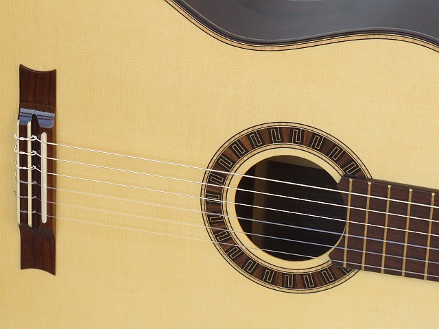

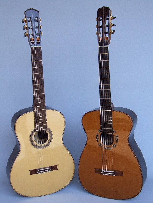

Here's a couple of classicals for your viewing entertainment:
The Engelmann one I finished a few weeks back; just finished the cedar neo-classical.
The purflings are curly maple. The tiles in the rosette are rosewood from the sides and fretboard off-cuts.

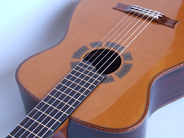

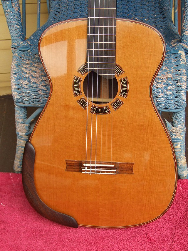

Cedar Neo.jpg (100.9 KiB) Viewed 22564 times

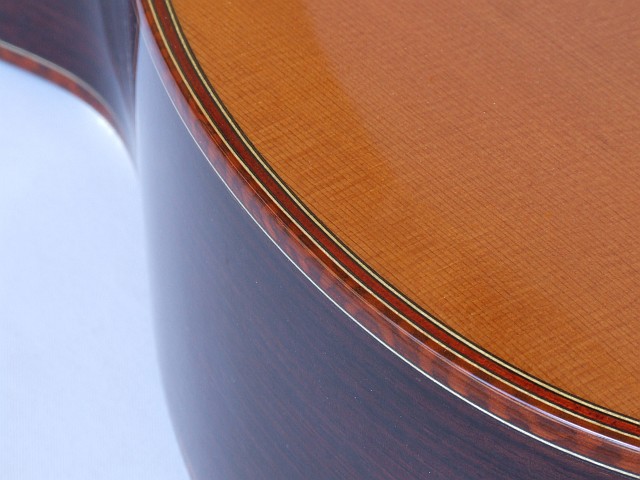

The cedar one has bloodwood purfling and snakewood bindings....
Snakey Binding.jpg (65.03 KiB) Viewed 22564 times
... and a magnetic armrest (requested by its new owner who tells me that N. Qld is hot...)

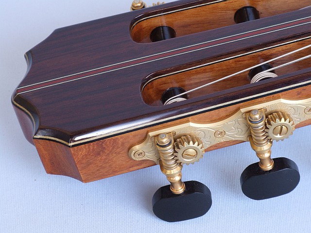

And here's a shot of the headstock:
For both, the finish is nitro on the B&S (EIR) and hard shellac on the soundboards.

What bracing have these two been built with? I'll assume Falcate given the bridge design, but you may carry that into other bracing patterns too - I'm not sure.
So how do they sound? It's a given you hit your target frequencies on each, so how do they compare to each other?
Considering your previous issues with oil on bridges, what did you use on this occasion? Shellac? They are very shiny.
Finally, I assume you countersunk some rare earth magnets in the linings and/or inside sides. Does your armrest continue down the side edge a little as well? Did you notice any discernible effect on the frequencies with the arm rest installed and not installed?

J.F. Custom wrote:So how do they sound?
The cedar is a 190Hz guitar, the spruce a 200Hz. So the cedar has a slightly darker tonality. The thing I'd comment on though is the tonal pliability. It's quite easy to make these guitars sound practically indistinguishable, in that their tonal palettes overlap quite a lot. The cedar one is still a little green so will sharpen up and get louder as the finish cures. That always seems to happen, but I don't always get to hear it if the guitar gets shipped out quickly. So it's a bit early to make comparisons, but they are both pretty loud and I like the tone of both.
J.F. Custom wrote:Considering your previous issues with oil on bridges, what did you use on this occasion? Shellac?
Yes. Drying oils, (linseed, walnut, etc.) work fine. It's just the non-drying alkanes in some of the fretboard treatments that cause problems.
J.F. Custom wrote:Finally, I assume you countersunk some rare earth magnets in the linings and/or inside sides.
In the linings (because I use fairly deep linings)
J.F. Custom wrote:Does your armrest continue down the side edge a little as well?
Yes.
J.F. Custom wrote:Did you notice any discernible effect on the frequencies with the arm rest installed and not installed?
No. The inside of the armrest is lined with felt, so is quite compliant. To work as side masses, they have to be really securely attached. There's audibly less damping when the arm rest is on, as your forearm is off the soundboard, so definitely makes a difference for the better.

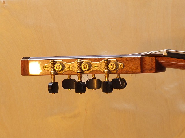

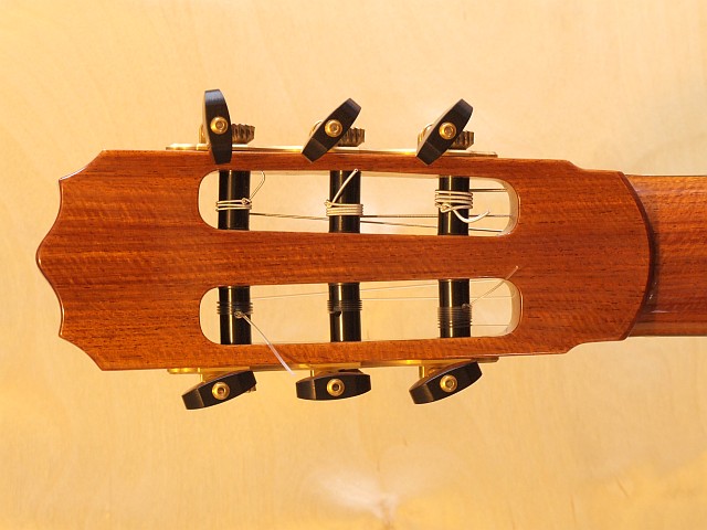

It seems that you increased the distance of the tuning machines from the nut, similarly (but not the same way) as on your not slotted headstocks. Is there a chance to see somewhere a picture from the side and/or back of this kind of "extended" slotted headstock? I couldn't find one on your web site or in The book.
These tuning machines look gorgeous. From which manufacturer are they? (No, I don't want to know what they cost! :lol: )

Pics of the headstock below, as requested.
Headstock back.jpg (72.93 KiB) Viewed 22297 times
Headstock side.jpg (64.67 KiB) Viewed 22297 times
The tuners are the Gotohs with the bearing on the end of the barrel. Really nice. Probably the best I've used.

Hi Trevor, thank you very much for the additional pictures. I can see now that you simply "moved the machines out of the way". A very neat solution, indeed. BTW, this is the first time I consciously see a classical headstock with a total thickness apparently greater than 20mm (just like on my first charango).
I was not aware of the existence of the premium Gotohs with this plate shape! How do these (slightly thicker) end-brearings of the rollers go into the holes? Did you have to get a 10.2mm drill bit to make or enlarge the holes?

The end bearings of the Gotohs have what looks like an 'O' ring on them, presumably to ensure a tight fit. I just used a 13/32" drill (pretty much standard practice) which converts to 10.3mm and that is pretty much exactly what you need (and what fits my shop-made drilling jig). No need for stepped holes or anything.

Trevor, love the Rosette.
I've always loved that style of tile, but can't quite visualize how to replicate (not that I want to copy you :wink: ). Do you have a quick description of your process?
Thanks,
Trevor Gore
Posts: 1643
Re: A couple of classicals
Post by Trevor Gore » Tue Oct 23, 2012 1:20 pm
It's just planks and logs like traditional mosaic rosettes, but you don't need to reduce it all to the minimal square section of the smallest thickness. As ever, it's keeping everything in register whilst gluing that's the hard bit, but you can use perspex "moulds" to help you there.
I've seen some pictures of similar rosettes where the zig-zag shows a slight skew, which indicates to me that the pieces were glued up as a sort of spiral which wasn't quite under control. I would imagine it's pretty hard to do it that way, hence the planks and logs approach.
