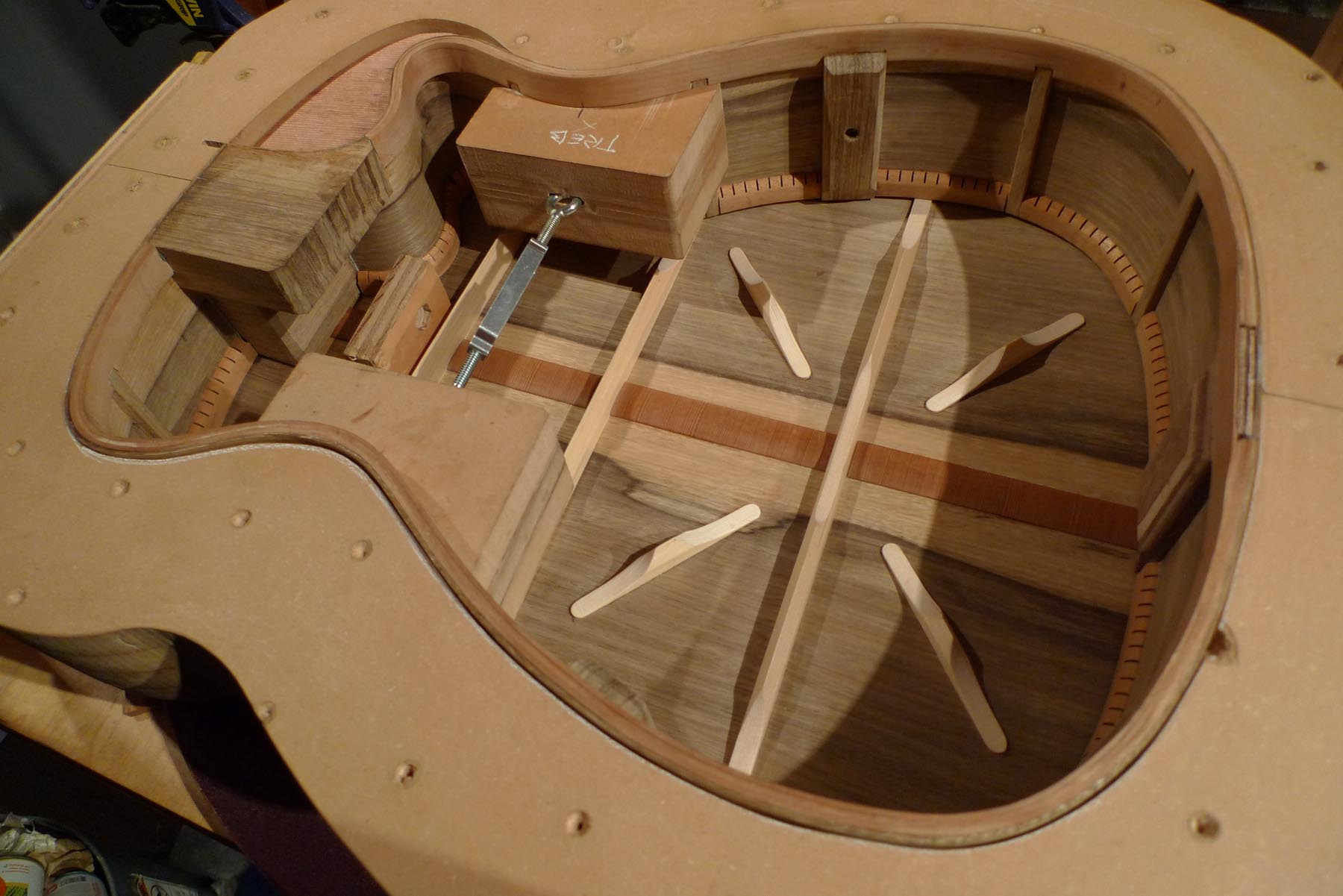

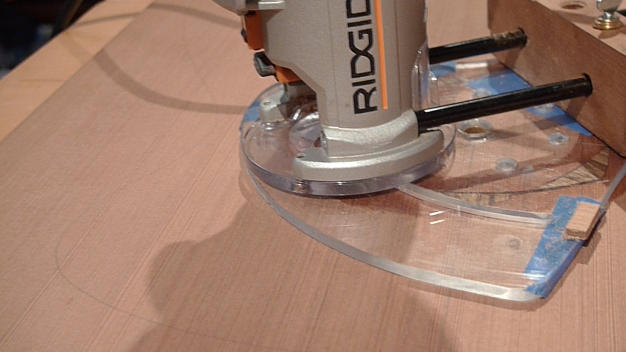

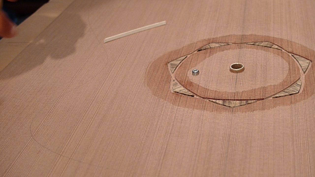

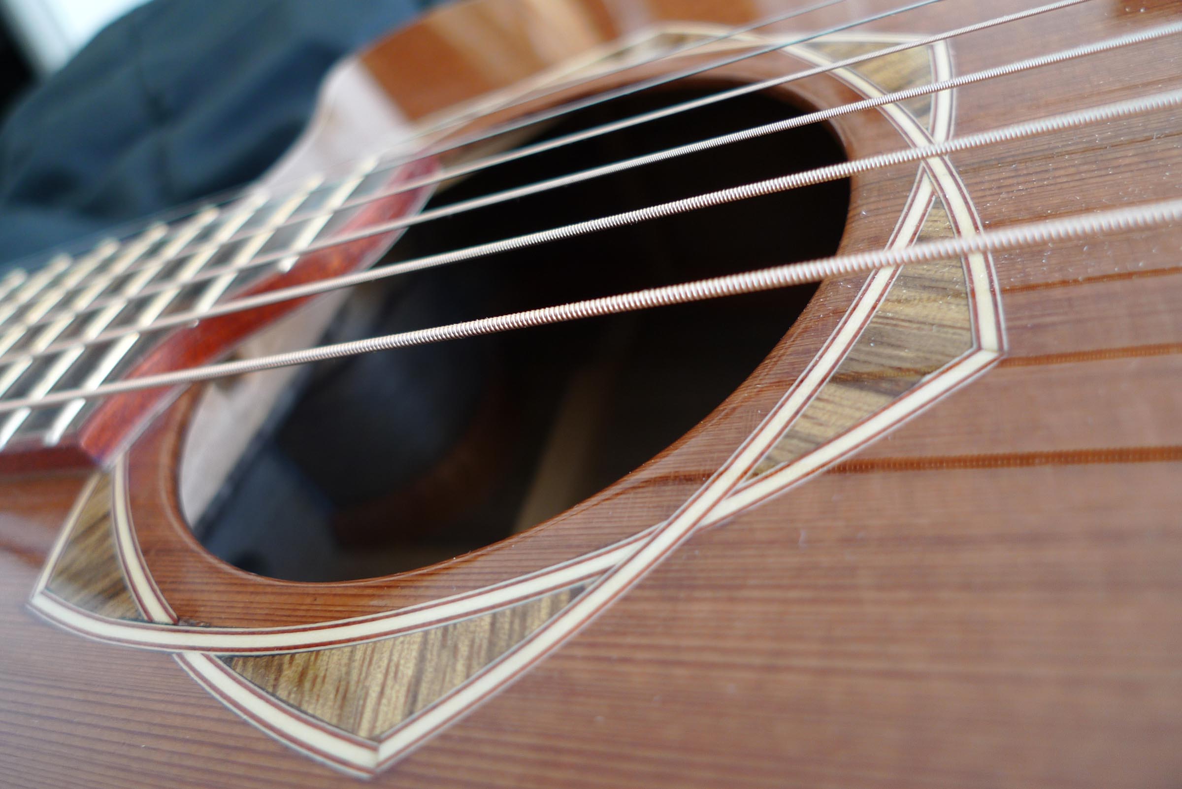

I milled all blood wood binding and holly purfling . The rosette was all wood and included some nice figured Limba

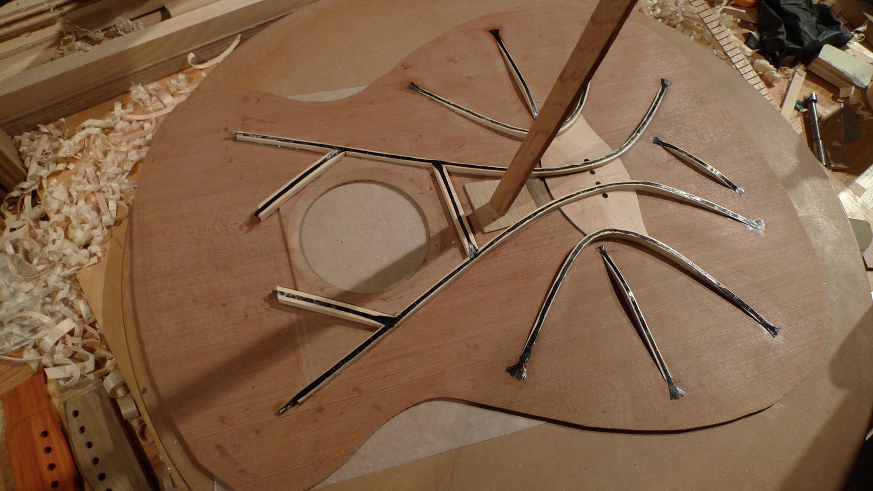

Live back design. Spruce bracing redwood marriage strip.
Falcate bracing was fun to make. We don’t have king billy here. I got some Alaskan Yellow cedar for the braces. It bent nice but was heavier than spruce and not as strong . I bent and laminated the bracing out of spruce . No problem bending.
Bridge plate was made from VG rock maple laid over carbon fiber. I trimmed the braces to spec for king billy, even though I had a feeling I should have taken more off. I guess when you don’t do the math or follow your intuition you open your self up for a lesson.
Top bracing glue up had to be done in stages with epoxy dry time in-between. Took days to complete the top.

Looks awesome, love the headstock and rosette. I got Trevor and Gerards' book a couple of weeks back and intend on making the same guitar, hope it turns out as great as yours does.
Col

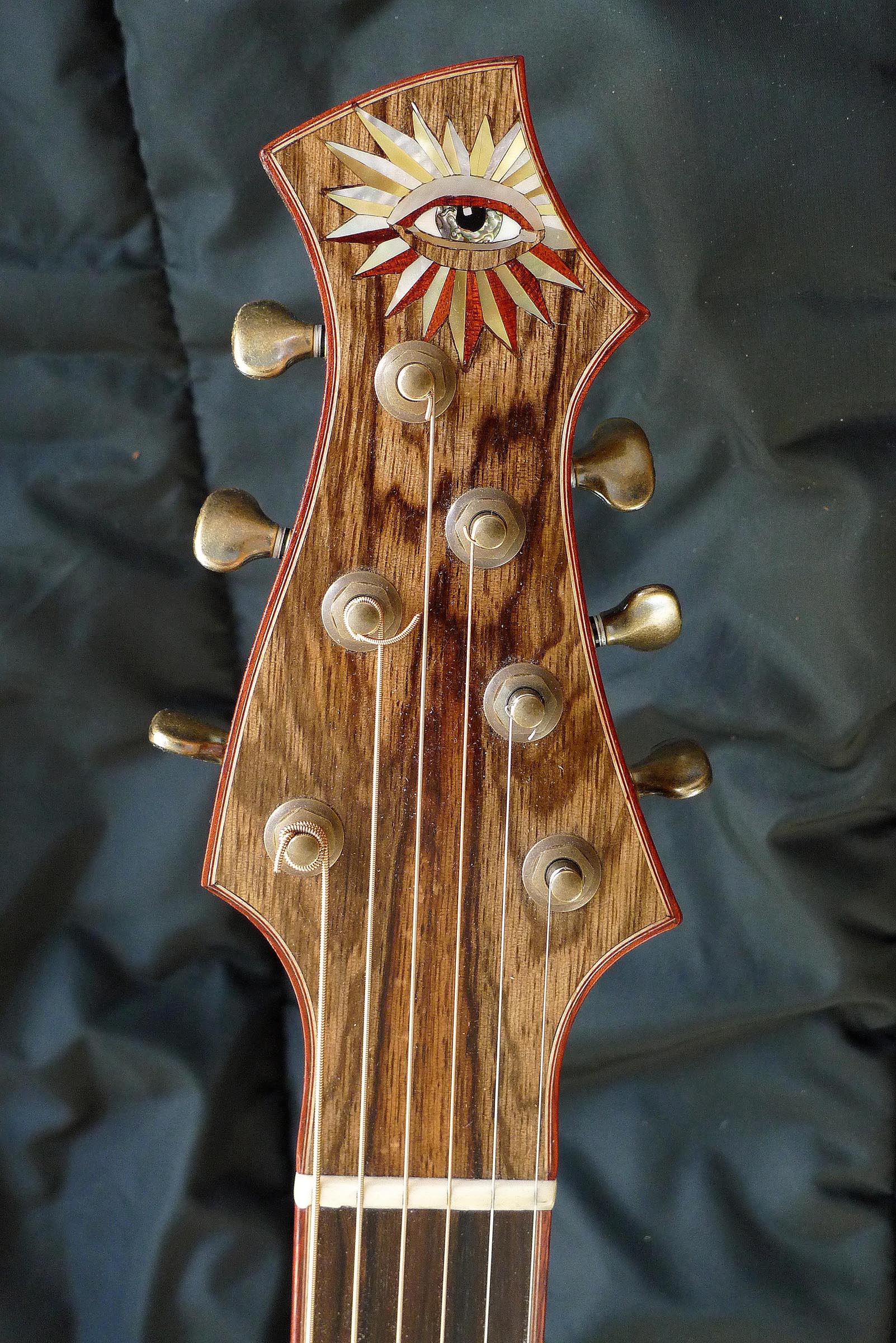

Got any more close ups of the headstock and finished rosette? Did you go with the compensated nut as well, I cant tell from the photo?
Col
Col

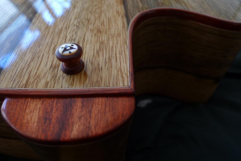

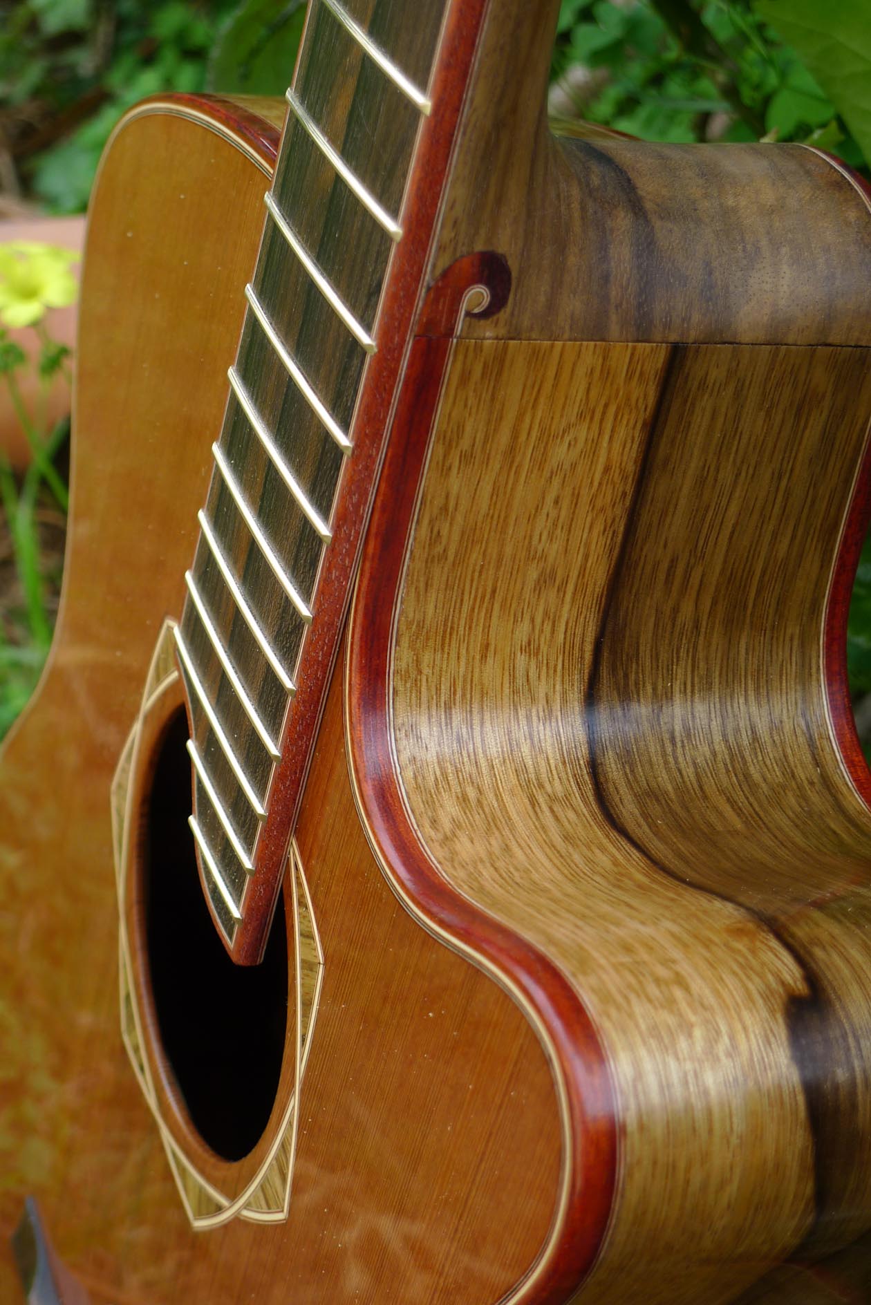

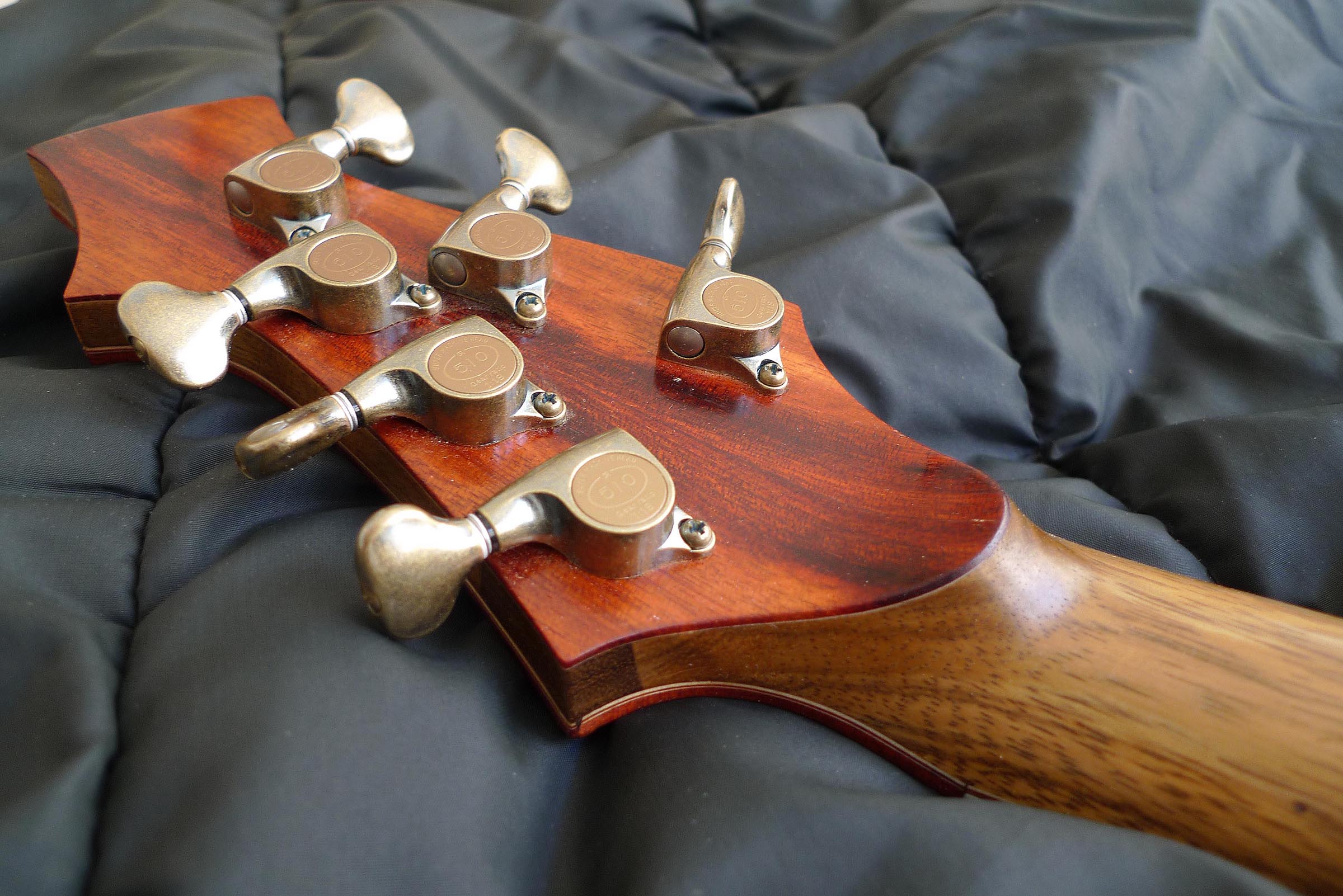

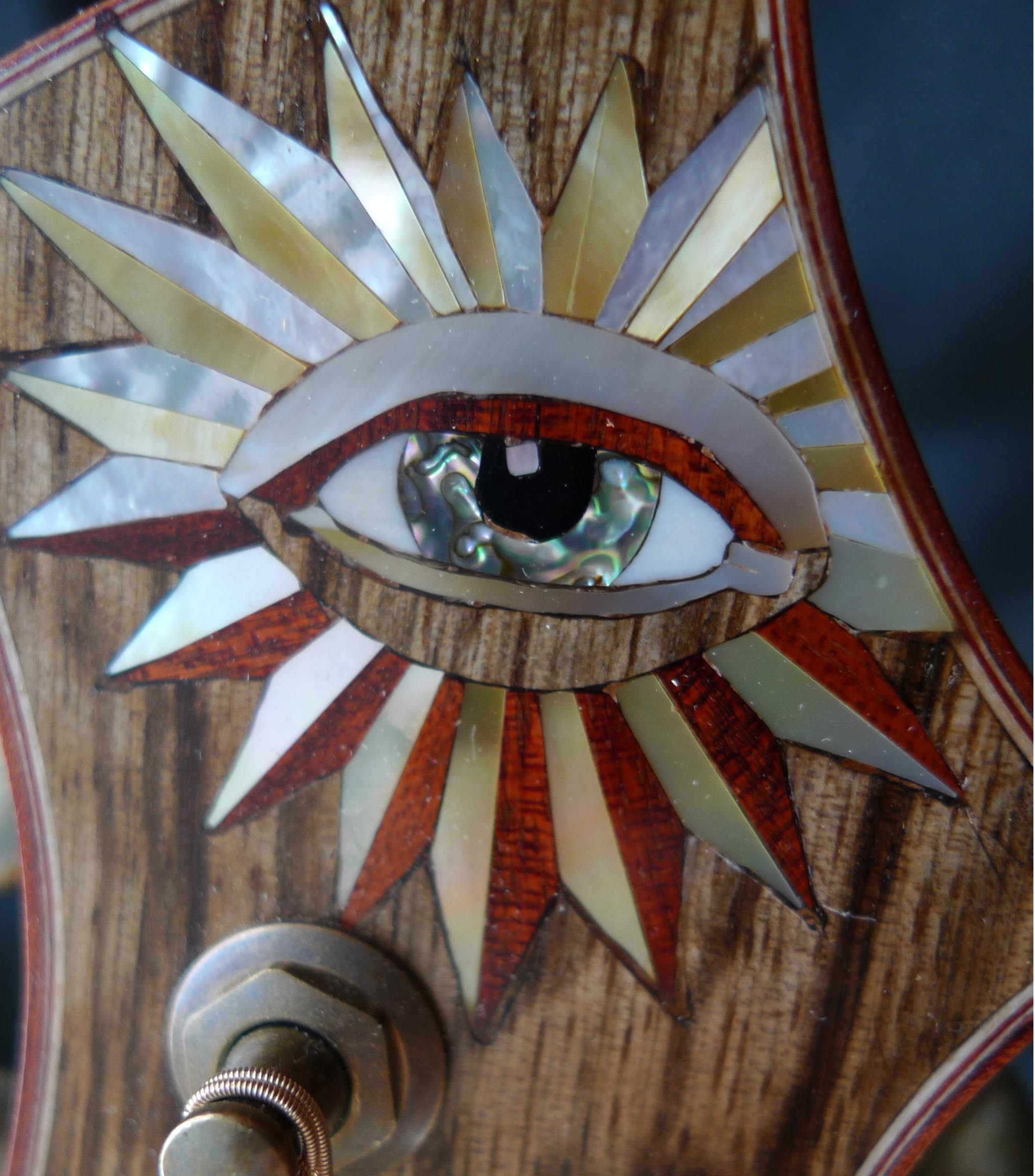

There was a lot of broken blood wood before I got the hang of it. Seems you got about a 10 degr. F window somewhere around 250 for bending. It has to be hot all the way through. Guess that’s why you use a machine. A little Super Soft goes a long way.
Bolt on bolt off neck. Zercote, finger board.
Head stock top laminate a high figure Black limba, Headstock back laminate Blood wood. Bound and perf’ed.
The Eye of creation is looking out through over 50 pieces of shell.

Yes thanks for the interest. I did compensate the nut. I believe it helps.

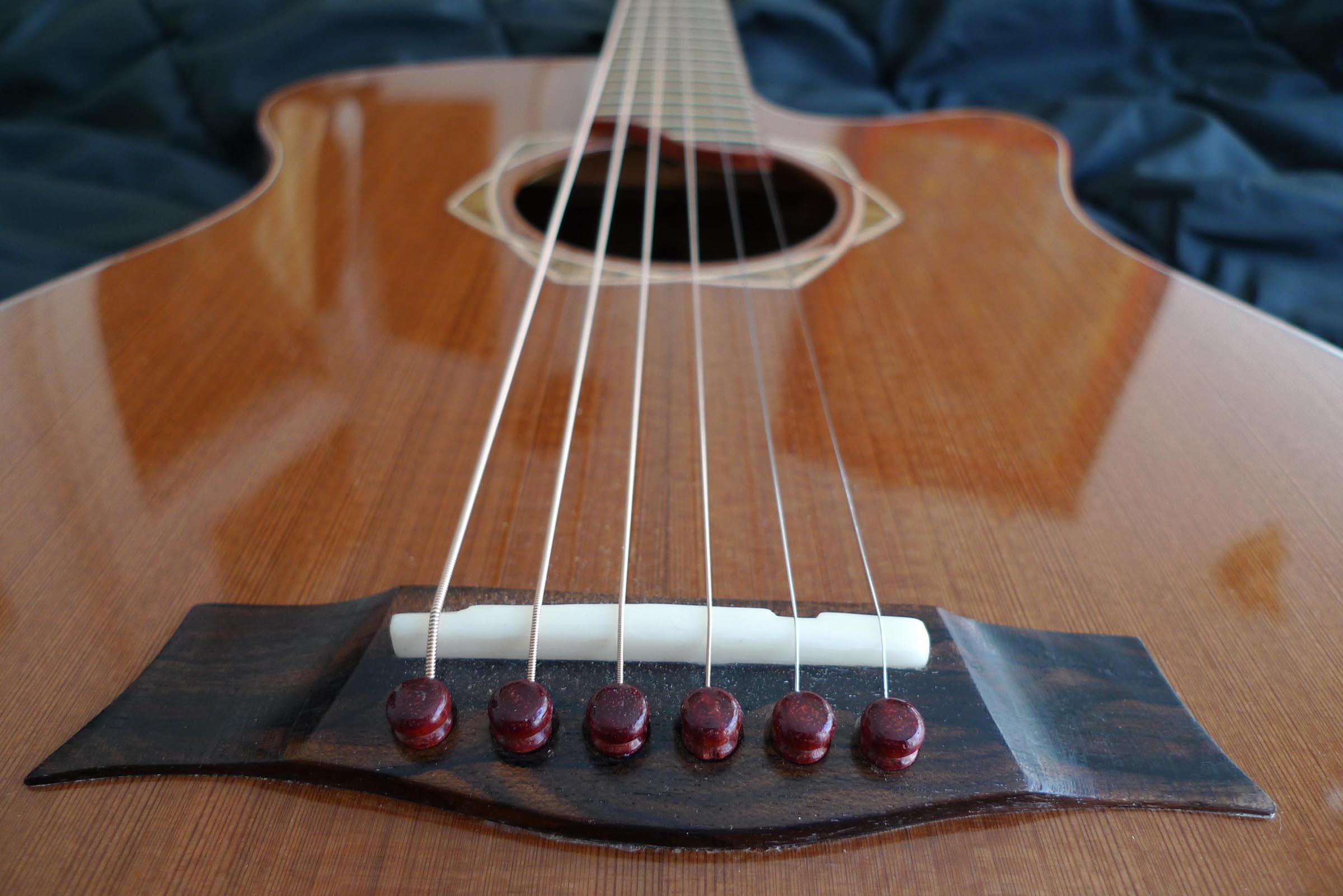

Finish is French polish shellac. I love the process, the feel the smell the look. Use grain alcohol, it’s nicer.
I made three different carbon fiber reinforced bridges. Black limba, Paduk, and Zericote. Black limba was the lightest, but the ugliest. Didn’t seem strong enough even with the carbon fiber. The paduk weighed about 16 grams had the best tap tone and the color mached the blood wood now but I didn’t like the fact that it would change later on. The zercote matched the fret board and was a real looker. It weighed in at 18 grams. Vanity prevails.

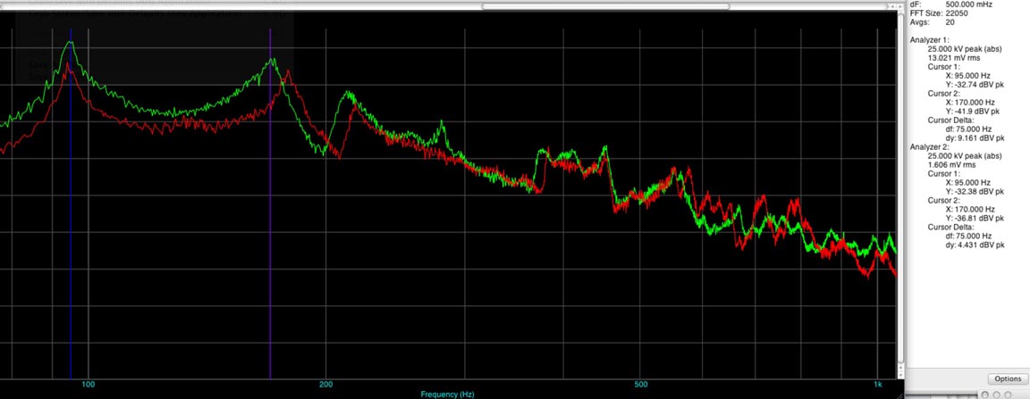

I was hoping to tune the box to 90, 170, 214 .

The jpg in the previous post shows the finished guitar with about 400 gm of mass loading compared to the (green) non loaded guitar. 94.5 170 214 I think I missed my target of 90 because I didn't compensate for the extra strength of the spruce bracing compared to the King billy. I also fell short of my target for bridge rotation.
I had everythink tuned and nailed down nice and stable at 90 170 214 and then I installed K&K pick up that brought everything down a bit. I removed some mass and ended up with what you see above.

Frank

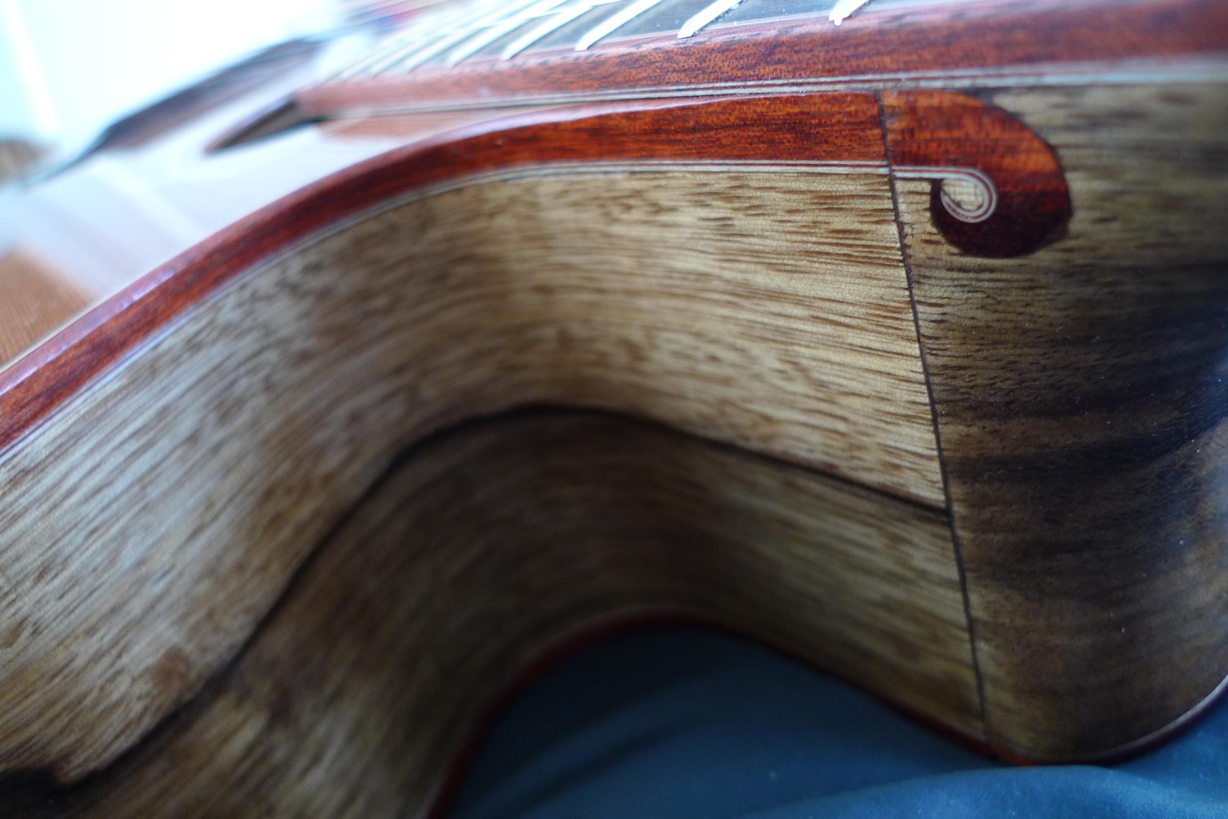

Great attention to detail, I do like the way you finished the binding with the swirl, very clever. I can see how it would bug you if it didn't some how flow into the heel.
Col

Yeah, as Col says, I like the rosette and the littel curl on the bindings. Gives a finish to an area I've been thinking about......
I will say I'm not too fussed on the headstock, but that's the asthetic that jars a bit with me. The workmanship is very nice.....

Some very nice details going on thre, absolutely love the sound hole and the eye inlay. Excellent work
