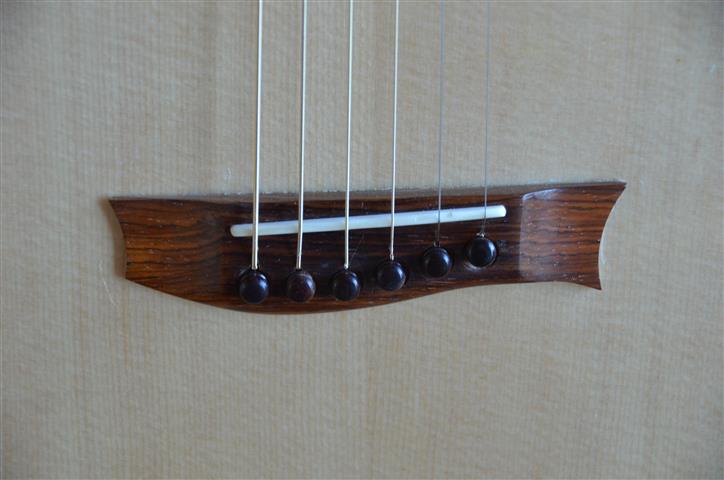

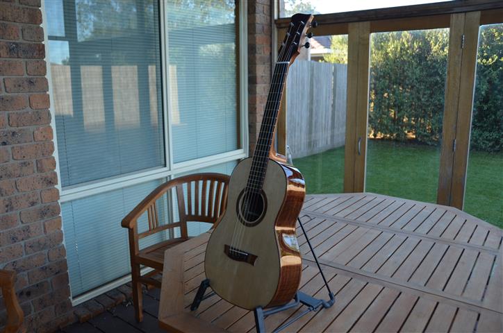

Post by Bob Connor » Sun Mar 03, 2013 7:03 pm

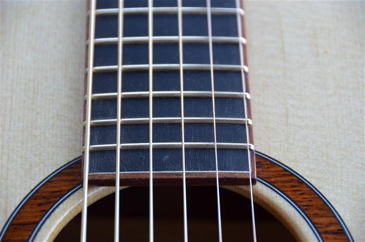

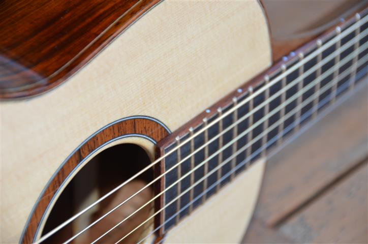

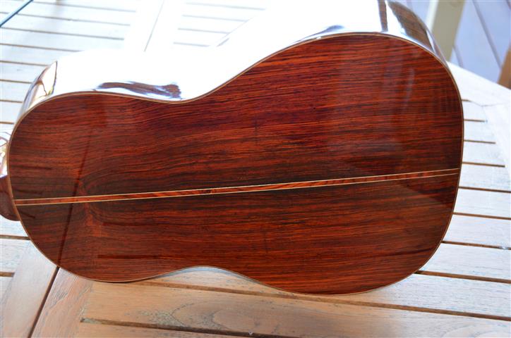

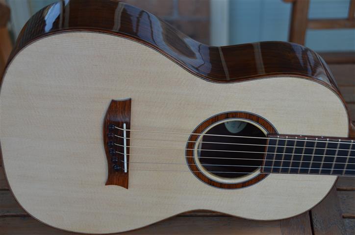

This Terz was the result of a stuff up when I cut the back too small for the O model that appears a bit further down the page. Luckily the colour was pretty similar so the undersized back was destined to become a Terz.
The top is one of Shane Neifers "paint grade" Lutz Spruce tops which cost about 10 bucks landed. (I bought about 20 of these and I reckon I'll use every set as a smaller instrument top)
The Cocobolo is from Bob Cefalu at RCTonewoods.
These are remarkable little instruments very loud but still sweet sounding and I can't help but break into "Down in the west Texas town of El Paso, I fell in love with a Mexican Girl", every time I pick it up. (Check Marty Robbins on Youtube)
I generally tune these up to the G because I think they sound crap when tuned down to normal tuning.
Anyhow here's the pics.

Bob
That's a beautiful looking little guitar.
I was playing a couple of tunes today in normal tuning, but with a capo on the third fret of my 12 fret 650 mm guitar. There's a nice chime with the right sort of piece: cowboy C and G can sound quite exotic.
Is that the Terz scale length (third fret of a 'normal' guitar)?

Wonderful balance of colours. Well done. What is the neck timber?
Re: Cocobolo Terz
Post by Bob Connor » Tue Mar 26, 2013 10:13 pm
It's Mahogany Gerry

Post by Bob Connor » Thu Apr 25, 2013 8:55 am
Missed a few of your questions. Sorry :oops:
The scale length I use is 24.9 but the first fret is the third fret (if that makes sense)
Strings are 53-12's. I guess you could use any gauge of string. Just depends on how you brace the top.
This one is standard Martin small guitar bracing. One tone bar and one finger brace per side.

That's a wee beauty, I love terz guitars, in fact I'm a sucker for all small bodied guitars LOL, I cant believe that is a paint grade top it looks great... :cl

The Cocobolo and the $10 Lutz top are a great match Bob!

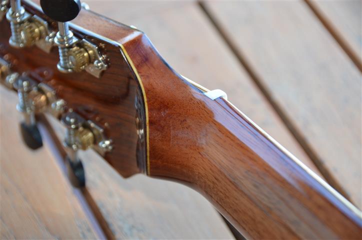

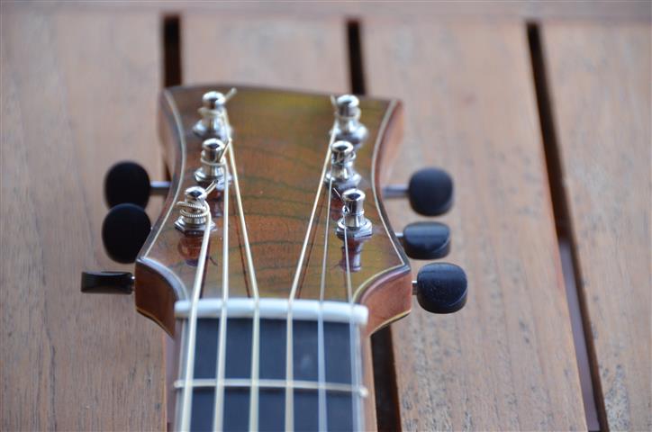

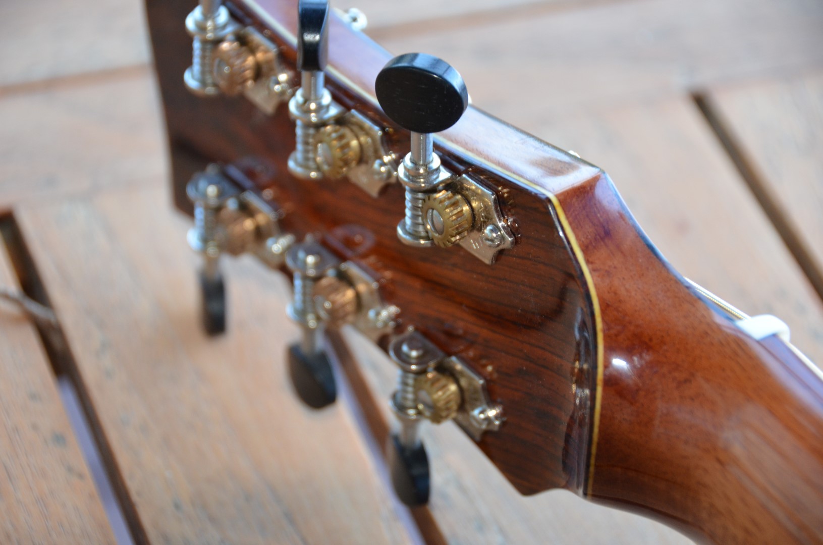

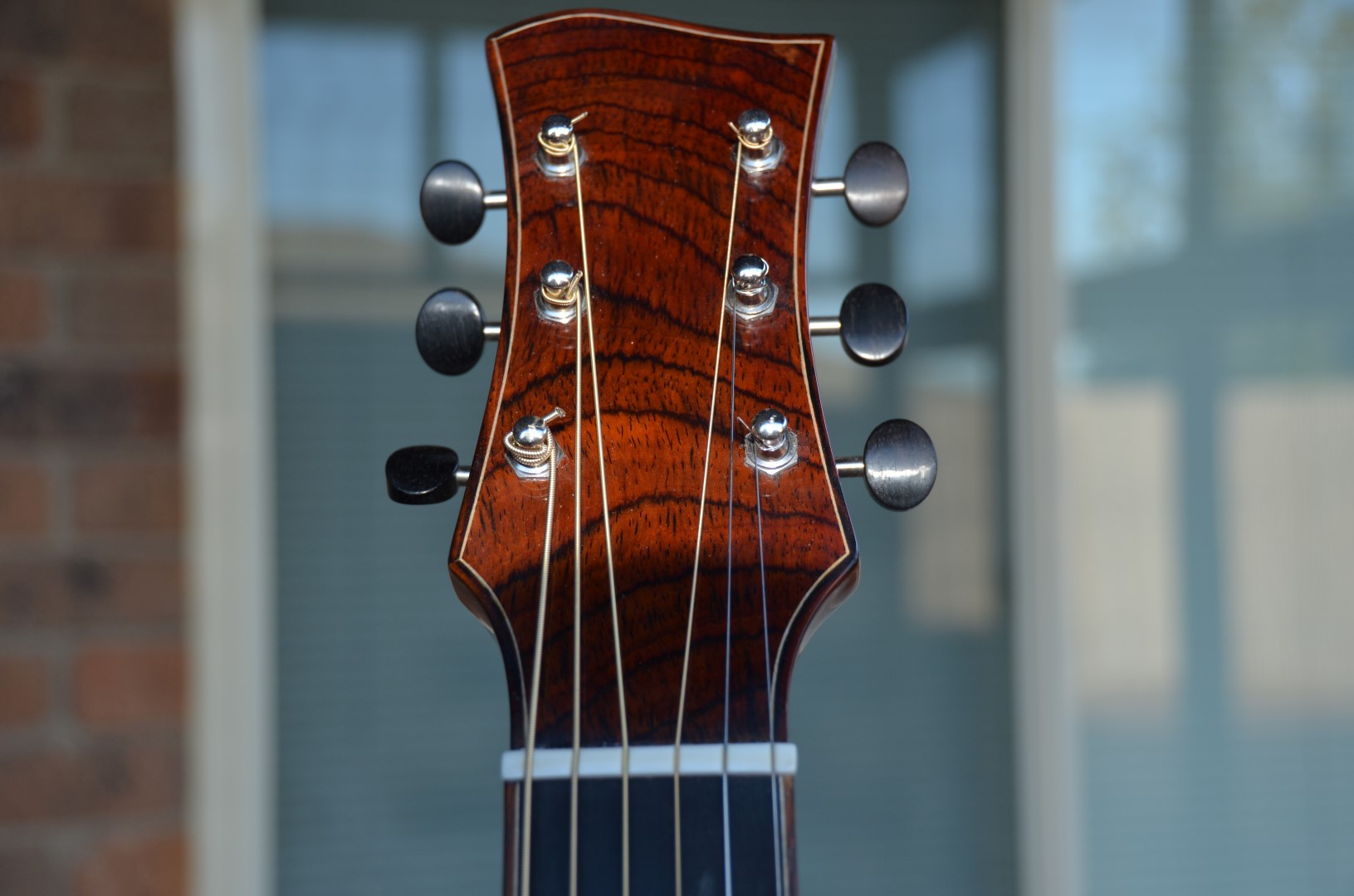

Is there any chance you could post a pic of the headstock Bob as it looks stunning from what I can see :)
All the best
Re: Cocobolo Terz
Post by Bob Connor » Sun Jul 14, 2013 7:48 pm
Thanks everyone.
Unfortunately I don't have the guitar any more so I can't take any pics of the headstock. The only ones I have aren't that flash but here they are anyhow.

That's attention to detail. you have set the bar higher with that effort Bob. Well done

Cheers Bob I'm glad I asked now as it is such a nice head veneer :)
I bet the owner is well chuffed with it :)
