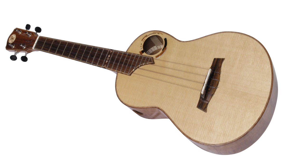

Why the modified hybrid you might ask?
Well, some background is required. The design criteria was for "something different" in visual design, bracing style and 'hopefully' tone. Kasha was put to me as a potential to meet those demands. And so this design started life as a Kasha instrument on paper/computer. However, I had reservations about the Kasha bracing without some experimental modifications or, as Eric Devine does, a bridge doctor in from the start. A bridge doctor solution did not appeal to me, so I played with the bracing. Long story short, in my mind, Falcate bracing provided the best 'fix' to what Kasha lacked. So it was that I had the discussion over Kasha vs Falcate. Falcate was accepted, but not until after the design had been drafted in Kasha style....

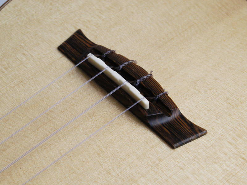

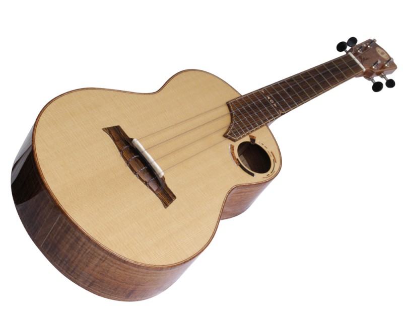

Born from that was a hybrid that needed to keep the drafted aesthetic, while encompassing the Falcate bracing system in so much as possible. My solution you'll see below. With the offset soundhole, I opened as much of the soundboard potential vibrating area as I could first, then heavily reinforced the upper bout. Well, if you're still with me, pictures say it best... :wink:
Specs as follows :

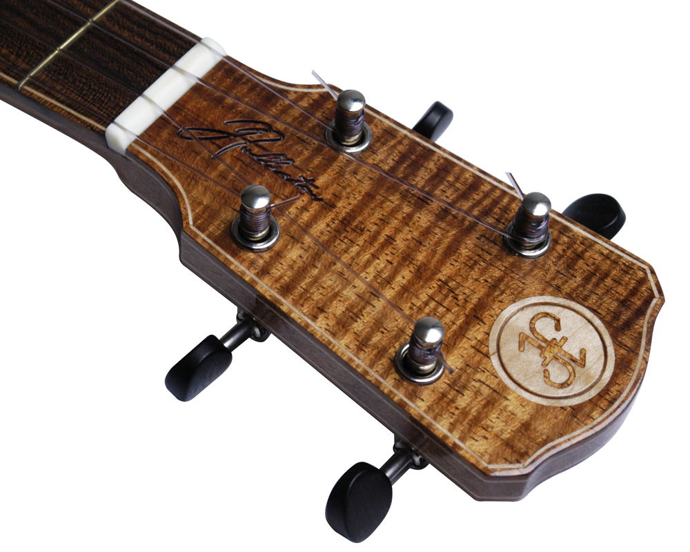

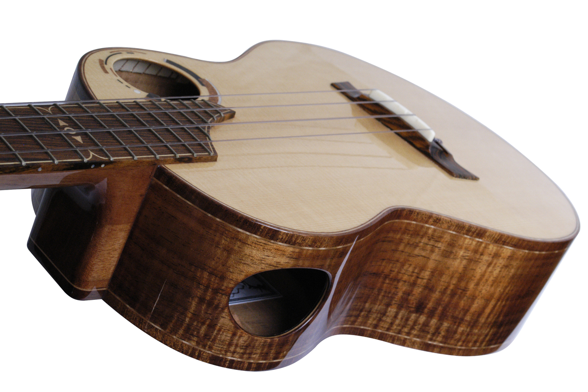

And some details...

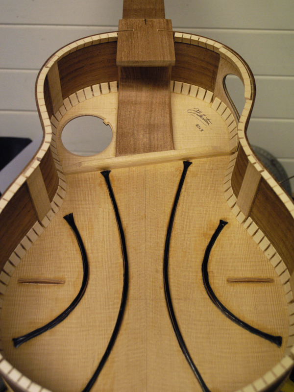

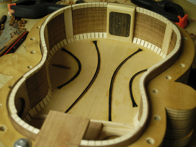

The inner workings...

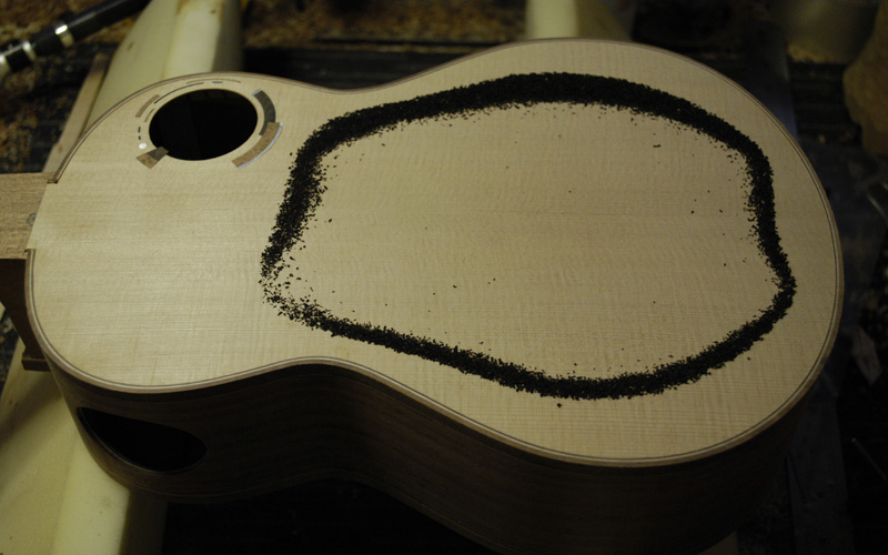

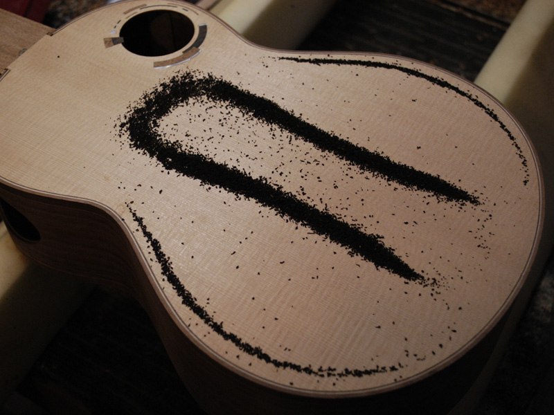

And some dancing tea leaves early on in the scheme of things, just for fun :D
(Sorry, no late tea leaves)
While I think there is always room for improvement and further experimentation, I was pleased with the resulting instruments tone for a first attempt.
Cheers and thanks for looking.

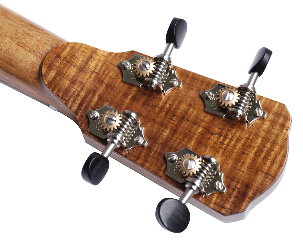

I'm assuming what looks like a heart-wrenching crack in Pic 3 is just a trick of the light?

Ha! No Dekka, reflections of light abound through those photos - no cracks. :wink: Hard to photograph very shiny things without reflections...

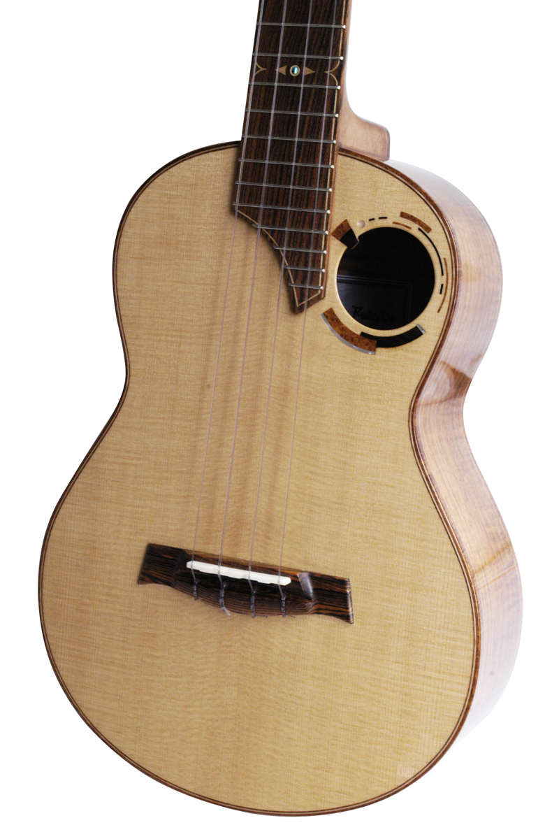

Very nice details as usual Jeremy. I quite like some of the elements in the rosette. Similar to mine and they give me some ideas to spice up future ones.

Yeah, rosettes have always been a favourite of mine to play with - different ideas, designs and techniques etc. I've done carved lattice, staggered, inlaid, tiled, mosaic... A little bit of room for improvisation and expression on a custom instrument imo. Though I've drawn several ideas like this over the past few years, this is the first opportunity I've had to implement one - it was fun. I was particularly inspired to try and work it into a design for a willing customer after seeing some of Michihiro Matsuda's work years ago. Probably the master of the style.
Yours are certainly suiting the 'whole' of your instruments - spice away. :wink:
