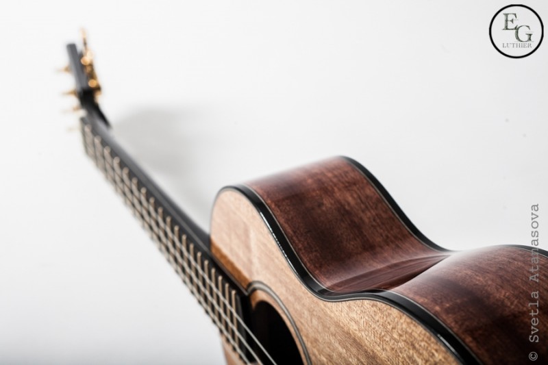

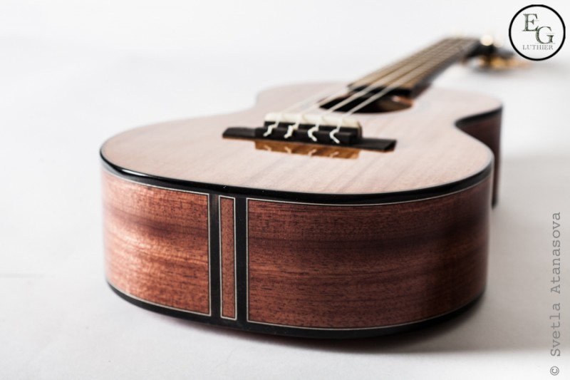

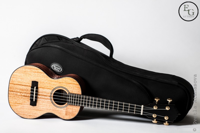

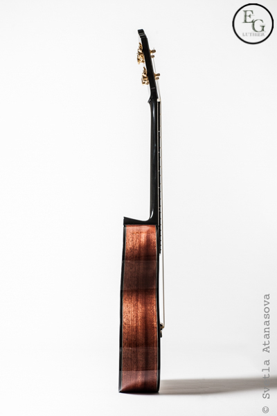

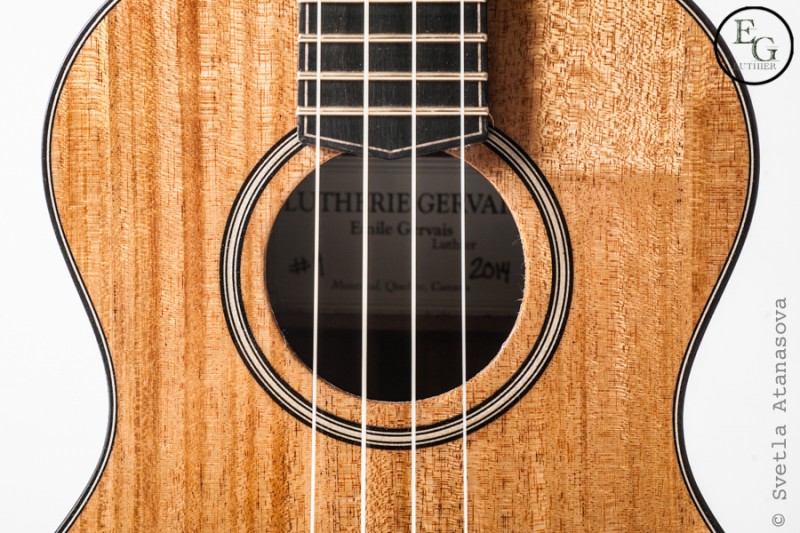

Hi folks,
Here is the first ukulele out from my shop. I am a guitar builder but I got this project from one of my customer, so had to jump on it.
It was a fun project and I will make one just for me after xmas.
Overall shape based on Kasha ukulele plan I got from Ultimate Guitar Plans, and let me say both plan from tenor shape they have are the exact same. So which one did I trust ? None but my pencil and mesurments.
Bracing pattern is mine, I won't show it, but 2 braces in the back and the top is based on my classical guitar model wich is base on Ramirez.
Top : American Mahogany, 4 pieces. (some left over from my neck blank, I made the best of it, couldn't scrap such quatersawn pieces)
B/S : Bubinga
Neck : Sapelli, black laquered
Fretboard : Ebony with Evogold fretwire
Bridge : Ebony
Mini Gotho 510 tuners
Pictures are copyrights so as my designs.
This Ukulele will go to New Zealand in few days. The owner going to travel over there and will bring it with him.
Thank you

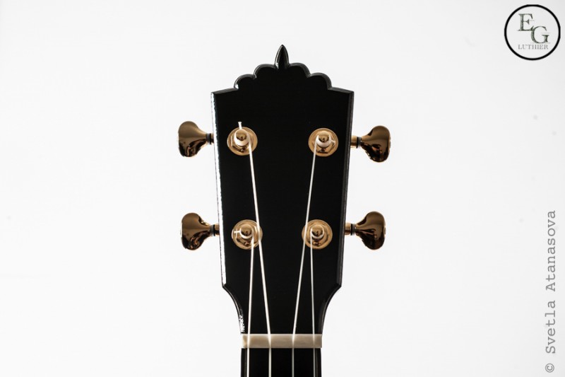

Post by DarwinStrings » Wed Jan 07, 2015 11:08 pm
I kinda like the black neck and that Somogyi styled headstock would be good for digging the bass player in the ribs when he nods off.
