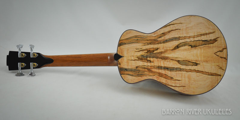

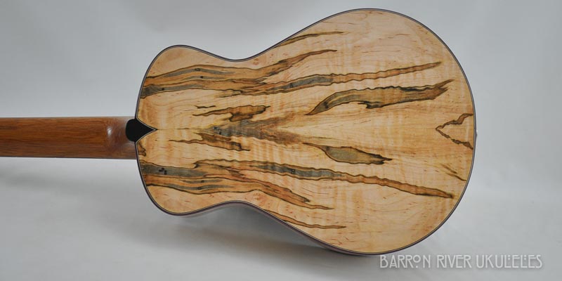

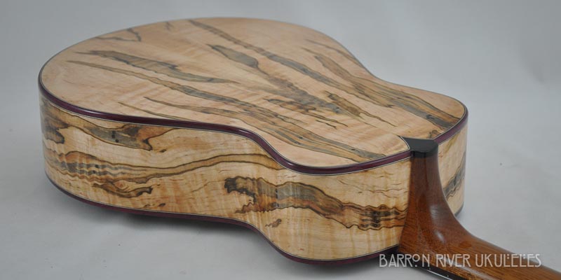

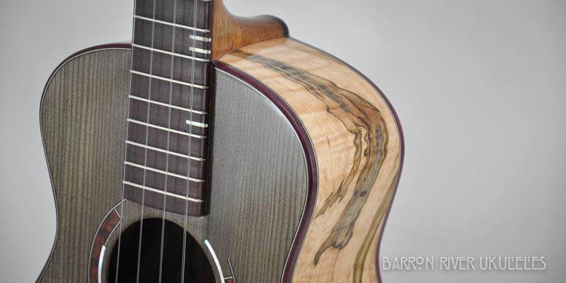

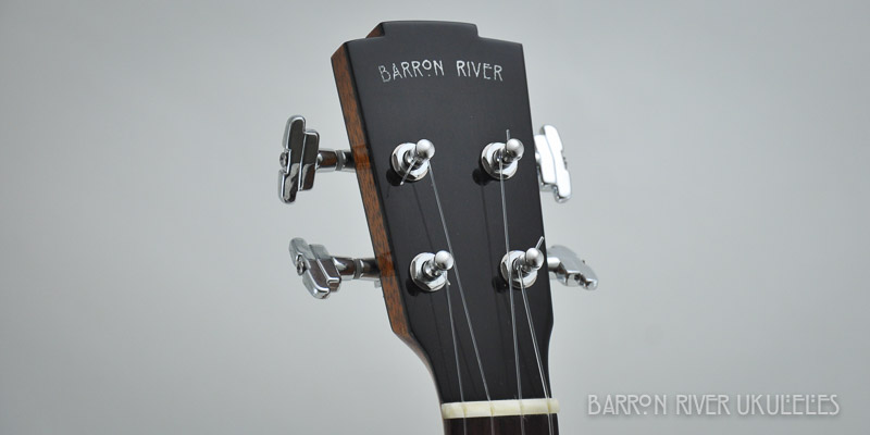

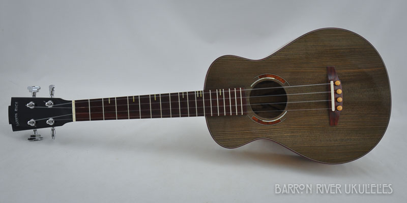

This one made from an orphan back set of the prettiest Ambrosia Maple I've ever seen. Just perfect to make a tenor from. Paired up with an Ancient Spruce soundboard. Ebony and Honduran Rosewood trim. Hipshot tuners and K&K Aloha twin pickup. And yes, it's a lefty.
