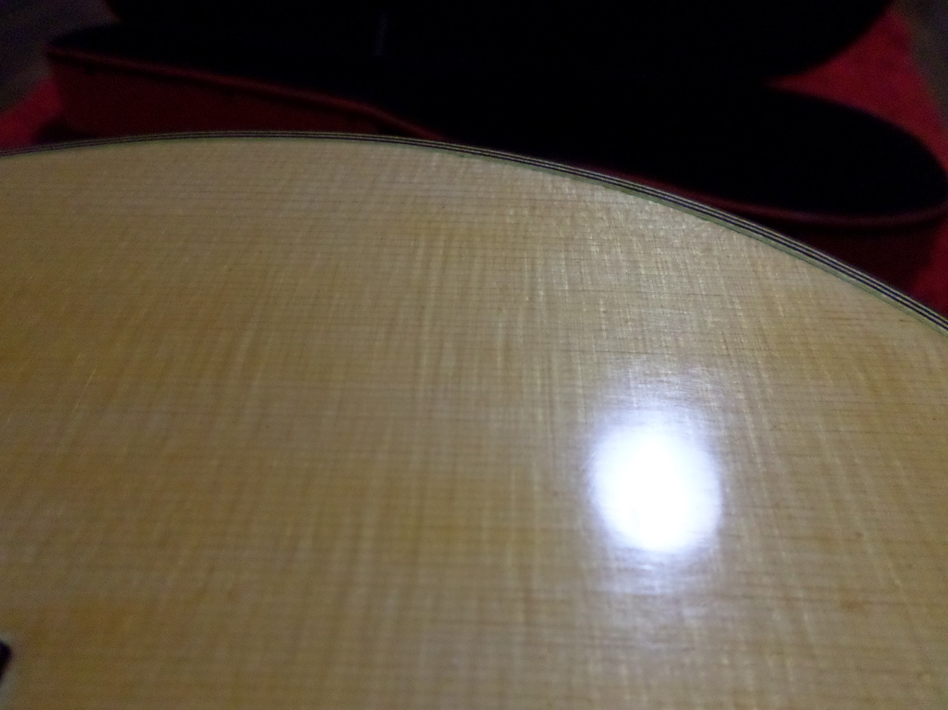

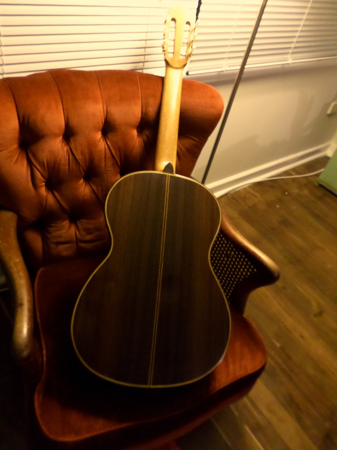

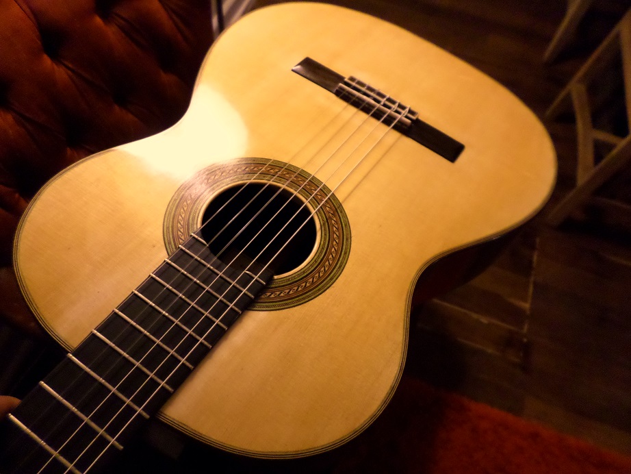

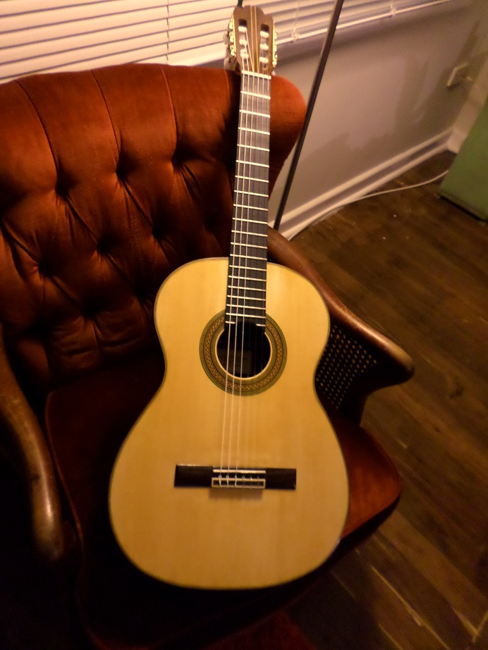

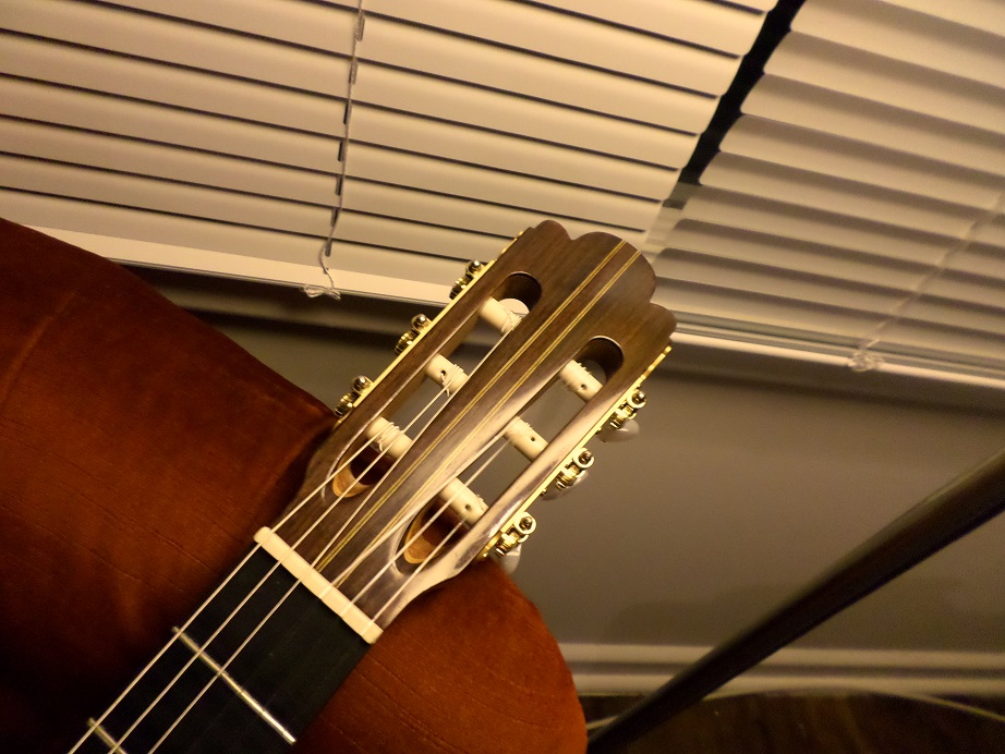

Hello,
i have recently finished my first guitar build, it was a one off project, but it came out sounding great, so i may build more.
Specs:
Soundboard: Spruce - Italian Alps. hand split master grade
Back and sides, and bridge, East Indian Rosewood, premium grade - 30 years dry
Neck-Spanish Cedar, Spanish heel design
Fretboard - African Ebony
Rosette - 1912 Ramirez replica (Segovia's guitar) - purchased from Germany
Finish: French polish - Shellac, with gums sandarac, benzoin and mastic.
Soundboard strutting - 7 low profile fan braces, no bridge plate.
Body Resonance - G
Interval between back pitch and soundboard pitch - Major 3rd
Scale - 650mm
nut - 52mm
Both soundboard and back are domed in the traditional Spanish method
I am a guitar player first and formost, and i tried as many great guitars i could before starting my project, including inspecting their bracing and wood thicknessing, and listening to their tap tones.
The guitar has come out better then i expect, but about as good as i wanted. It is a very light guitar, but loud and project, bright, clear and very warm and sweet :). great basses. it is incredibly open from day 1.
Soundsample, recorded with a voice recorded - guitar is compared to one of Richard Howell's best, a 2002 Spruce/Brazillian, MY GUITAR is the 2nd guitar in the sample:
https://www.dropbox.com/s/q2c7uci2ypz3g ... t.mp3?dl=0

Yep that's a first class effort for a first build...nice work.
Looks like a good job on the French polishing.....excellent!
