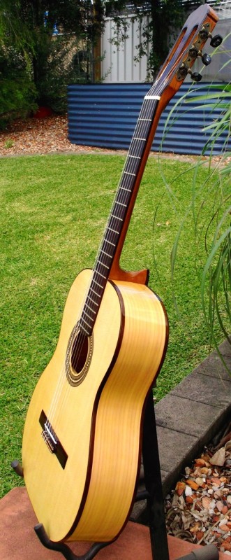

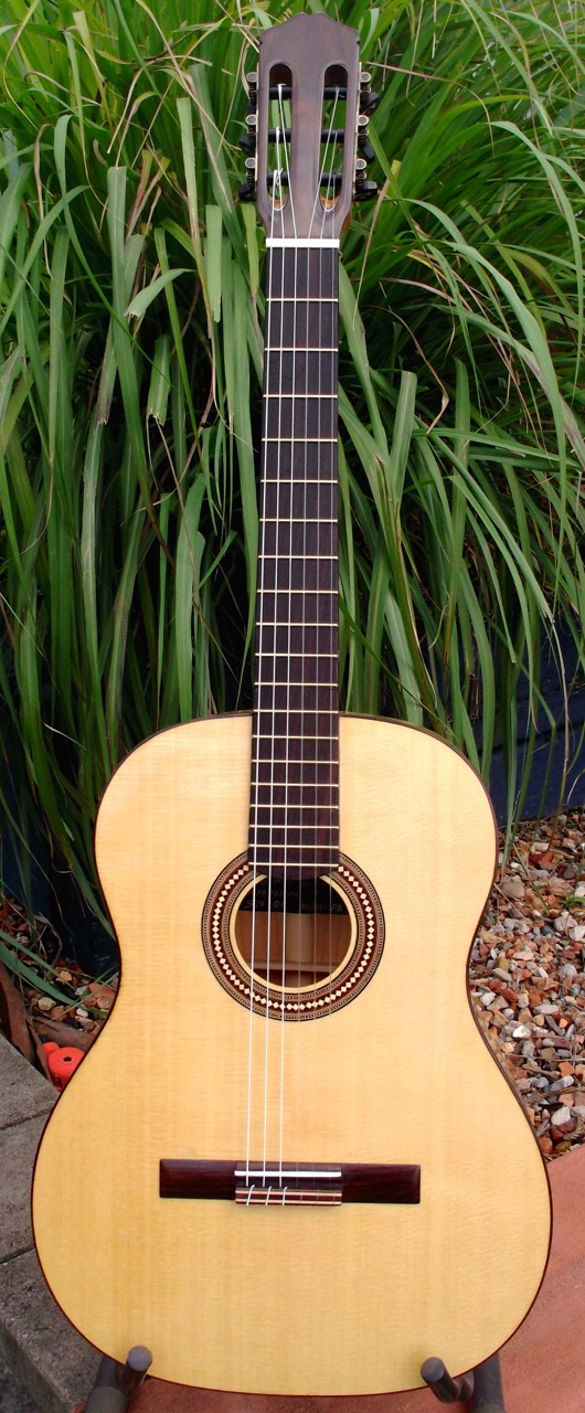

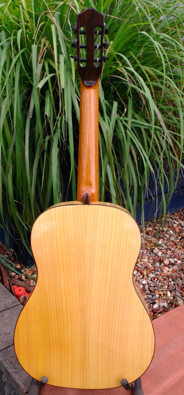

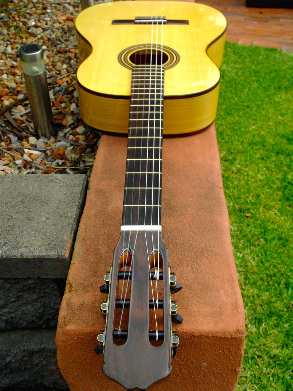

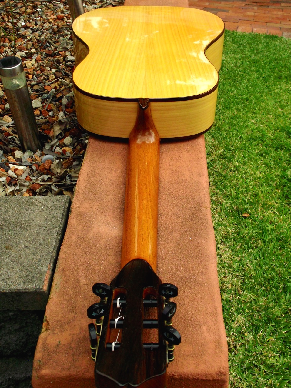

Hi All,
My first attempt at a Flamenco , sounds good, not quite as bitey as I had hoped , but loud enough and with enough attack to Pass for a Flamenco.
Top is Lutz ( High Mountain)
B&S are Cypress ( Tim )
Trims and Fretboard are all EIR
Neck is Spanish Cedar (Tim)
Top is Finished with hard shellac
the rest is finished with Nitro
Paul.
Paul.
