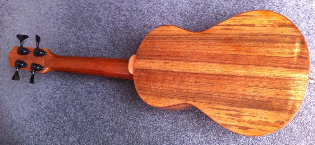

A friend of mine was unfortunate enough to have his Kala UBass run over by a 4WD. Fortunately it was in one of those nylon covered foam polystyrene cases. Unfortunately those NCFPC aren't designed to withstand 4WDs. Result: a collection of mahogany toothpicks with a few bits hanging off them.
I acquired the remnants for the price of a small donation towards a replacement UBass.

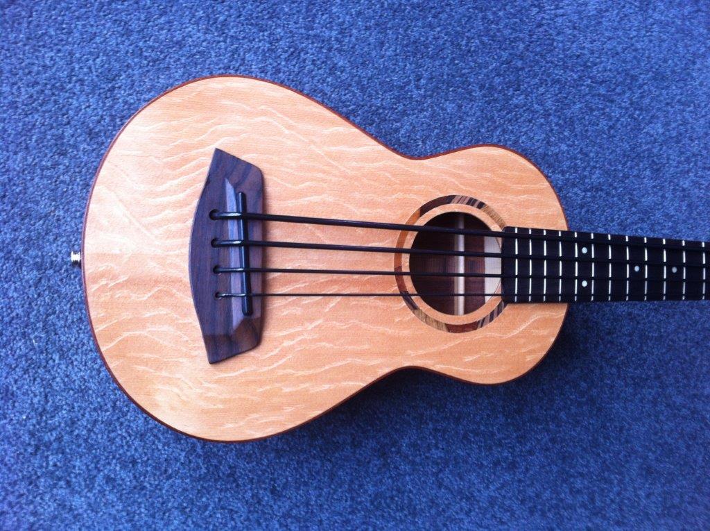

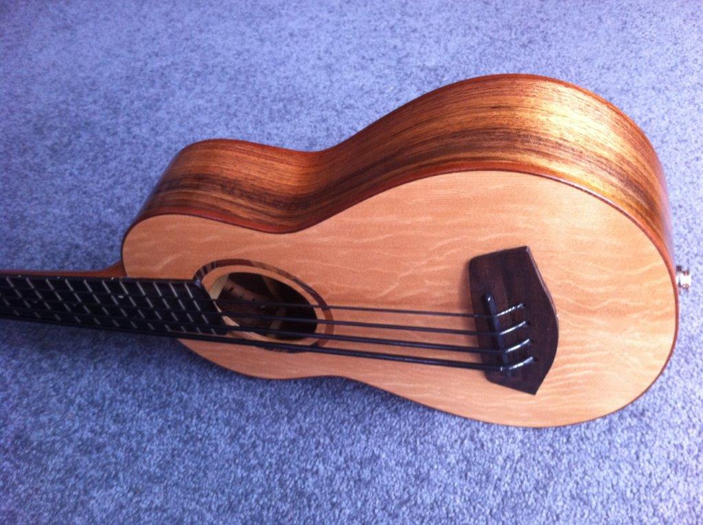

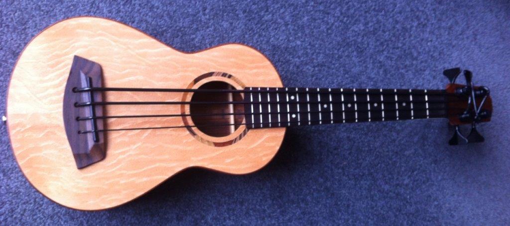

The only bits that were in any way able to be salvaged were the Hipshot tuners, the fretboard, the bridge, saddle and electrics. I have rebuilt the rest as a present for my wife.
Bearclaw sitka spruce top; NZ grown Tasmanian Blackwood; mahogany neck recycled from a dressing table my wife had when she was a kid, spruce X bracing copied from the UBass.
She's very happy with how it looks and sounds. I know where all the flaws are but I'm also quite content with this effort. I would say it sounds noticeably better than a Kala Ubass and almost as good as Allen McFarlane's first bass uke (which he made for my wife).

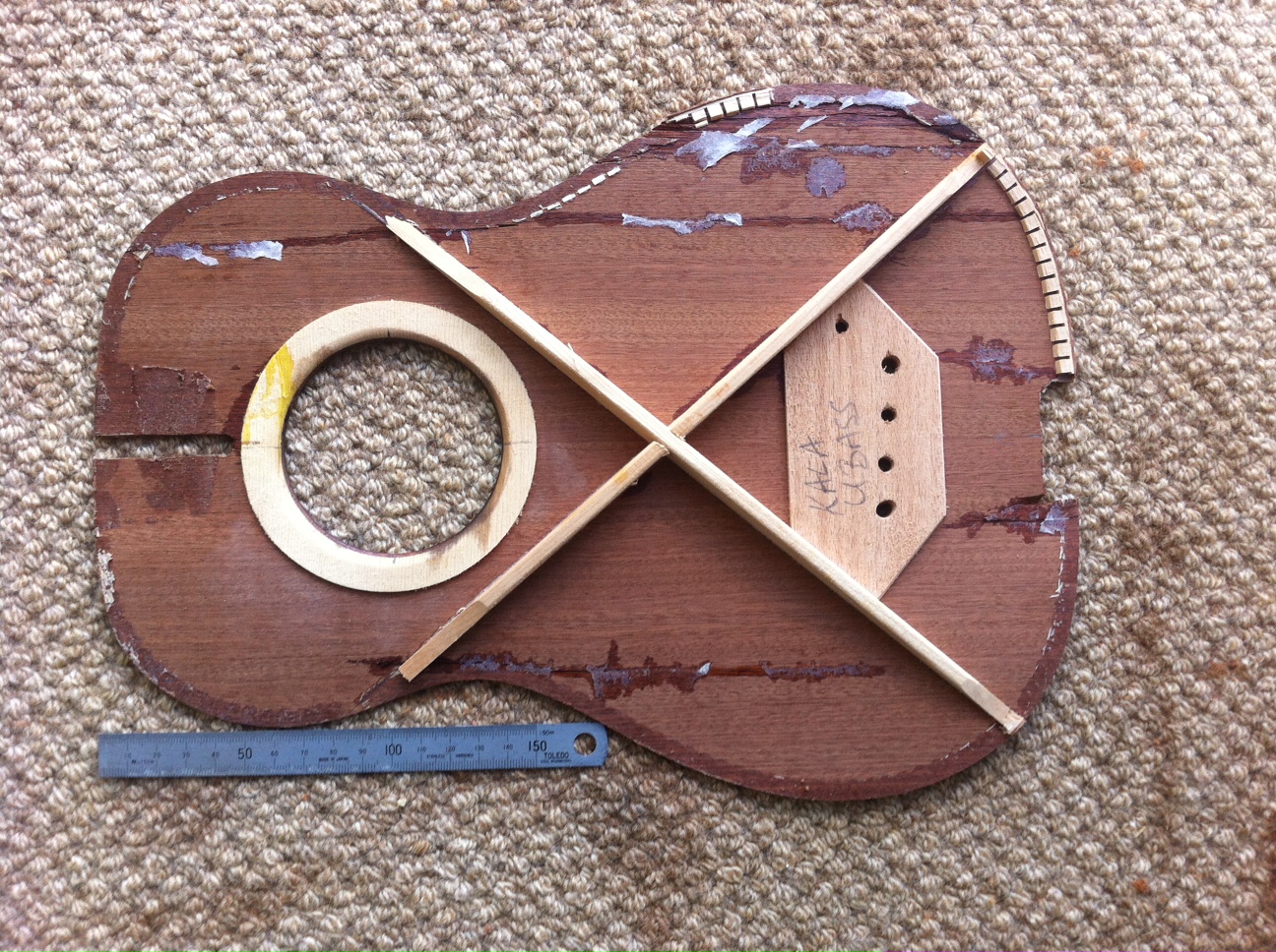

Miguel, that looks like a great project. Thanks for sharing. The story is entertaining and the woods you've used go well together (cool top!). I played one of these in a shop once and those strings feel nice, if quiet when unplugged. Do you have a photo of the x brace?

Wow, that is one crazy piece of bearclaw!
Nice job Miguel. :cl :cl :cl

Best Bearclaw I've seen to date, my small Bearclaw stash doesn't cut the mustard compared to that one.

Attached picture shows a reconstruction of the soundboard with braces attached. The Norman Gunston look with bits of paper still attached is because I glued all the toothpicks to a sheet of light card to get them aligned. The other side is a lot worse.
Braces are 6mm wide and about 15mm deep at the apex. The other dimensions you can figure out from the rule alongside.

Thanks for the photo, Miguel. :shock: It's interesting (for me) to see how a bass uke is braced.
