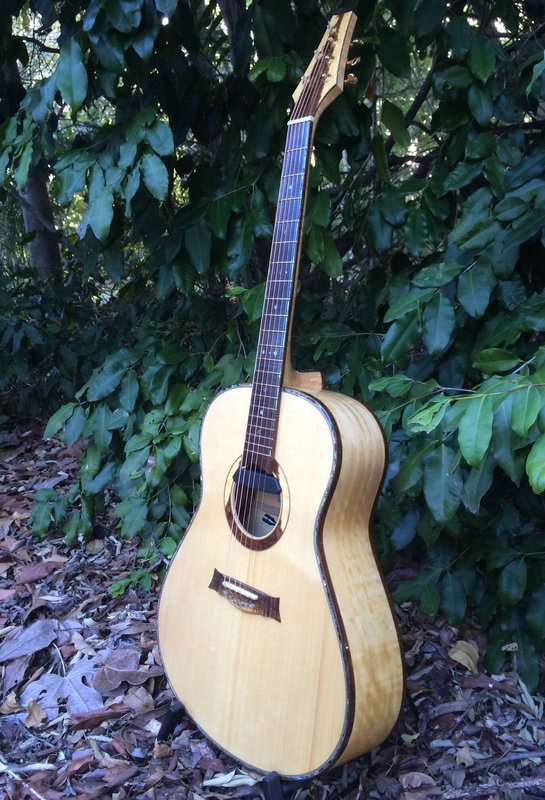

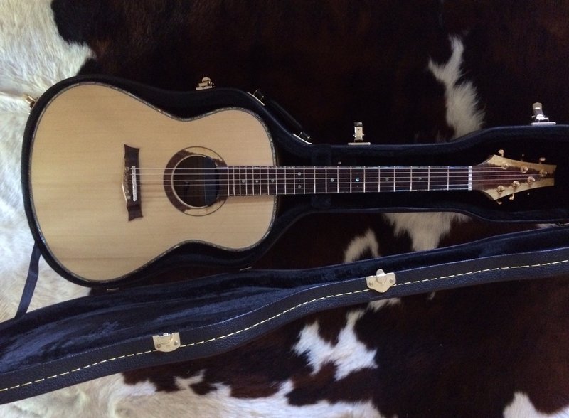

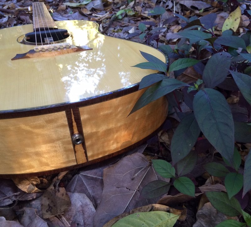

Post by Graham Long » Wed Jun 29, 2016 9:29 pm

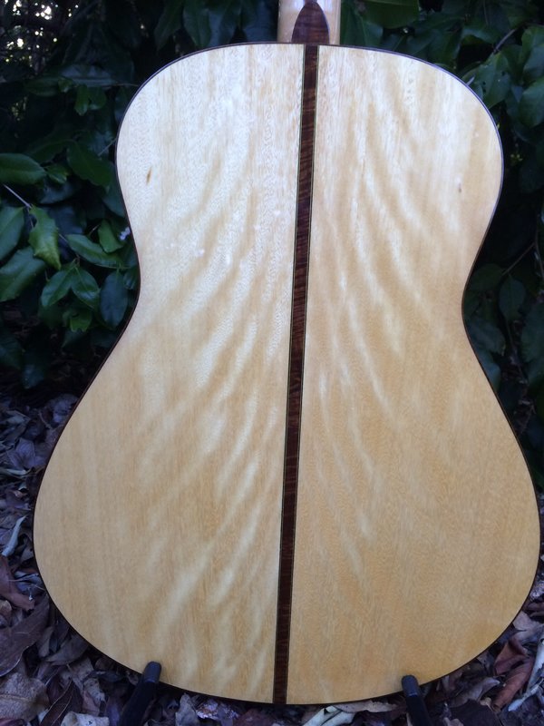

Back and Sides - Curly Avodire
Headstock, bindings, bridge - Ringed Gidgee
Neck - Curly American Maple with Ringed Gidgee Spine.
Soundboard - Adirondack Spruce.
CF reinforced Falcate Bracing.
Body and fretboard Purfling - Paua Shell
Curly Avodire, Ringed Gidgee backstrip
Bridge, Rosette and Heastock overlay cut from the same piece of Gidgee

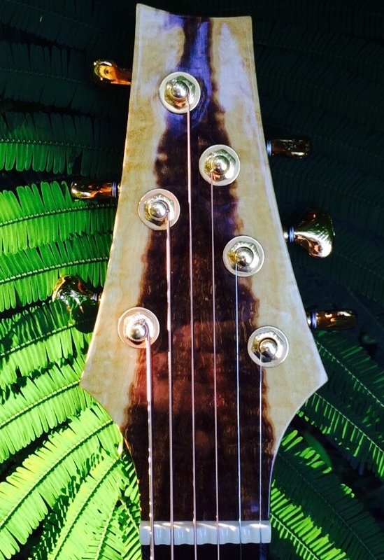

Ringed Gidgee Headstock overlay, Gotoh 510 Tuners
Adirondack Spruce Soundboard

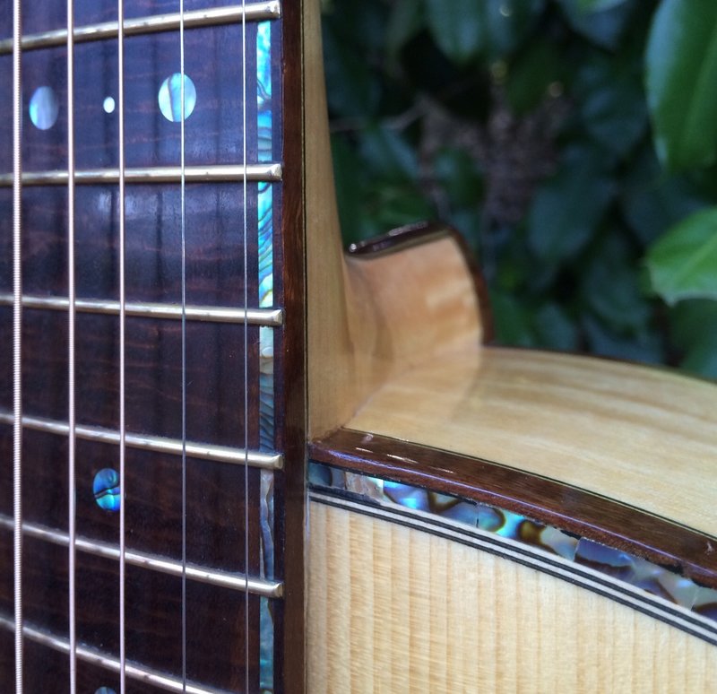

Ringed Gidgee Fretboard and Bindings, Paua Purflings
Ringed Gidgee Rosette
Nut and saddle - Mammoth Tusk
