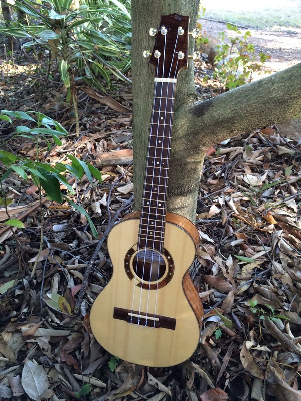

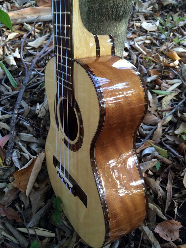

Post by Graham Long » Sat Jul 02, 2016 9:31 pm
Made this one last year, had the wood since 2009. Got enough for a few more.
New Zealand Ancient Kauri, unusual stuff to work with, cuts like craft wood.
Somewhere between 35,000 and 50,000 years old

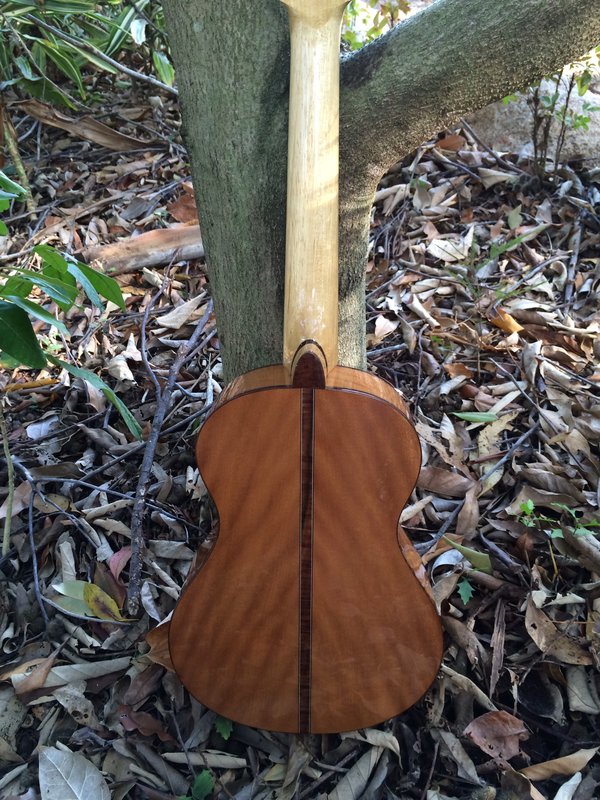

Ancient Kauri back & sides, ringed Gidgee backstrip
Koto Neck, Desert Oak Fetboard app& Bindings

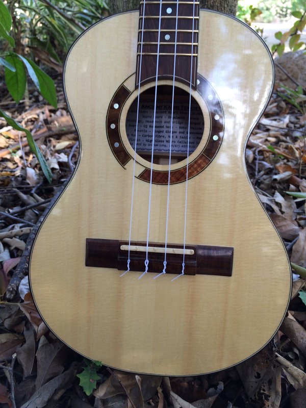

Ringed Gidgee & Sneezewood Rosette
Engelmann Spruce soundboard

How did you go with the Engelmann? I've only worked with it once and found that when I was removing tape it liked to peel back strips of wood with it, I was told afterwards to peel sideways to try avoid this. Guess I'll have to experiment.
Graham Long
Posts: 140
Re: Ancient Kauri Tenor
Post by Graham Long » Sun Jul 03, 2016 2:39 pm
Yep, have to be careful, I found the same thing with other spruces, not just Engelmann.
I found that a light coat of shellac helps prevent it, but you still have to be careful.

Is the black line in the heel an inlay or part of the lamination? There has to be scope for some decorative work round there for the more playful instruments.

The dark brown piece in the heel is a bit of desert oak, same as the heel cap.
